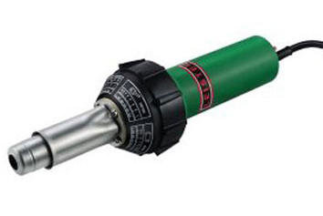

ABS contains polybutadiene which is a synthetic rubber, not actual rubber. Anyhow, while I am of course prepared to accept that a repair is unlikely to be as strong as an unbroken item, I do not believe it is for the reasons stated. I still say a good plastic weld, using a hot air gun, is going to give the best results. Received wisdom tells me thermosetting plastics can undergo a number of heat cycles before heat alone causes severe degradation. Secondly when plastic welding a virgin extruded ABS rod into a grooved crack, the area of the heat affected zone is much greater than the thickness of the material, ergo even though the boundary of the repair may not be as strong per mm, it is bonded over a much larger area.
