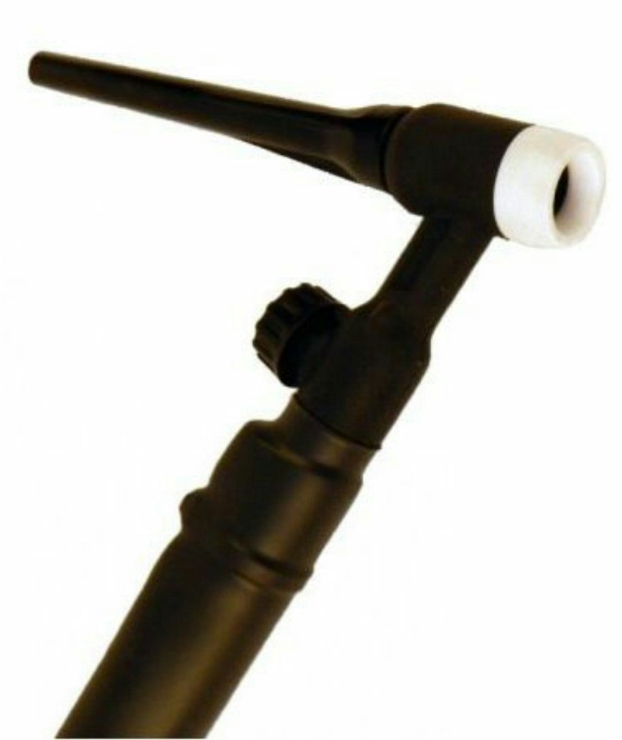

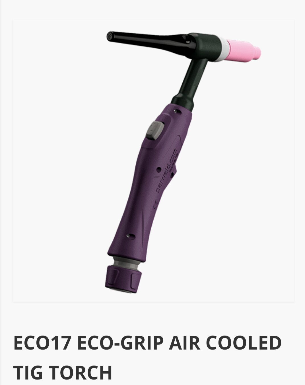

My XTS202 welder turned up today (Nice bit of kit) But the TIG torch doesn't seem to come with any consumables. Now before I go down the road of getting consumables for it. I noticed it doesn't have a trigger button. Would I be better off changing the torch before wasting my time or is this the only torch that works with this machine?
This is the Torch supplied:
Would I be better off with this version:

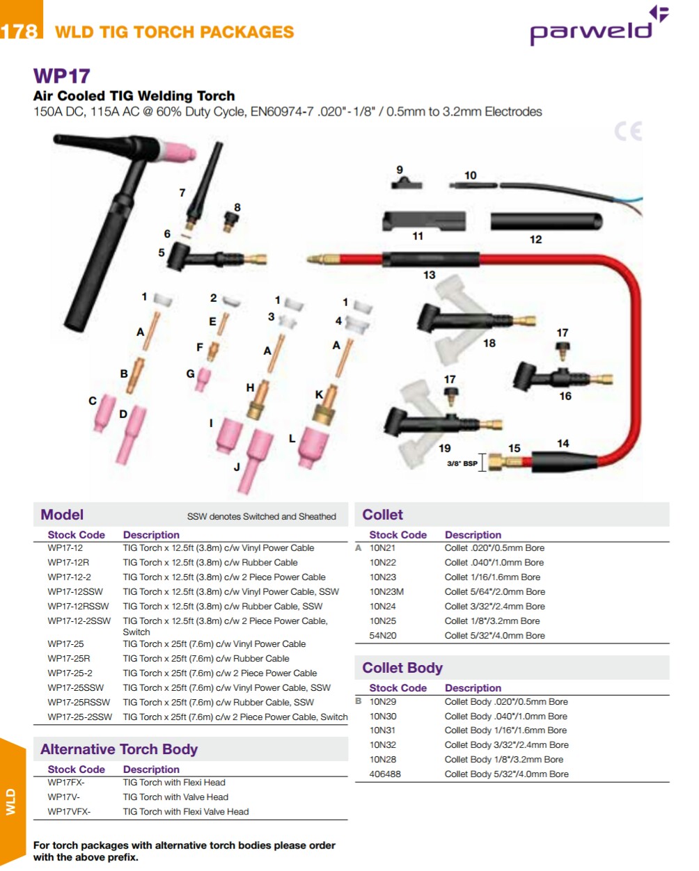

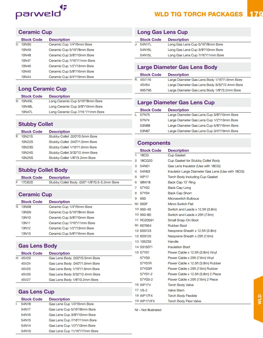

This exploded diagram shows the consumables required for the current torch, But I literally have no idea which cup/gas lense body is the best solution. I understand that I will need a different collet for different size tungstens.
Any advice would be greatly appreciated!
