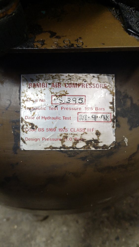

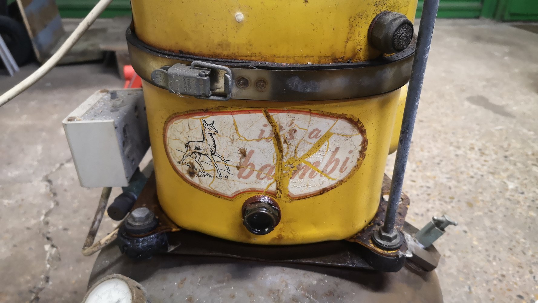

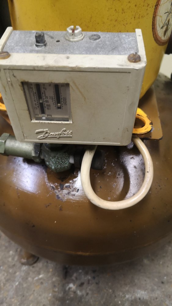

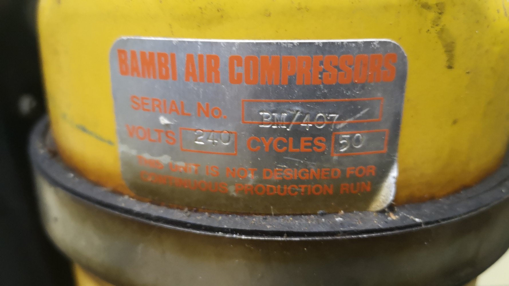

So it runs, but is getting on a bit ... (1978)
The rubber mounts are knackered, the air intake filter looks like it could do with a clean. The oil is what looks like bright blue

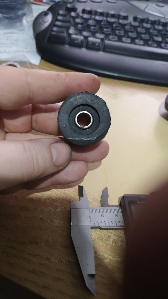

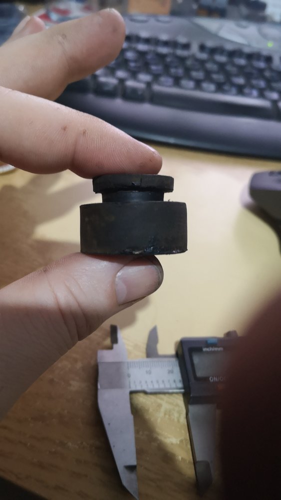

So the rubber mount need to be replaced, any assitance in directing me to these would be appreciated
They have a metal inner which is for 8mm bolts, OD is 33.3mm, total height 23mm, the large area is 15mm high.
The inner diameter, that fits through the sheet metal is what looks like 19mm or 3/4" inch
pics to follow
