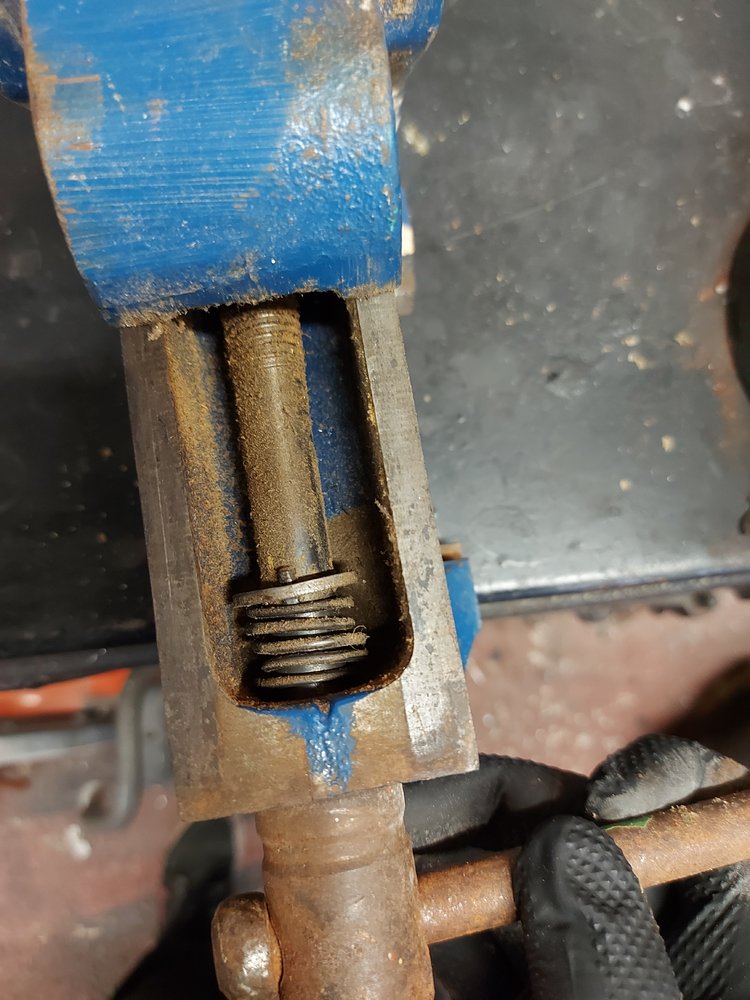

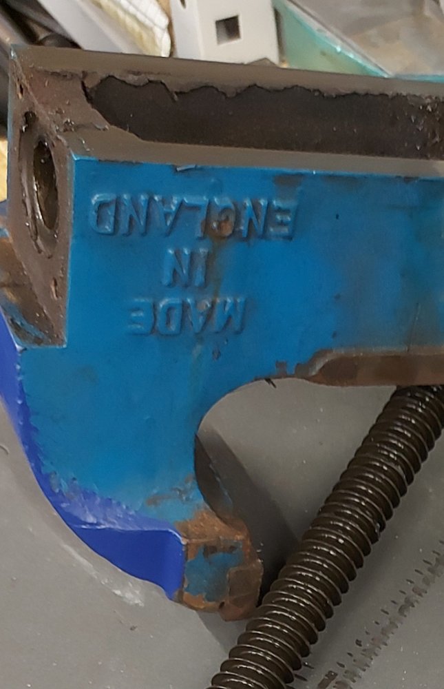

Inspired by this thread, I went and cleaned up my little number 3 (never realised it was blue) and lubricated the thread from underneath with some squirt.
Have been rewarded by the screw just unscrewing until it comes right out with no movement of the jaw
That's nothing to do with lubrication.Inspired by this thread, I went and cleaned up my little number 3 (never realised it was blue) and lubricated the thread from underneath with some squirt.
Ain't that the truth ! I should have learned this lesson by now, there is a catalogue of punished good deeds.There is a saying: "No good deed goes unpunished". Fits your situation perfectly.
Well it was fine (ish) and had been for years before I oiled it !That's nothing to do with lubrication.
Ooooo. Washer and spring ? I will have a look laterThe pin has come out on the screw which retains the washer & spring.
