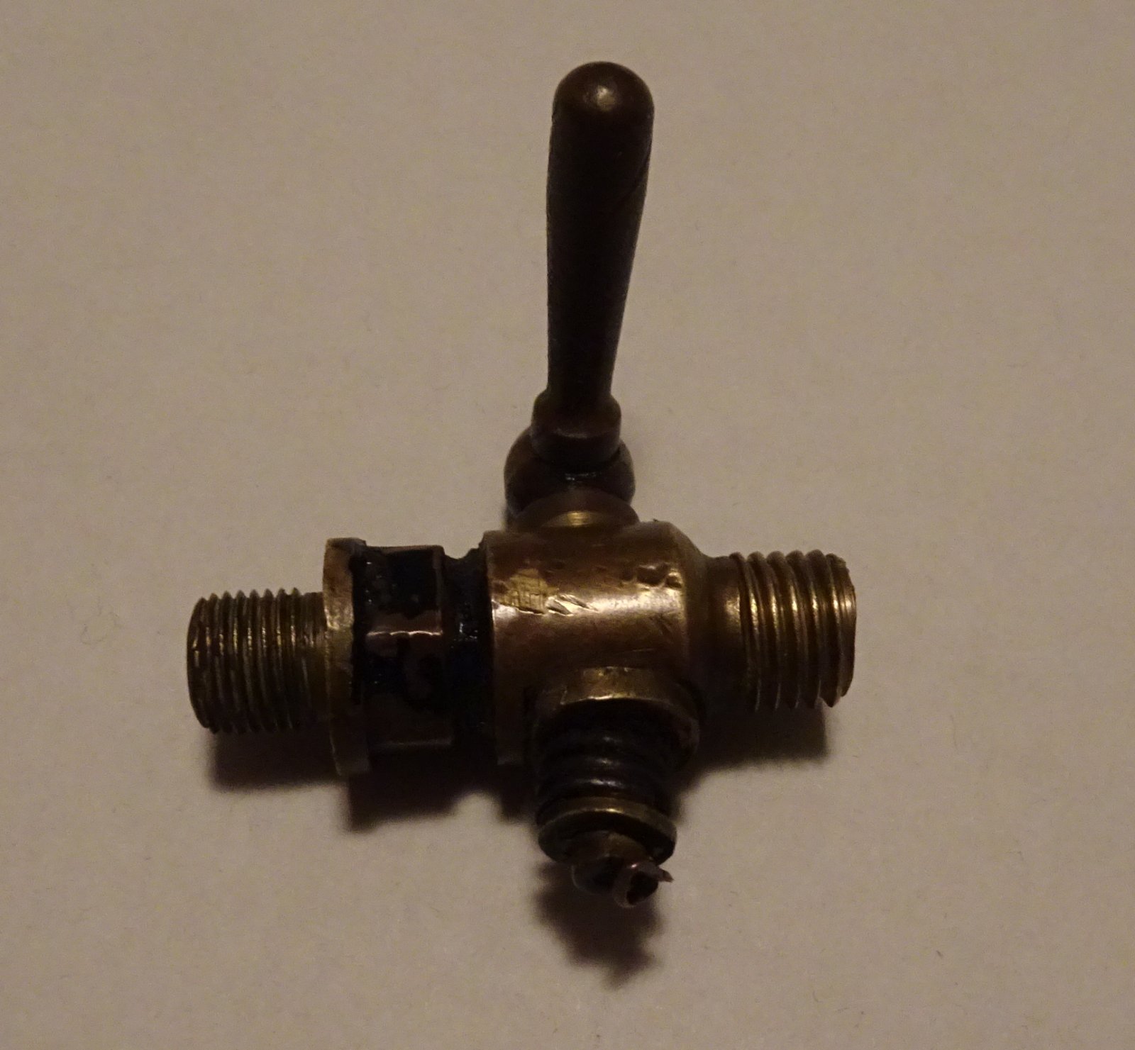

This is the fuel tap on one of my stationary engines. Leaks in the off position I'm going to strip it and try lapping it in, but may need to replace it. Inlet is 1/8" BSP but outlet is 0.4315" x 19TPI which I can't find in my Zeus book, any ideas?
