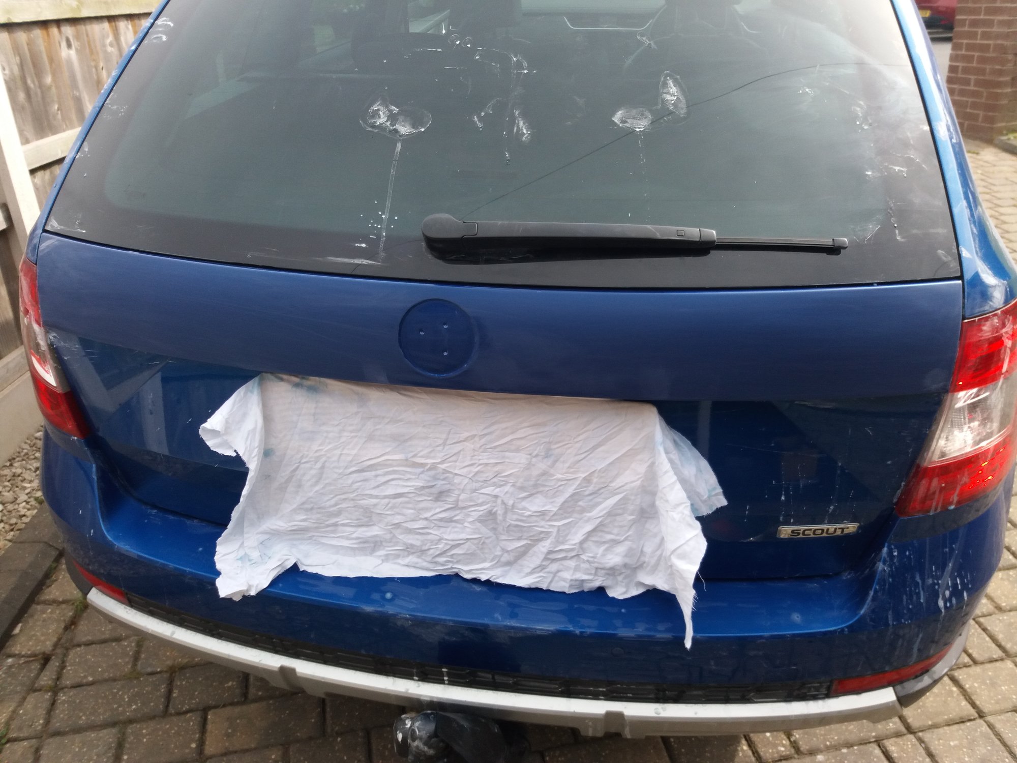

I let one of the lads use my car to get a sandwich. So me being nice thought it would easier to park my car than the a big transit.
He made it back safe and sound til he hit my partially open garage door

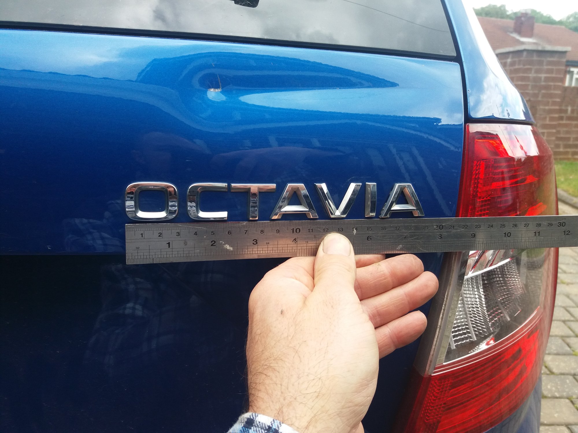

(The ruler is to make note of the letter spacing for refit)
So 8 hours of filling sanding filling sand filling sanding and then masking and spraying.

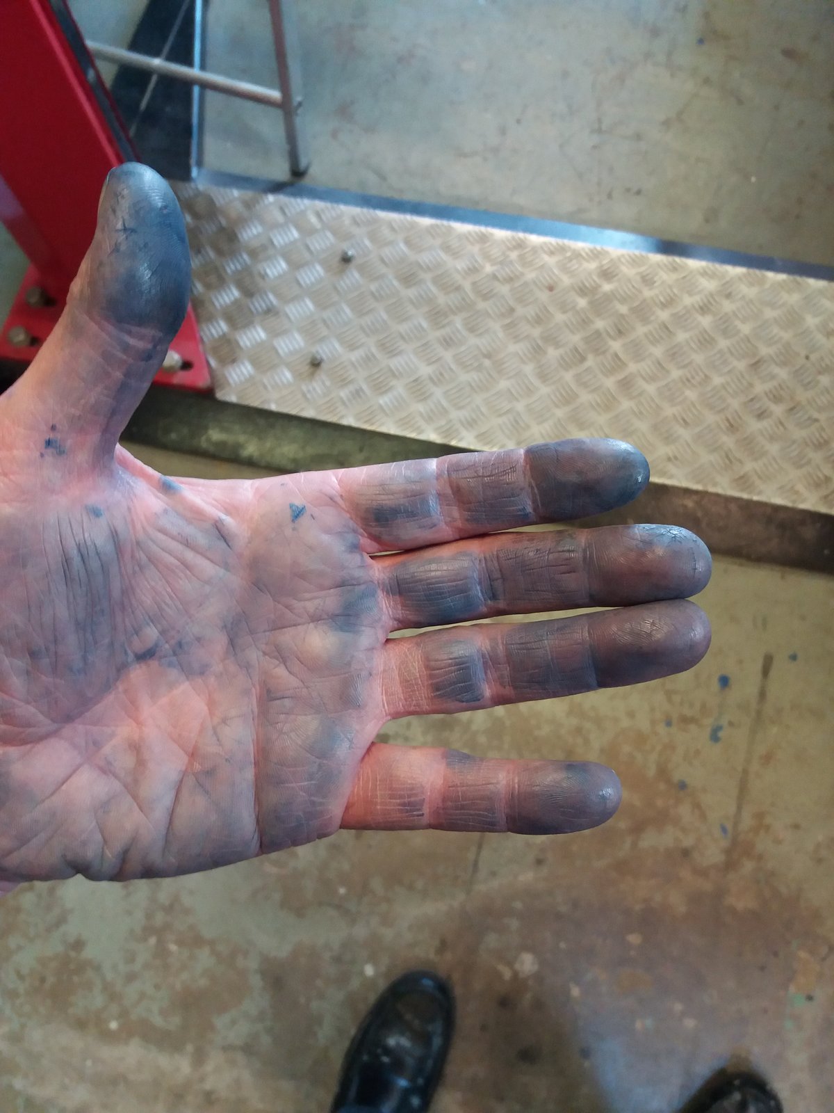

I've started to turn into a Smurf....

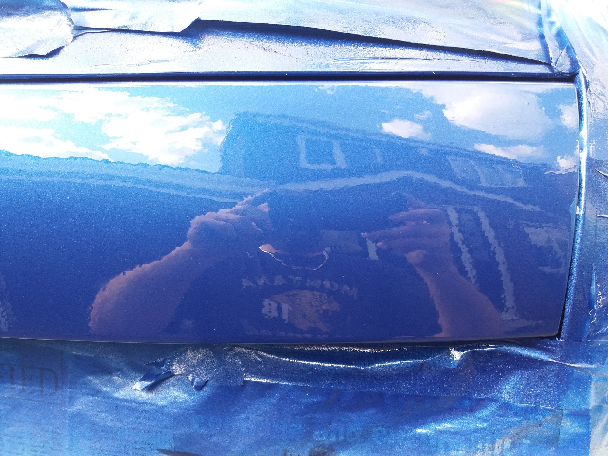

Got the lacquer on.....

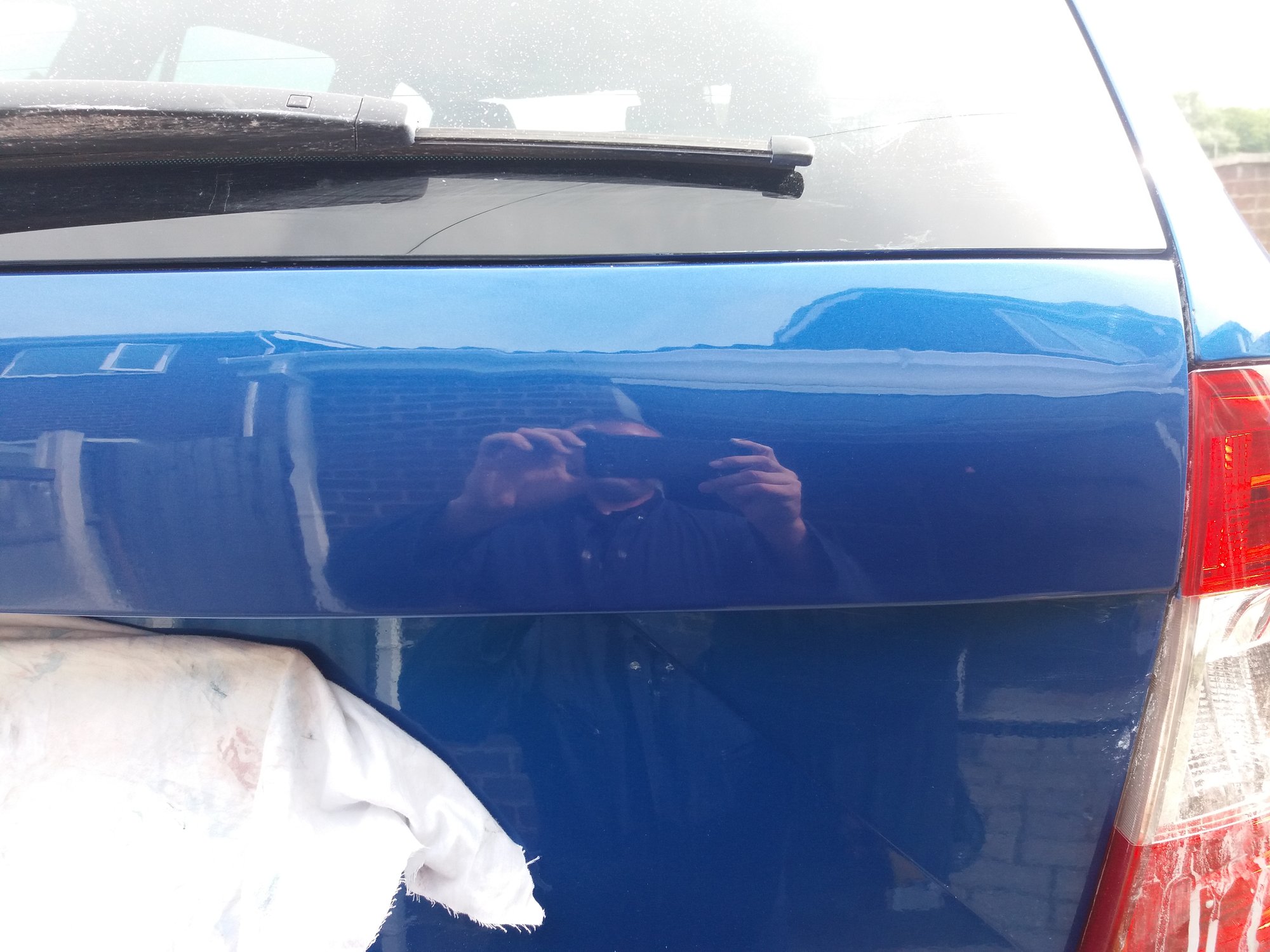

Then some flatting to remove any high spots or orange peel....
And then compound head on sander and some G3 and G10....
Just need to refit the badges.
Spraying done with a cheap eBay 12 quid gravity gun, compressor air line has no water trap or dryer and all this was done outside with 40 mph winds!
