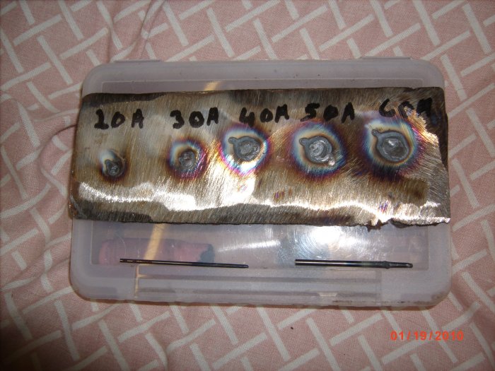

Can you post a pic of a used tungsten (preferably in focus!). Are you sure you've got PURE argon and no leaks in the system? The 'soot' around the welds is fairly typical of a contaminated tungsten, the amount of it typical with an argon/CO2 mix. Simple test would be to do a spot weld on a piece of stainless (not too thin or back it up by clamping it to a chunk of ally or something if no choice)- form a puddle, shut off the arc and pause over the weld for 4 or 5 secs for the post flow. The spot weld should be totally free of colour i.e. like a spot of freshly polished stainless
When welding is it virtually silent or is the pool spitting and hissing? Welding with DC TIG should be silent save background noise (welders fan/watercooler/stereo etc)

When I start I have a nice clean sharpened tungsten, when I finish its blue and blackish with bits burned away, sometimes the ceramic is glowing dull red when I stop, not enough post flow gas?
Yes when welding its almost silent, no spits or crackle, dullish 'hush' that would remind me of a gas lamp with a mantle on burning.
