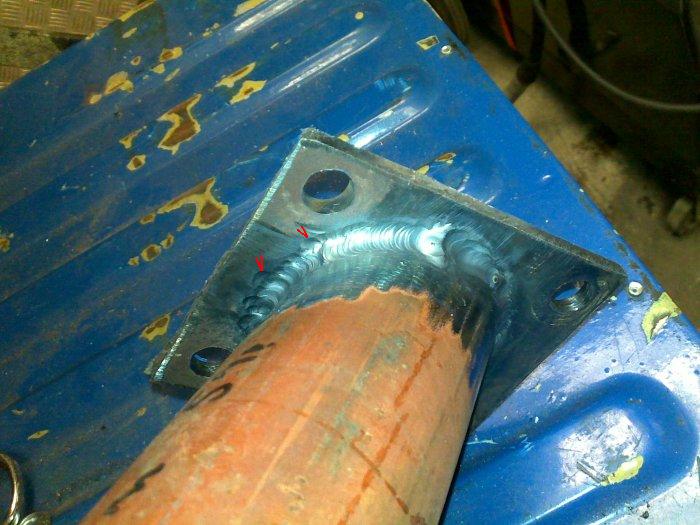

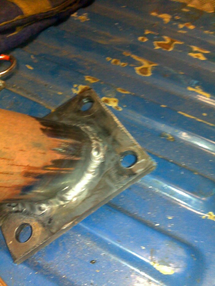

Undercut Link deals more with the MIG process than TIG but illustrates the defect better than this one
I've marked two of the worst bits but it looks like most of the flat plate is undercut. As per the second link torch angle can cause and/or exagerate the problem, welding over millscale will pretty much guarentee undercut, shaky hands and insufficent filler for puddle size are other possibilities
Ditto as stated by hotrodder, I'd watch your stop/starts too, try to avoid crators, as viewed in pics, doesn't appear to much of a throat thickness at points, try to avoid concavity. Apart from this, well done

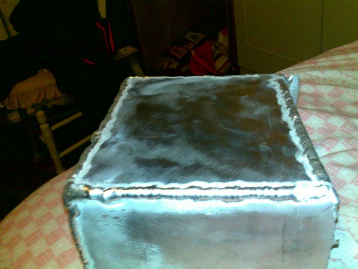

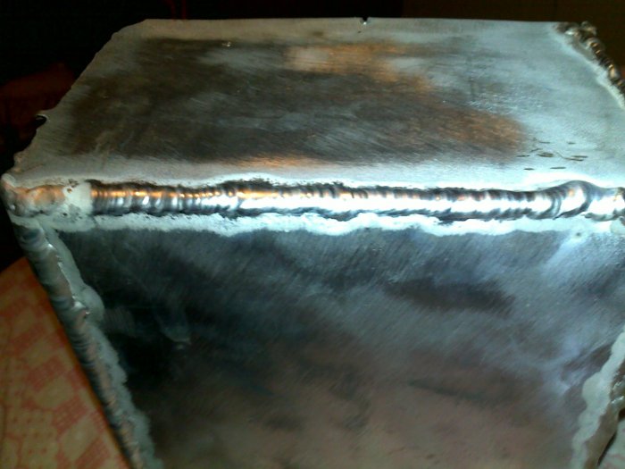

I've also been trying to run some welds on alloy.
The alloy was 3mm thick,

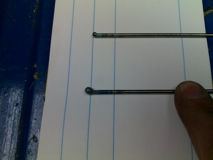

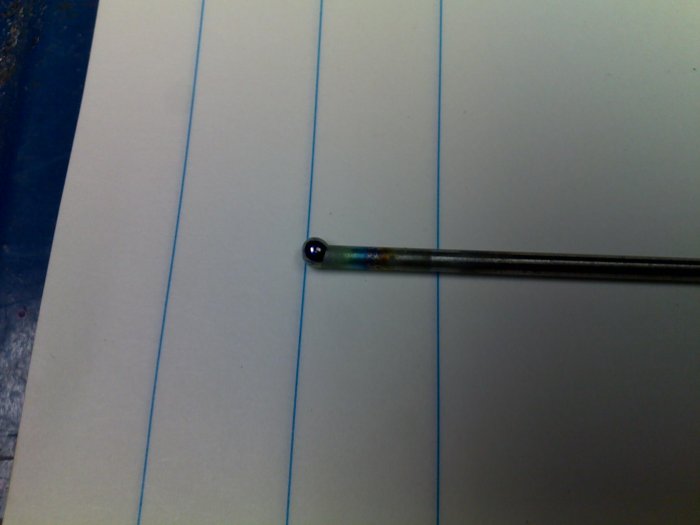

The only problem i have now is the ball on the end of the tungsten seems to be off to one side.
Here's a couple of photo's, one that i dipped and one that i didn't. But both balls on the end are lop sided so to speak.
Just realised what machine you're using. If there's no 'AC balance' adjustment then proper balled tungstens are the norm, better off just 'breaking the sharp edges' than sharpening even to crayon shape. What flavour tungsten? I'd stick with zirconiated (white band) for AC.
The balled tip is moving off centre due to gravity i.e torch angle. Holding the torch a little more upright will help, less prep on the tungsten (as above) may result in a smaller ball (been a while since i've used anything other than a posh inverter). When the tip starts balling up loads often better off stepping up a tungsten size for a more stable tip

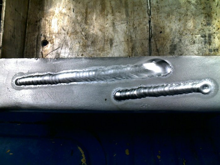

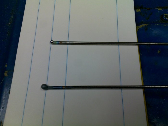

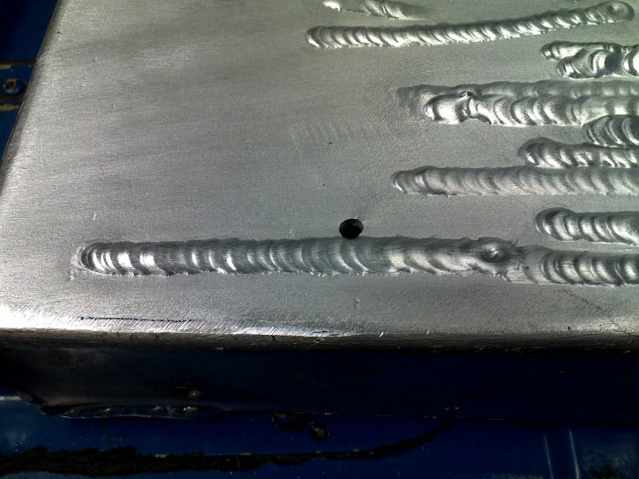

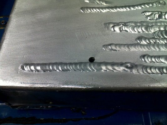

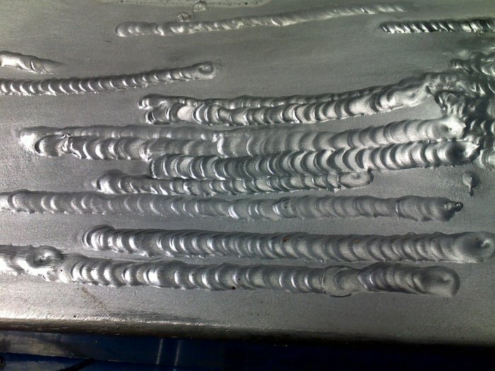

Have been doing some more practising today. less of a point on the tungsten and keeping a close eye on torch angle. Here is a couple of photo's of my tests.
