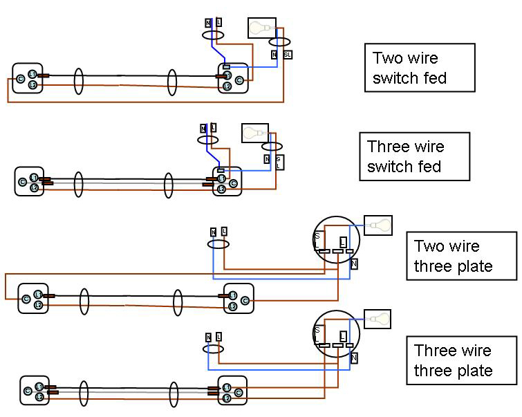

There are 2 doors so I will need a light switch at each end also. and I have forgot how to wire 2 switches up??????????
