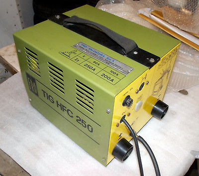

Hi can anyone give me some information about a saf hfc 250 tig was told it was a stand alone machine but can’t find any details online I’ve plugged it in and won’t arc .so I’m thinking it’s got to be powered by another machine any help much appreciated

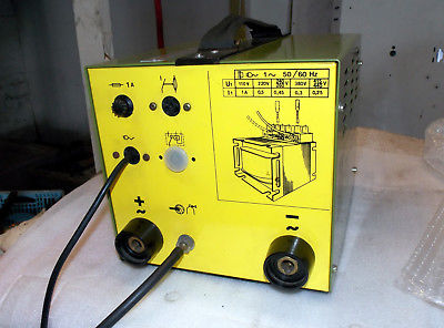

As said, it's a add on unit to give HF to a unit with no HF
Judging by the name of your migatronic it probably already has hf anyway.

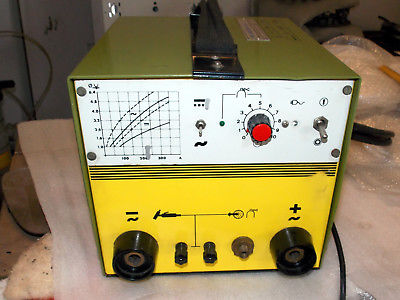

The dial is for setting the time for post flow for gas.
If your migatronic has hf and gas control then you won't gain anything by adding this on.
Fyi. You would set the power you need to use on the source welder then this unit will just pass that amount through and add hf over the top of it. Max input would be 250 amps or 200amps continuos use.
