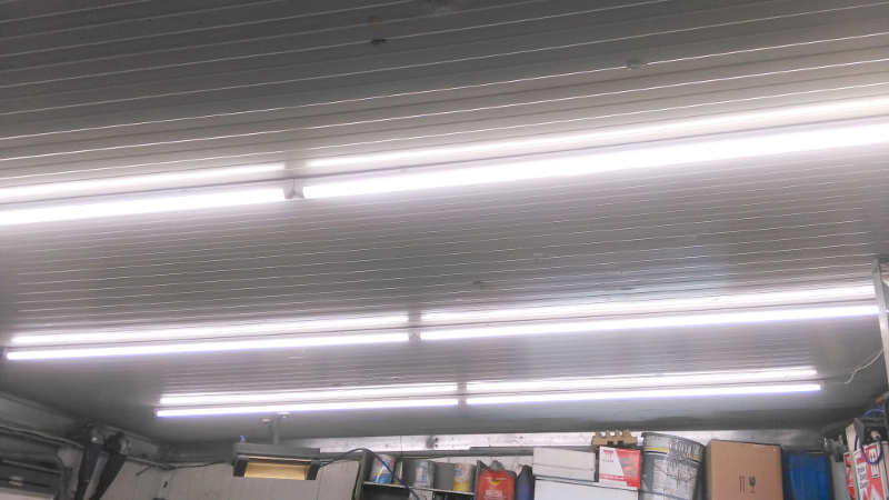

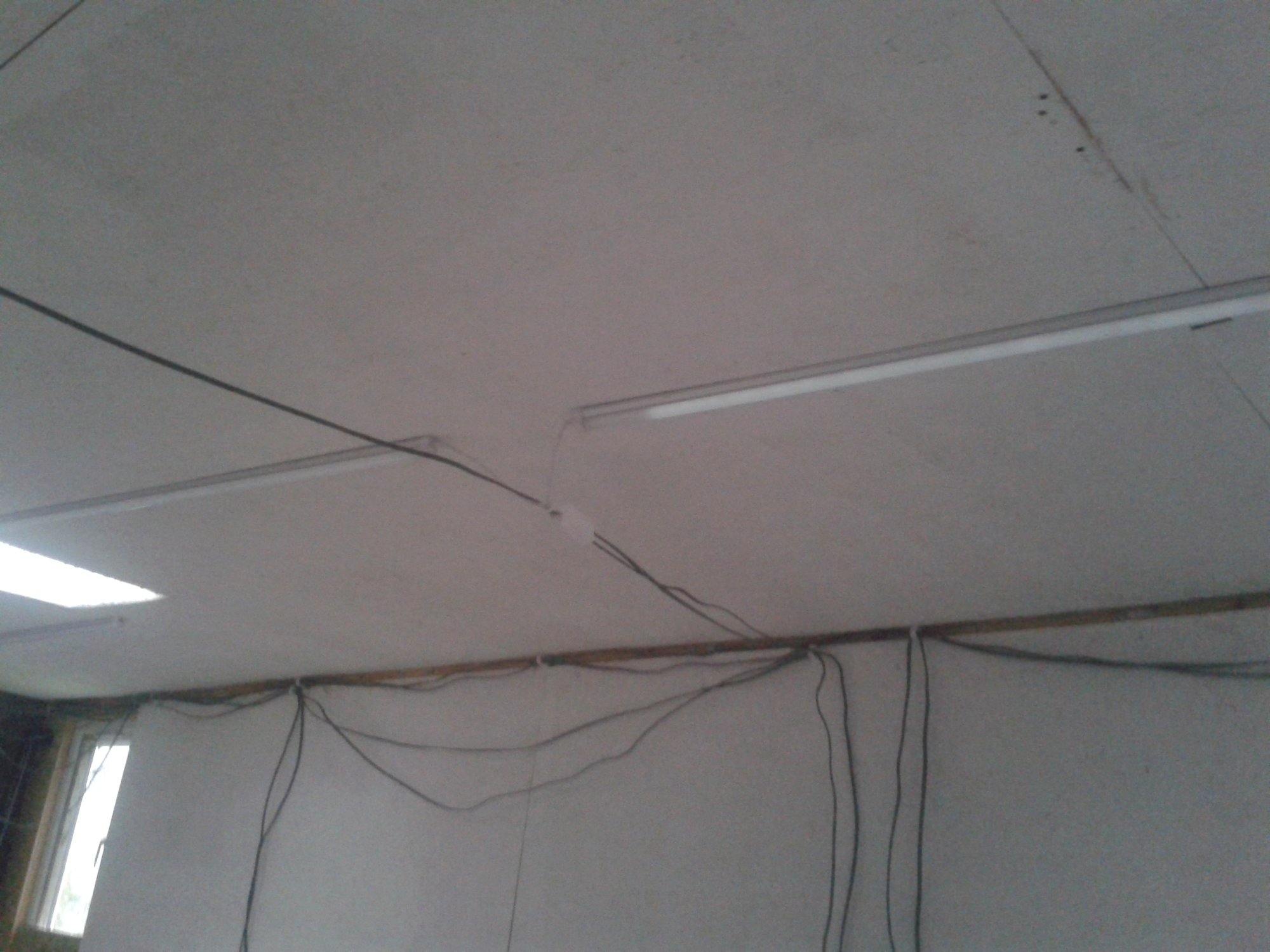

I fitted my new LED strip lights in the workshop today and was very pleased with the increase in lighting. I bought 8no 'natural white' 24w T8 units. They are super easy to fit just by screwing two clips into the ceiling then clipping them in, and they come with little connectors that let you plug one strip directly into another to daisy-chain them and create one long strip of lights. My workshop is 5m x 4m so I installed them in 4 rows of two lights (though you can only see three rows in the photo). I ran new wires to all the lamps and then shut the power down and un-wired the old fluorescents and ran the switch feed to the new lights:
I'm well impressed, I no longer have a 'dark corner' and I don't need to run a lamp when using the lathe. The light really is 'all over'.

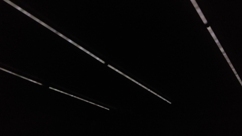

So flushed with my success tidied the workshop and went to lock it up for the night, turned off the lights - and they didn't go out!
Then I remembered reading this:
So I re-wired the junction box to switch the live feed instead of the neutral and they all went off properly. Happy days!
Definitely worth it IMO. The 8 units come to less than 200w total and light the workshop up great.
