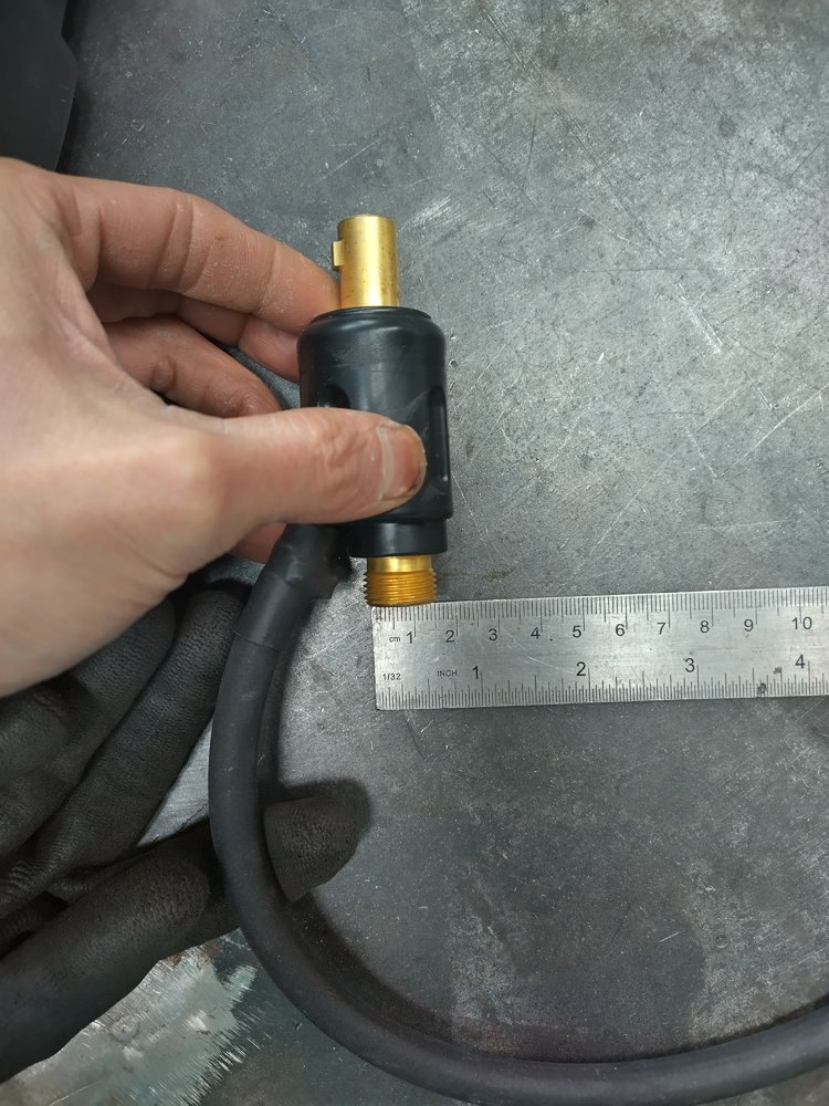

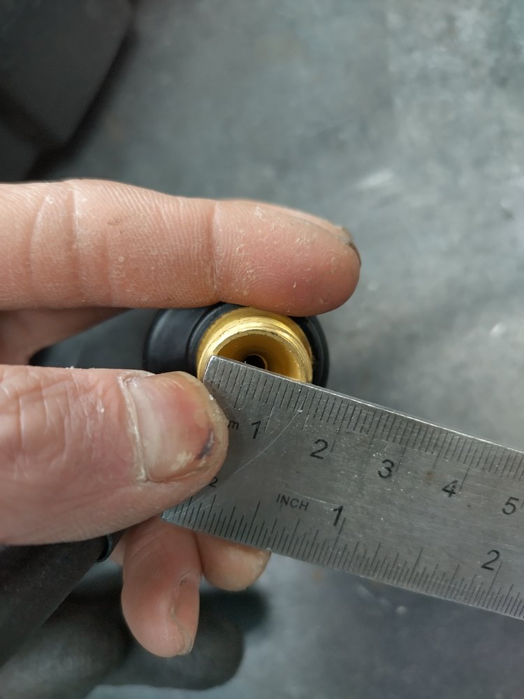

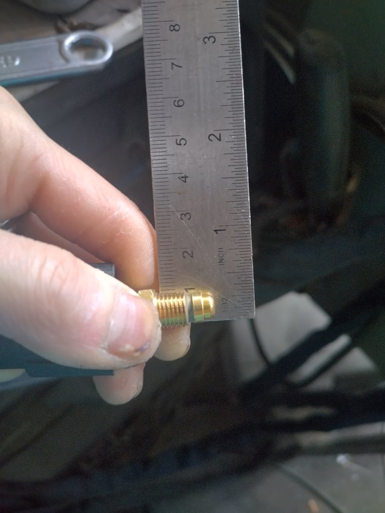

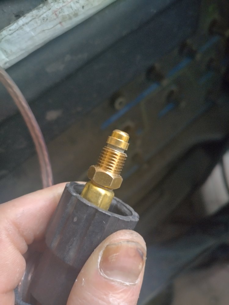

You Dinse adapter looks like it has the standard 3/8" BSP male thread (which is actually just over 5/8" 16mm OD) The internet says that some CK torches have 1/8" x 28 TPI BSP threads (1/8 is just over 3/8" OD. If so, you'll be looking for a female 1/8" to female 3/8" BSP adapter to put the two together.
