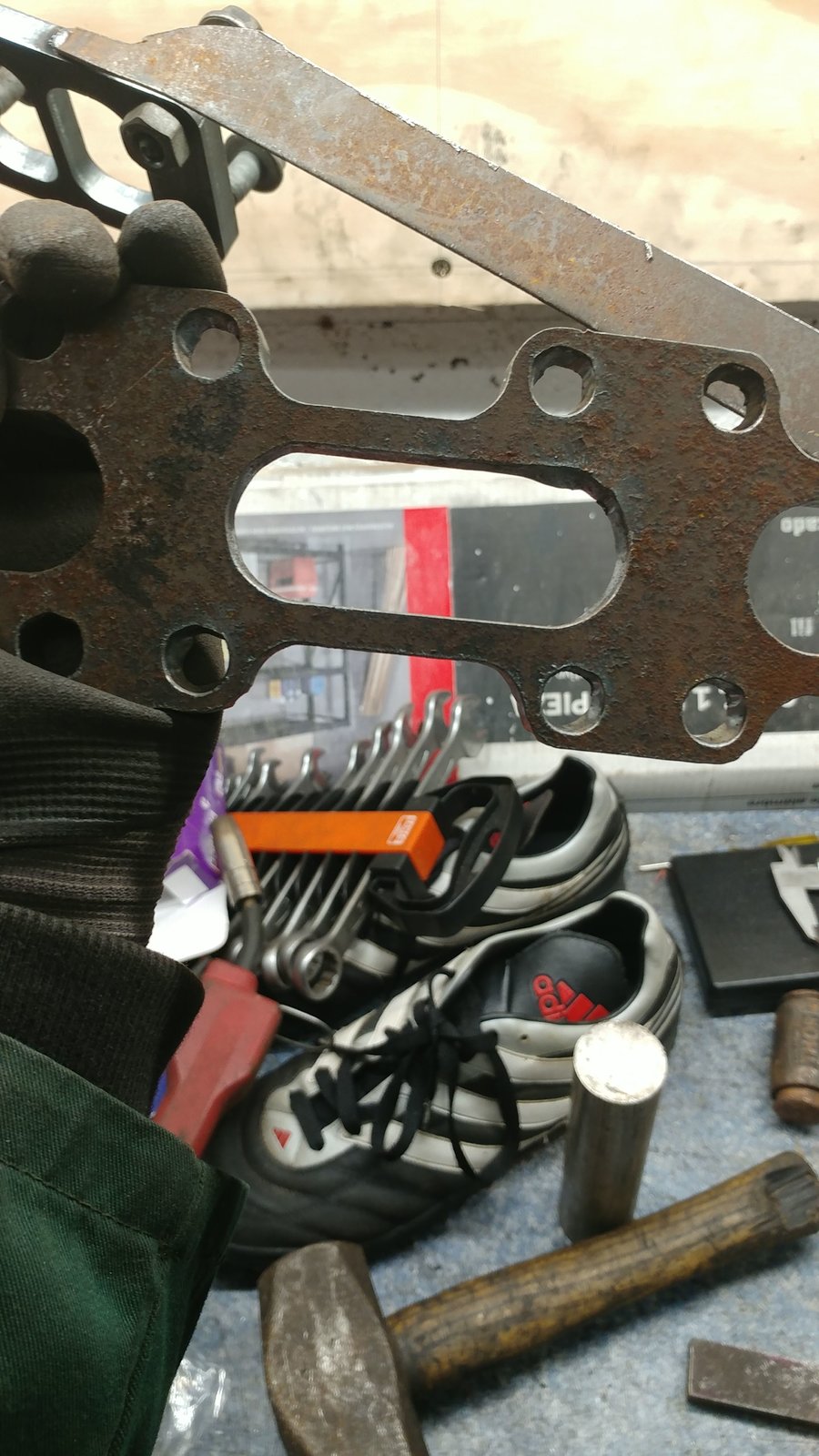

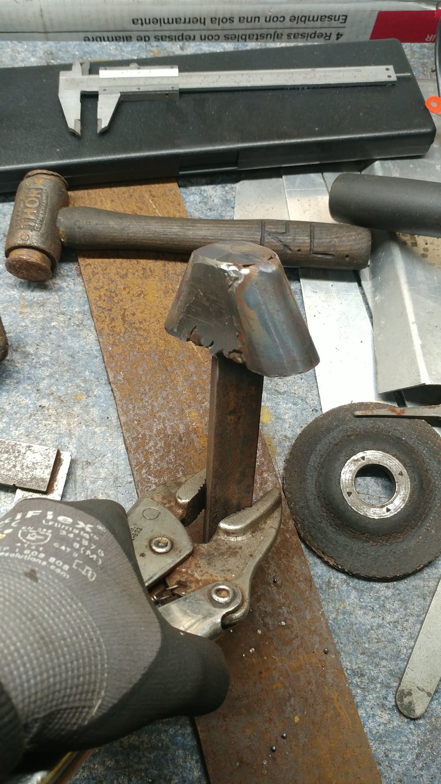

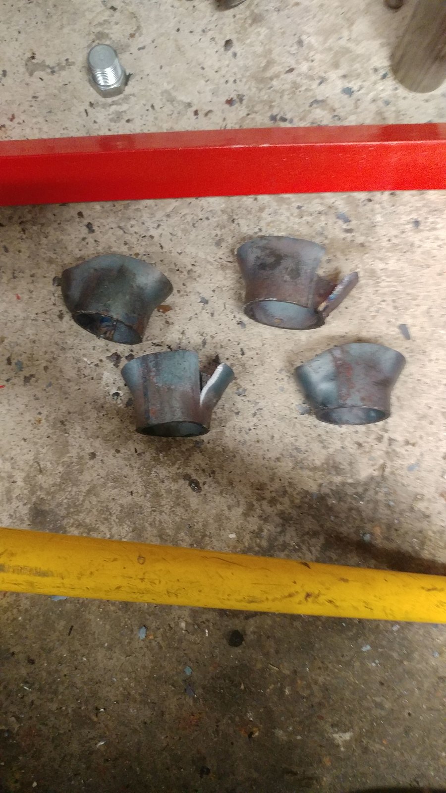

    I've got some 42mm tube with 2.6mm wall. I'm trying to flare one end into an oblong shape. Ive made a die using round bar which is used with a 20t press. The problem I'm having is the tube cracks, even after heating red hot!
    So the tube needs to be flared to this shape:
    This is the die
    And these are the results:
    Would it be better if I used cds tubing?
    Also would it work better if I flared it out with a cone shape first to obtain uniform wall thickness, then hit it with the final shape?

    Possibly a longer cone is needed. Also, don't heat it and expect to do it in one. it may need to be annealed a few times. Or perhaps the material just doesn't like being stretch like that. I'm sure someone will know.

    Is that ERW tube? Ideally you need seamless drawn tube.
    You will need more processes than heating and pushing around a former in one go. Part of your profile needs stretching while other areas need shrinking as the shape develops.

    If you want to do it over a die like that, then something more progressive - like say 3 or 4 dies getting wider each time.
    Or, imagine a round split down the middle and driven onto a wedge (crappy drawing available on request).

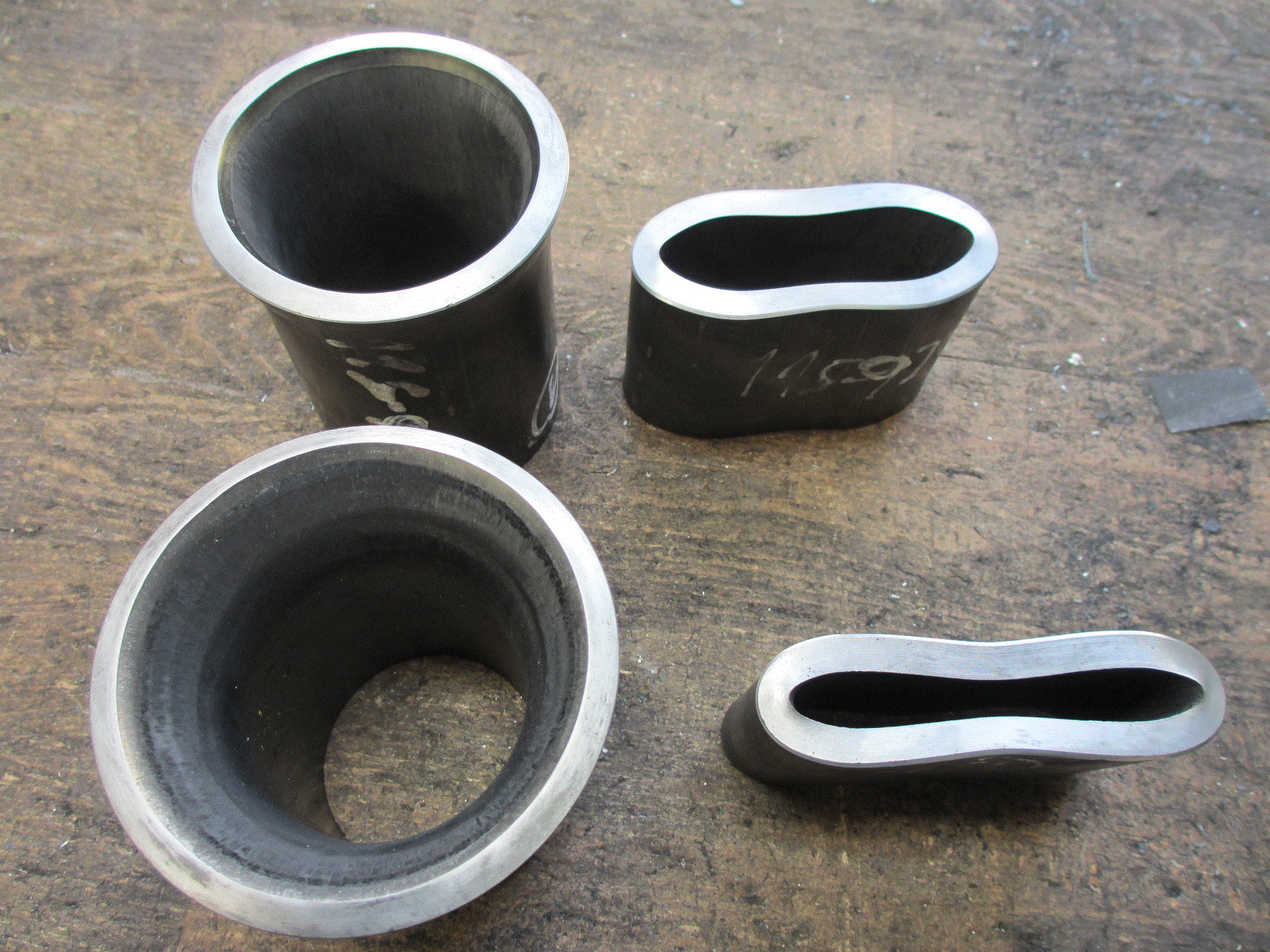

    Ductility is the key here. I've seen 50mm OD x 6mm wall boiler tubes capable of withstanding 175 bar under tests similar to the shape you are requiring. Material was 16Mo3. IMG_2490.gif

    You need to either make a couple more smaller forms to slowly bring out the shape or just make it from one tube cut down the middle with a triangular section top and bottom.
    Personally I would go for the latter unless you move to using stainless and use a reducer that you can squash.

    Starting with a cone like 8ob said makes this a lot easier. The former in your pics is very rough as well, formers for stuff like that should be polished perfectly smooth to reduce friction and let the metal slide on the former rather than dragging on it
