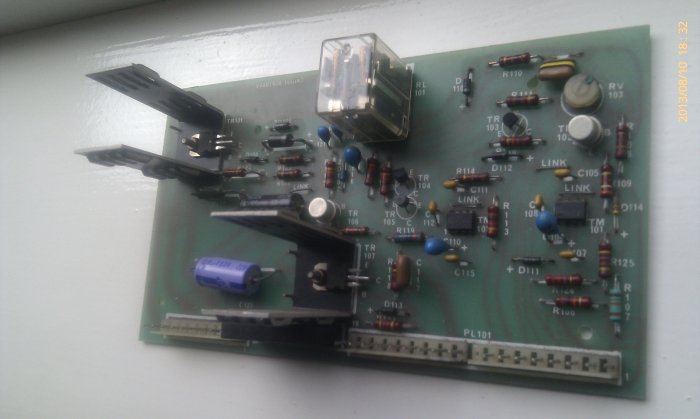

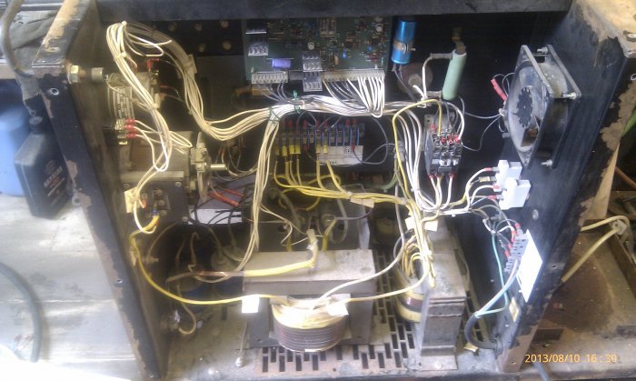

I have an old Murex Tradesmig 140 which has been stored for about 20years and was working fine when it got stored.
Info on the label at the rear of the welder TM140, Pt No. 1198245, T301-0015
The welder now doesn't work. The fan runs but pulling the torch trigger doesn't trigger anything.
I have the covers off and it is well grubby inside, but I have done some basic checks:-
The torch switch appears to work - I get continuity when I pull the trigger.
CB1 & CB2 (circuit breakers) both seem fine.
There were some dry solder joints on the circuit board which have been re-soldered.
Can anyone point me in the right direction?
I have very basic electrical knowledge but can use a multimeter.
Thanks

so I'll try and backtrack from know places it should be, Torch trigger, contactor coil and see where it leads me.
(presuming your not electrocuting your self every time you go to measure something)
