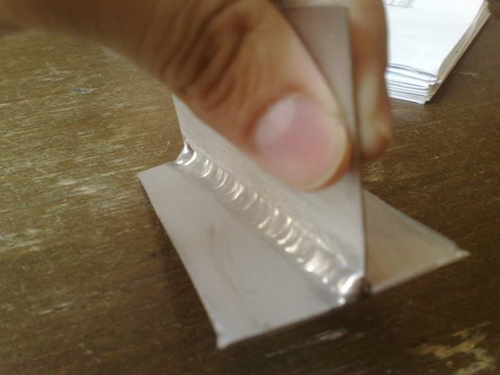

For example, here is a photo of pulse welding of aluminium plate, 1 mm thick with AlMg5, 1.0 mm wire. I did not fine tuned it, I welded with a bit longer arc, so small spattering occured. I used original version of that machine, simply several brands has it in its sales program.
