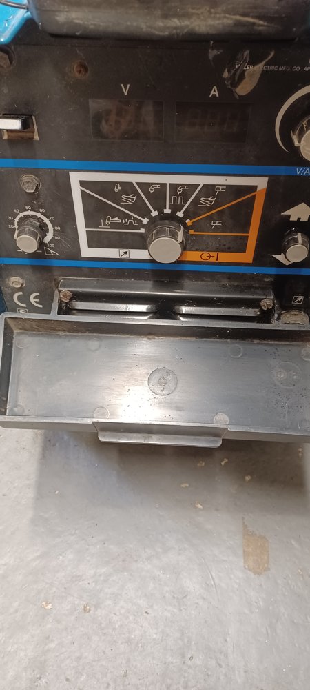

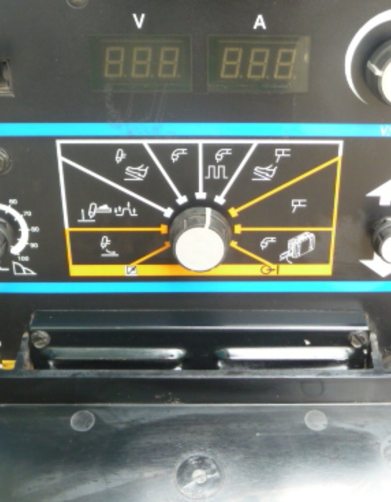

i want to use a miller sp series voltage sensing suitcase alongside the 304xmt

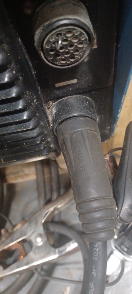

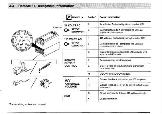

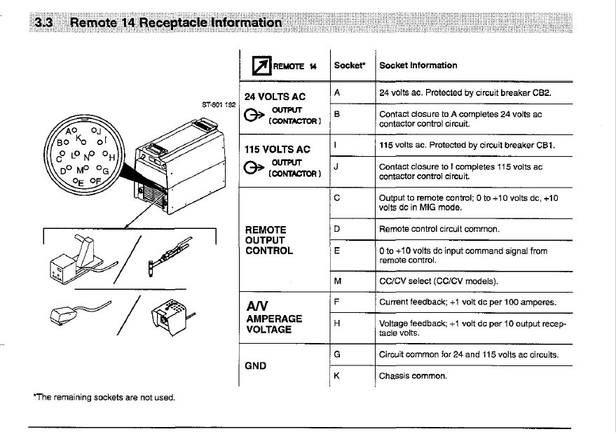

so far i cant get any cv output i get a display volts , or pulse so i asume there is an internal contactor that needs to be energised via the 14 pin
connector
it works reasonable on stick cc on flux core dual shield with a bit of tweaking the dig but i d rather have it on cv
for positional stuff. so
anyone know the pin out connections to make the terminals always hot on the machine using the cv mig mode
