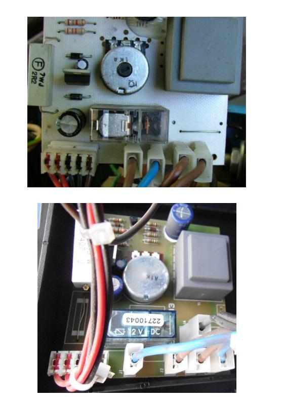

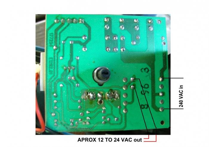

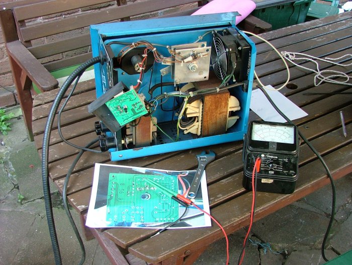

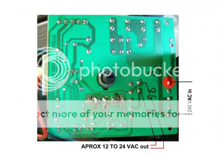

if the there are lights working on the front and the fan is also working then you need to check there is 240v going into the transformer on the pcb and also voltage coming from the transformer
