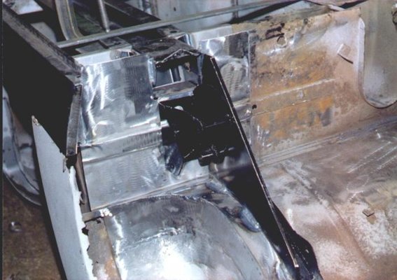

Today I measured the door gaps and was pleasantly surprised to find they are even both sides! I then took a lesson from the Bodgit school of engineering, found a shelf bracket lying around and tacked it across the N/S door to keep the gaps correct:

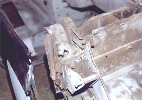

Then, it was grinder time... A cutting disc made light work of the rotten outer sill, revealing:
Surprise, surprise - a rotten inner sill. I then had a quick nosey inside the car and noticed that the rear spring hanger is knackered and breaking away from the floorpan:
So question time...
Should I remove the inner sill next and tack the replacement in where I can before fitting the outer sill and floorpan?
Or should I remove the floorpan next, then replace the floor before the inner sill? This would probably be easier, but as the car has the structural integrity of a wet teabag is it just going to collapse like a clowns car?!
