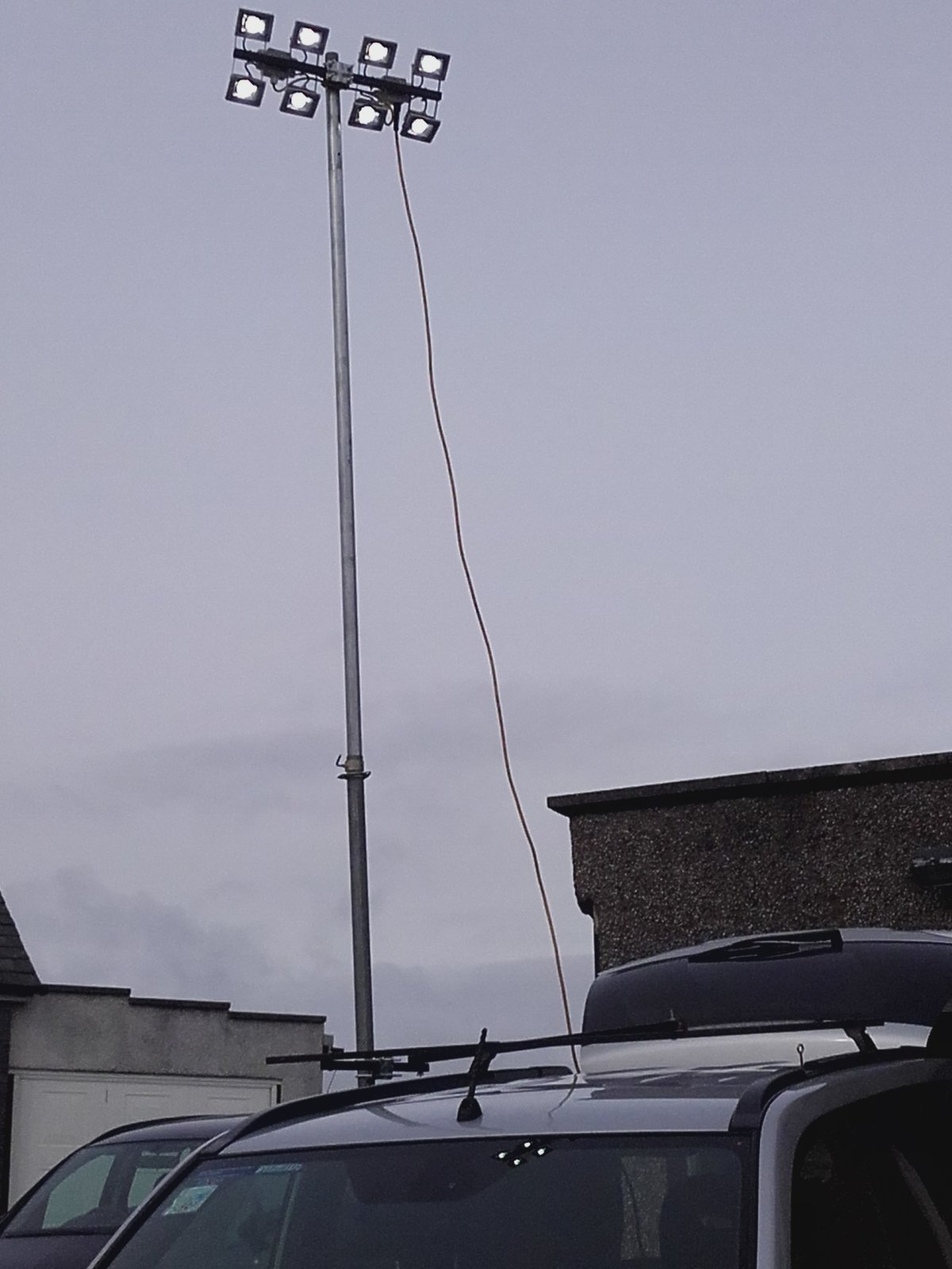

Ive got a few LED floods surplus at the moment, but could do with a few 110 work lamps.
It says input is 85-265V AC 50HZ
Will these run from a 110v CTE transformer?
They should do, wire one up and try it, I can't see an problems apart from it not working but it will be within it's voltage tolerance so it should work fine.
I purchased 8 off from china via the bay of E intending to make a mast mounted light
out of the 8 , 7 worked fine on 110v the other just flashed when I rewired it for 230 it stopped flashing
I will source another at some point to complete the little project
They normally do only had a couple that didn't, i think its a case of chinese specifications being a bit 'one label fits all',and a pinch of 'what components are in the stores today'.
