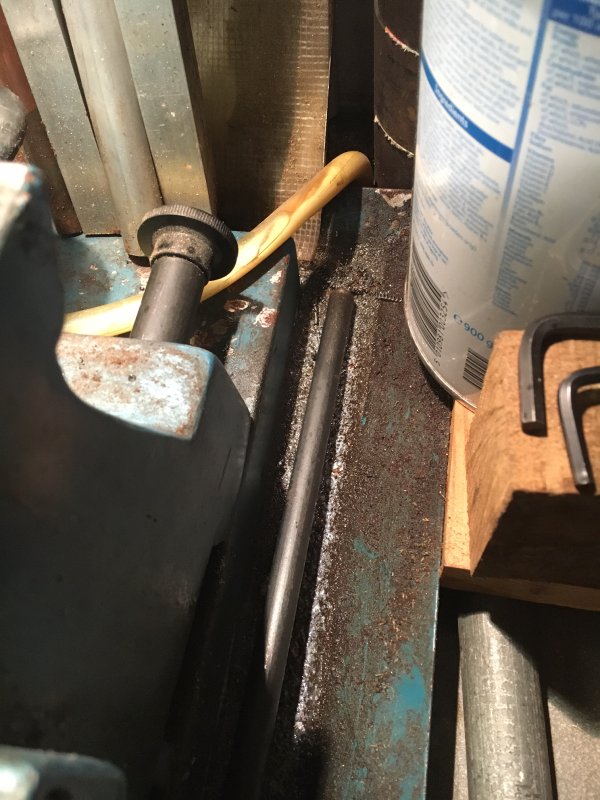

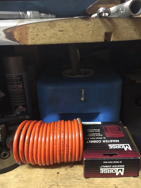

i used to use a bottle, but found a coolant system a must.
mine drains back into the tank, and filters throu a bit of wire wool, thats easy to change.

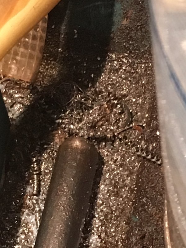

(the lump at the end of the round bar.)
close up, has some swarf over and around it, makes it harder to see. but just a bit of wire wool pushed into the hole.
so acts like a filter..
and the tank is easy to get to, and disconnect and change when needed.

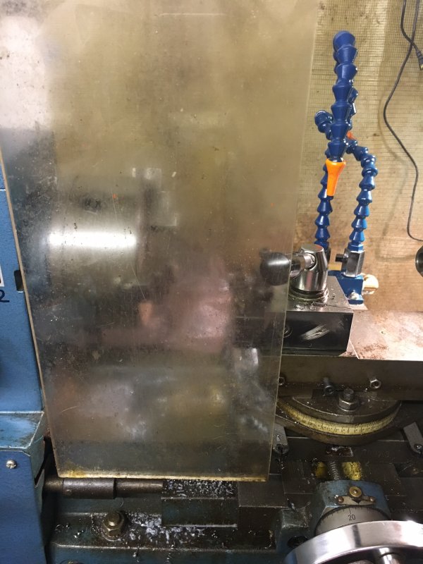

i use a screen to stop it getting me.
though next time im near the plastic place il pop in and see if i can find a piece a bit wider.
