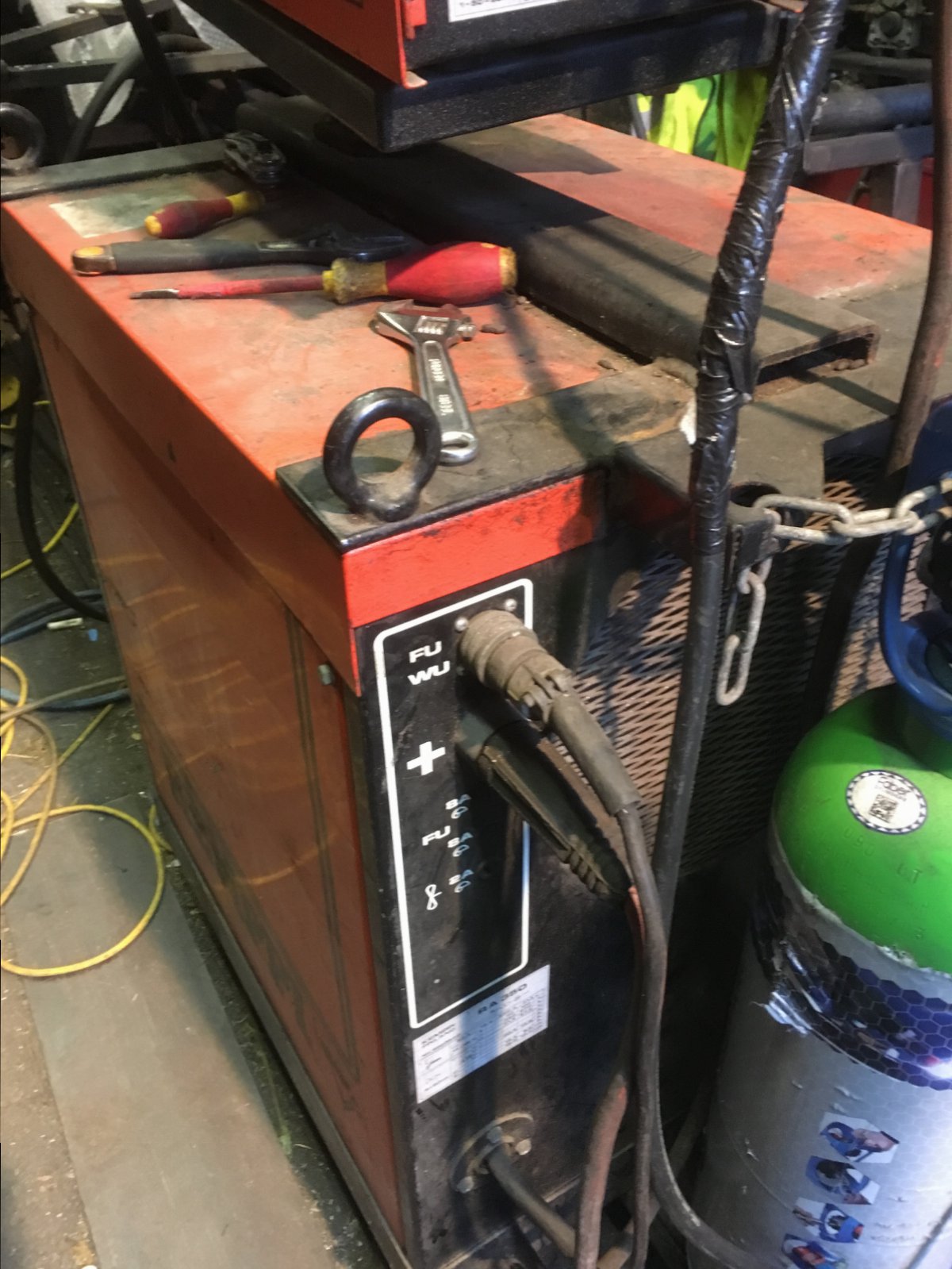

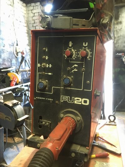

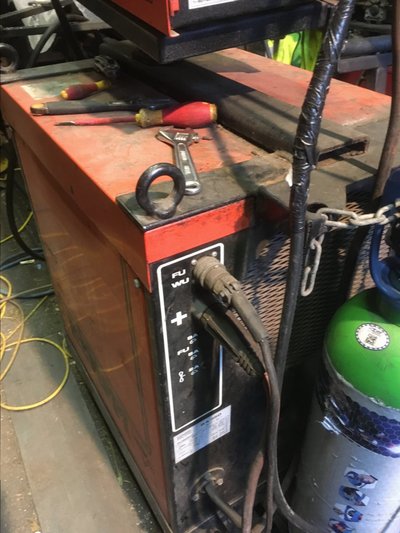

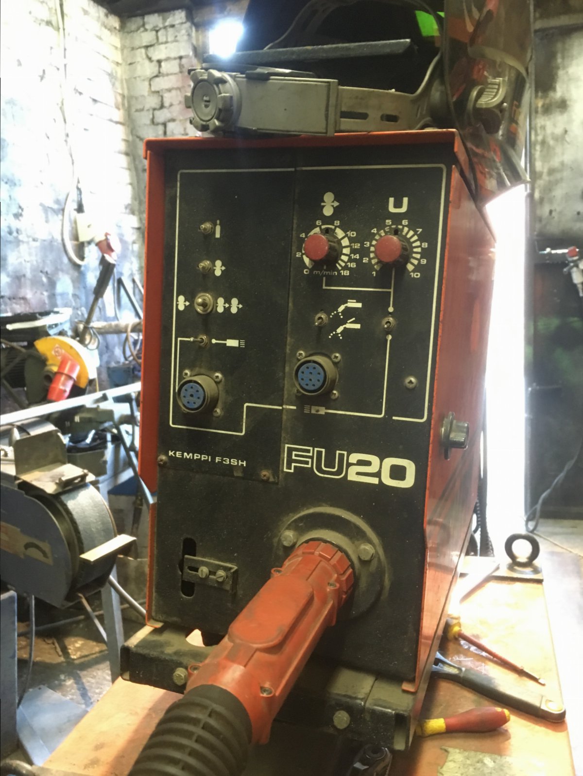

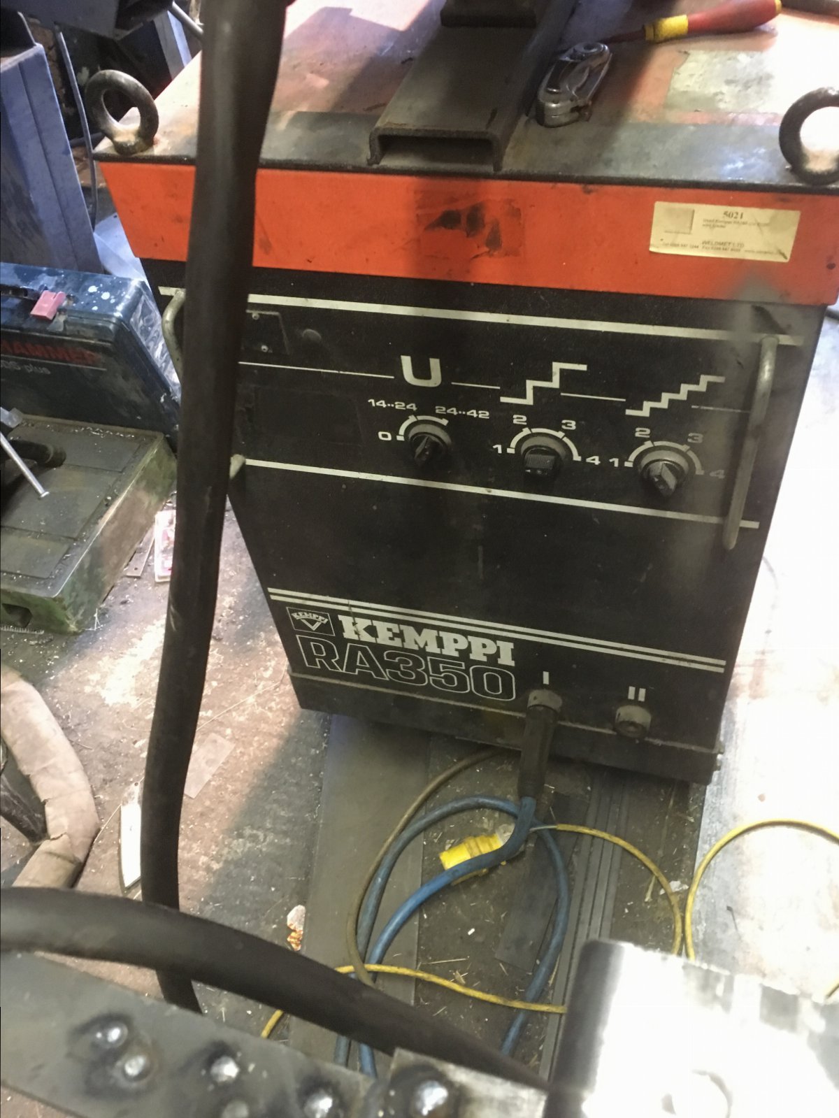

No is a ra350 and a fu20 wire feeder with two earth connectors at the bottom the wirefeeder has what looks like two blue multi pin connectors at the front and I can't get the wirefeeder working I've looked online and can't find anything to get it working
But close to it just a few more things on itNo is a ra350 and a fu20 wire feeder with two earth connectors at the bottom the wirefeeder has what looks like two blue multi pin connectors at the front and I can't get the wirefeeder working I've looked online and can't find anything to get it working

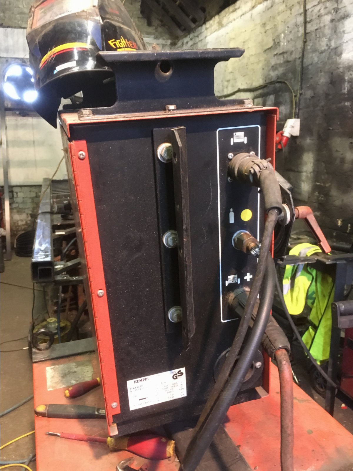

Gas, communication cable and live I think just three connectionsWhat interconnections do you have between the two units?
Will send pictures in the morning of itProbably be better if you can post pictures of the front and back before we start trying to help you fault find.
Changed them but the wirefeeder is still not runningthe switch below the voltage "U" dial on the FU20 needs to point upwards. as it is now it is set for remote control.
the switch below the wirefeed speed is the 2t - 4t setting.
That's what I remember for now.
