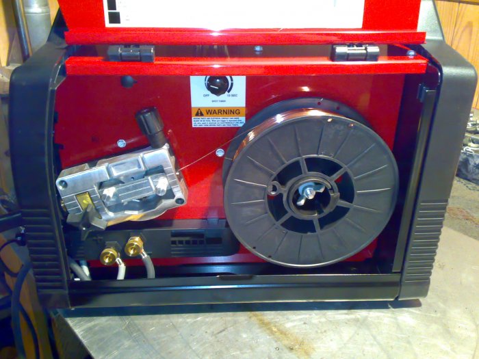

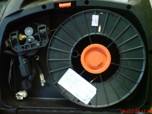

People seem to be obsessed with the idea that a Euro-Torch = super smooth wire feed & will be the cure to all their problems... it won't... that's down to the wire feed assembly itself.
Fitting a Euro-Torch to a machine with a poor quality wire feed assembly & poor quality direct wired torch will improve things...temporarily... but you'll never get a really consistent wire feed without a really consistent, quality wire feed assembly Quality machines like the Kemppi (and Lincoln etc.) have a quality wire feed assembly and, even with direct wired torches, perform infinately better than machines fitted with Euro-Torches but sh1te wire feed assemblies!
