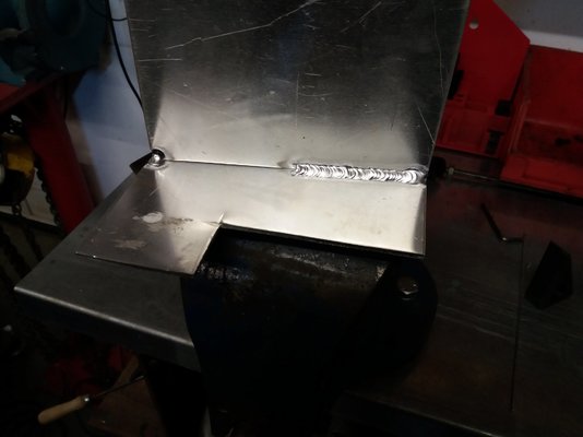

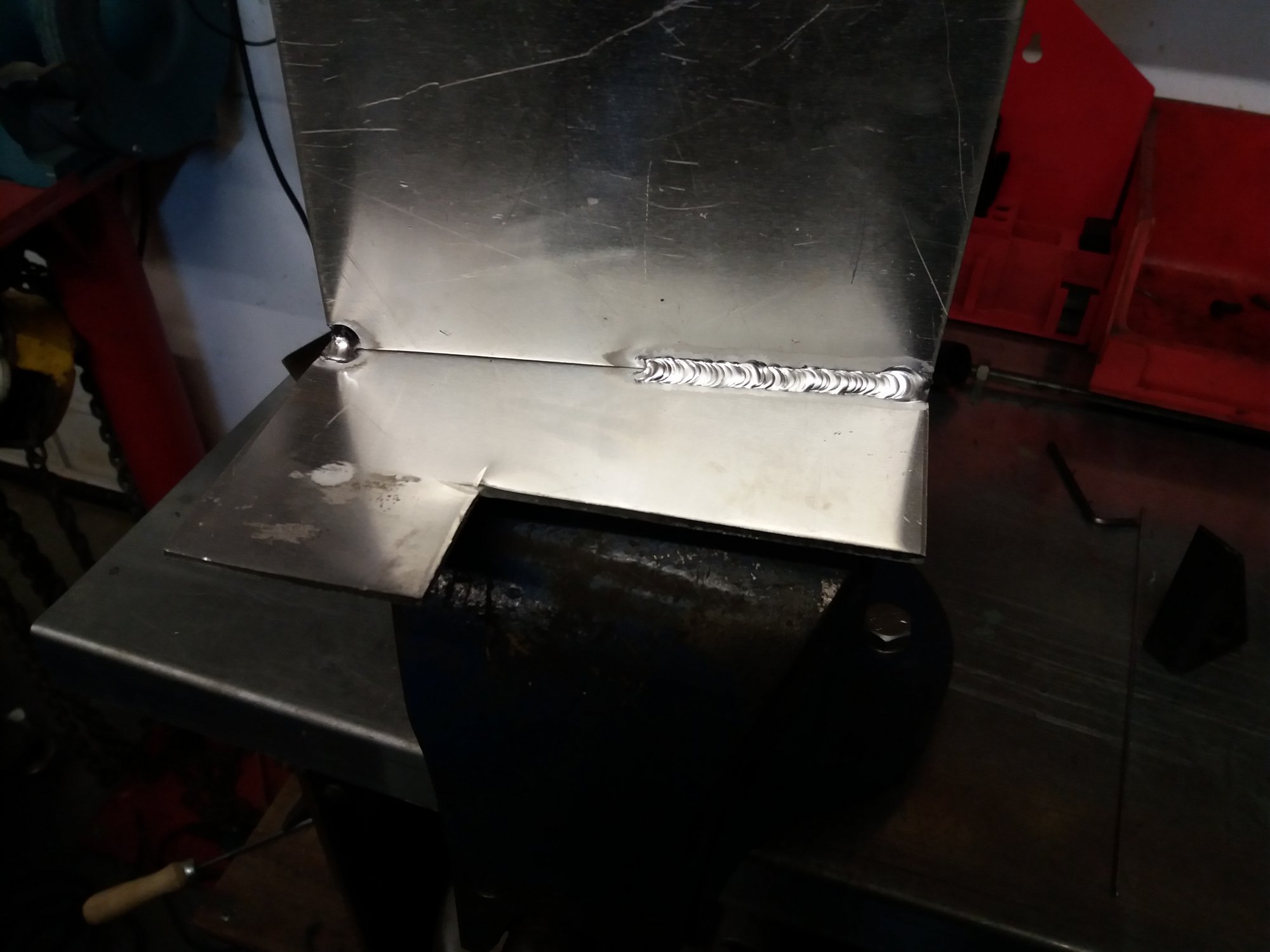

Had a play for the first time.
3mm Ali with some unknown rods and wrong tungsten (red top thoriated) I've ordered some wp 20 consumables as I don't have any. My last torch was a 17/26
Anyways this is my very first weld with it and on Ali set at 130amp max with pedal 100hz and 80% balance.
It is soooooo nice to use compared to my old set. And the torch is flat cold, it feels odd.

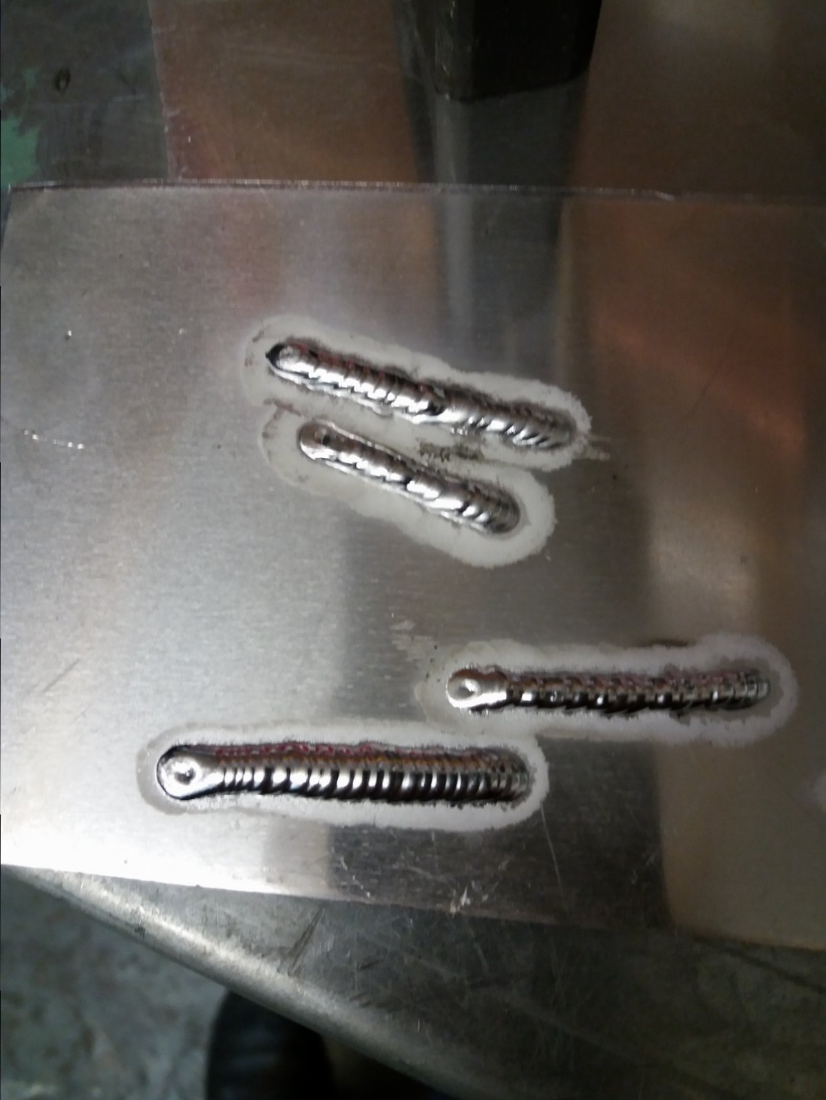

It's hard to see what is stamped on them. Some are I think 4043, some say "pure" and some have what looks to be three "x" on them.
They are from a mixed bundle my brother gave me I use for messing about with.
4043 is 5% Si
It's a common widely used filler for AlSi materials, castings and 6xxx grade material.
Pure??? I've never seen that stamped on a filler rod before but pure Al is 1xxx grade which is what looks to be on your welding pics as it has a tendency to produce mirror like welds.
