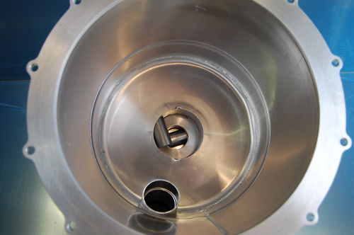

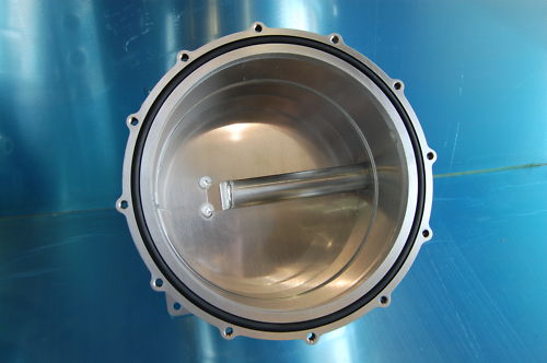

Bottom pic is the top of the tank. Filler neck's obvious, the other two pipes are the oil return which comes in at a tangent and centrifuges the oil to deaerate it. The pipe @ 90° to it is the vent. Pic at top right shows the outlet, detail of the pic up obviously can't be made out as it's on the underside of the pipe- typically a slot.
There's loads of ways of making 'em (no i'm not sharing detail pics of how i do it), some a lot easier than that allisport example off ebay and sometimes it gets a lot more complicated typically due to packaging issues... IMO ideally want at least 2.5:1 height-to-dia and sized for 1/3 of the volume to be air space i.e. 6 litres of oil = 9 litre tank. When there's no room for that end up having to shape the tank to suit the space and fit an air-oil seperator into it.

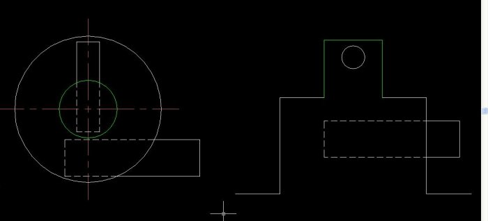

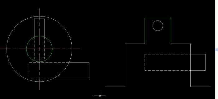

You don't really want a horizontal lip just below the oil return, the idea is to centrifuge the oil around the outside of the tank as it makes it's way down to help deaerate it. Dunno if this crude drawing of the top of the allisport example will help or not (between taking liberties with the layout, screengrabs to create a jpg and resizing the colours got messed up making it less clear)...
Both the vent and return pass through the tank wall, the former is terminated just short of the ID of the tank while the return stops past the centreline to spin the oil off the tank wall. The side of the tank acts as a baffle for the vent and note that it's positioned so that oil isn't getting thrown at it. Personally i'd say you don't want anything like wire wool or gauze anywhere near the thing. Didn't bother drawing any sort of lip where the top breather section meets the return stage, personally if using this design i'd have a vertical one i.e. the green cylinder passes through into the return section

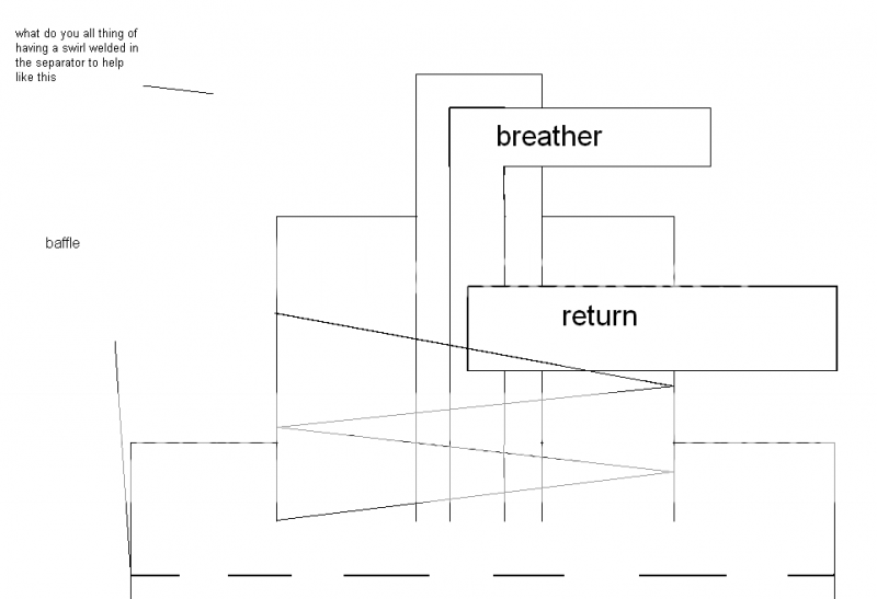

Which 'swirler' design are you basing it on, this one which would be difficult to make and overkill in many respects (it's for something far more complicated and much larger than a car engine)

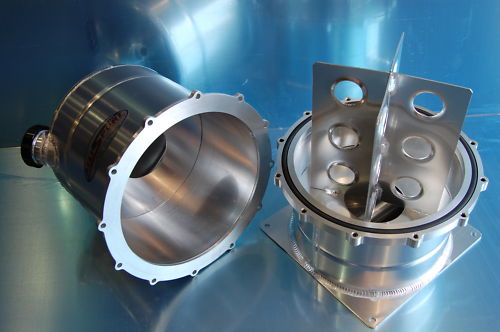

Or this Moroso example which is simple to fabricate
Although i'd offset the belled holes in the baffles so there isn't a direct 'line of sight' through them. Moroso notched the two lower baffles so the thing can be assembled
I realise it's probably a result of the rough sketch but you're drawing has the oil being deflected upwards. Centrifuge it off the tank wall and then have horizontal baffles or a swirler sitting a little lower to help as the oil loses energy on it's way down
Like i said, it's a bit overkill. Most important bits...
1. Decent size oil return that enters the tank at a tangent like the drawing in post #10 to centrifuge the oil
2. The vent is designed so that oil doesn't get thrown out of it. Both the Allisport design and central vent with a swirler accomplish this.
There is no absolute right or wrong way, everything has pros and cons to it
