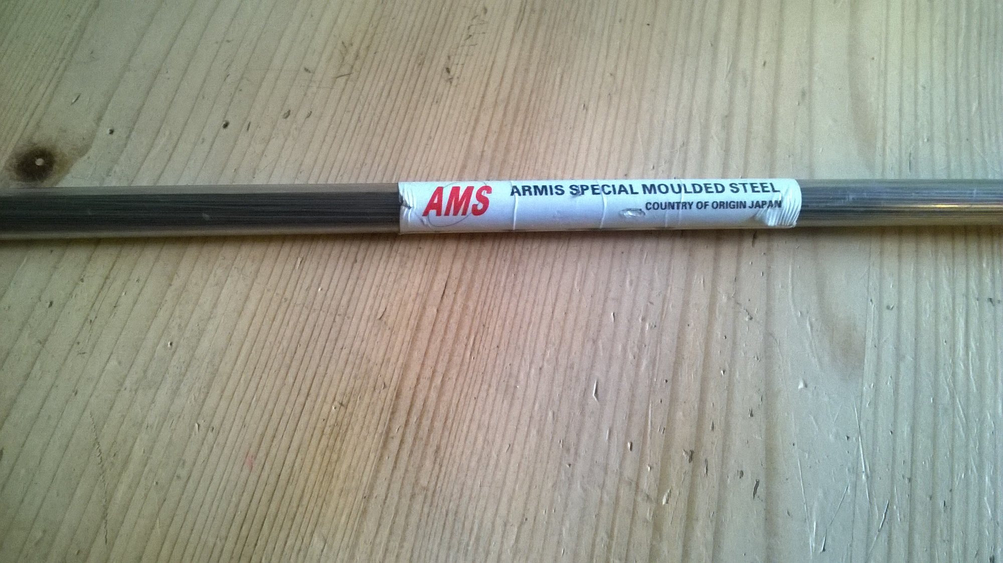

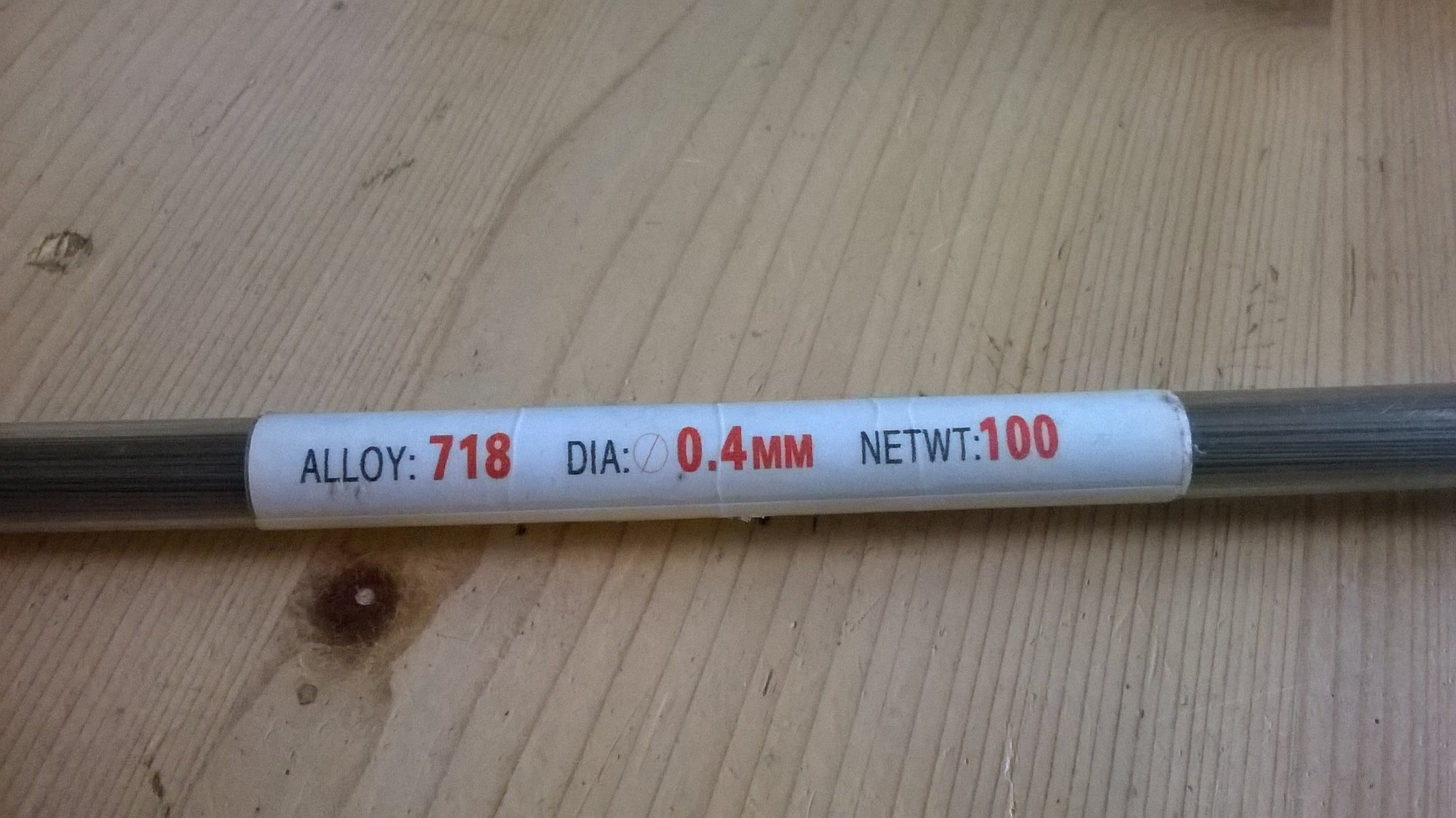

I /think/ I have some filler rod suitable if you'd like some Brad. It was bought as something else but it looks like it's Inconel of some sort:
I can’t say I’ve ever heard of that to be honest mate and google turns up nothing except results from a machining viewpoint.Its sold in bar form for the purpose, needs preheat with torch
