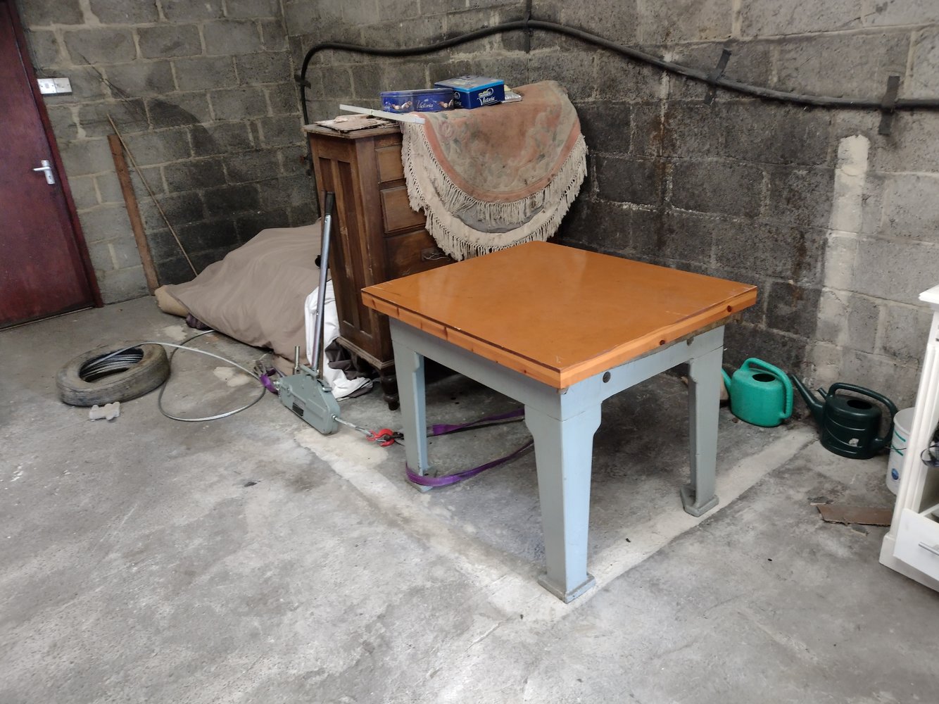

Ramps a good idea going to see if we can sling it and try the digger first, does look similar to ours, I do now think it could actually weigh more!I made a plywood ramp and winched it out the trailer and into place for my very similarly looking table. It was heavy enough/shallow enough angle that it didn't slide on it's own. Surprisingly heavy. View attachment 437969
Nice tirfor, I reassembled one of those if its one of the polish ones because it had jammed but easy to work on. The metal skin over the ply is to let the legs slide with gravity. If you want something NOT to slide, then metal on ply is a good way to achieve that. We put ply cutouts between the machine skates and the machine to help keep them located as otherwise metal on metal they just skid out at the wrong moment...I made a plywood ramp and winched it out the trailer and into place for my very similarly looking table. It was heavy enough/shallow enough angle that it didn't slide on it's own. Surprisingly heavy. View attachment 437969
Nice tirfor
