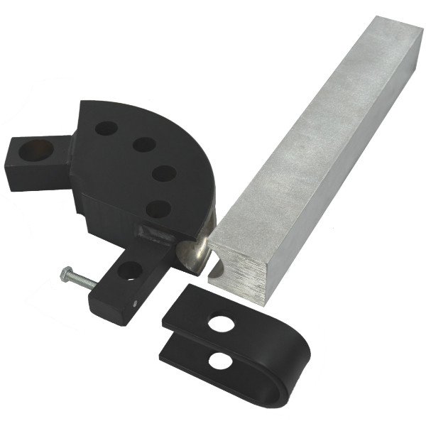

Hi guys, I've recently built a tube bender from plans I bought from 'engineered to slide' it's a vertical bottle jack style bender that uses pro tools Portabender dies. But when I try and use it it gets to the point just before the bend should begin and locks out. If I push it further it bends the plate under the die follower.
I was hoping someone on here might have built something similar or had a problem like it.
I've made sure the pivot points are greased, I machined all the pins to the right sizes (triple checked that lol)
Any help is appreciated, I've been a long time lurker and seen a lot of people helped out on here so I thought it was worth an ask
Kind regards, Jed
