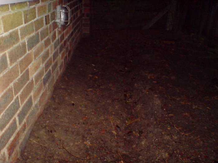

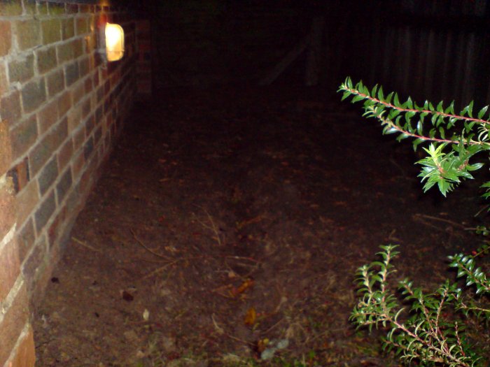

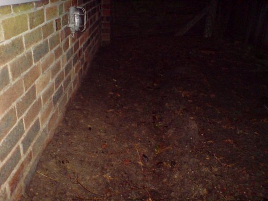

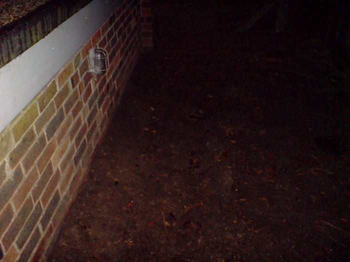

looking at the diagram ure stuffed without digging round. best option would be tank the inside walls and floor look up www chemical building products on google they sell cbp tanking slurry 25kg bucket mixed with sbr bonding agent .where the wall meets the floor u can get fillet seal and rapid setting plug for pressure aerias where floor has running water probs the whole lot will cost about 100 quid. its used for tanking cellars and it works hope this helps
4got to say there technical tel number is 01202601701
