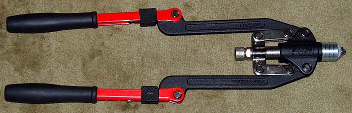

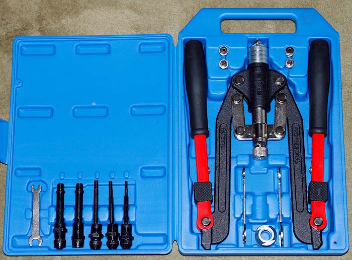

I'm very happy with this unit. Handles rivets up to 1/4" alloy+steel and nut inserts from M4 to M10. I haven't used M10 inserts yet, but M8 was an easy job.
They run for about 60 to 70 GBP on ebay. I guess they're made in China, nevertheless I've found no reason to complain, fit & finish are very good and - to my amazement - even those stamped spanners fit precisely.

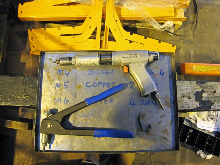

Bought a set today. Big long handled afair. Closed-up 20+ M12 steel nutserts in the shop to give it a good test. On offer at £125 with a load of inserts thrown in for nowt. Should have been £250. Seems a good tool. Forgotten the name - i'll look tomorrow. Bought from a reputable engineers merchants - they don't sell crap.
Thanks for the pictures/info fellas.
