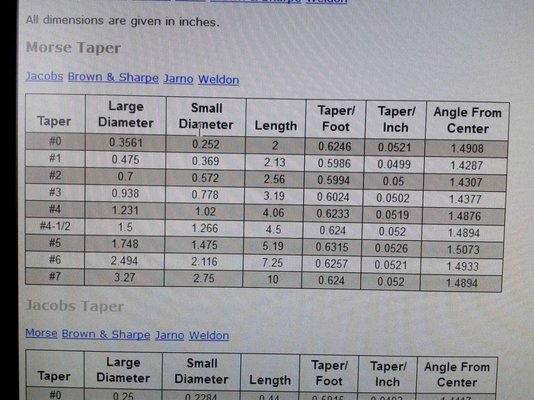

The question is:
The taper on the inside of the headstock spindle is it MT5 (or MT6 possibly) or is it Harrison's own/another taper spec???
The reason for the question is I am in the process of purchasing another lathe and wish to check the spindles run out, and I don't think there's a reducing bush with the lathe for my test bar, so I'll buy one before I go, so I can test it.
Doubleboost do you have a reducing bush with your new 140 you could measure, please.
