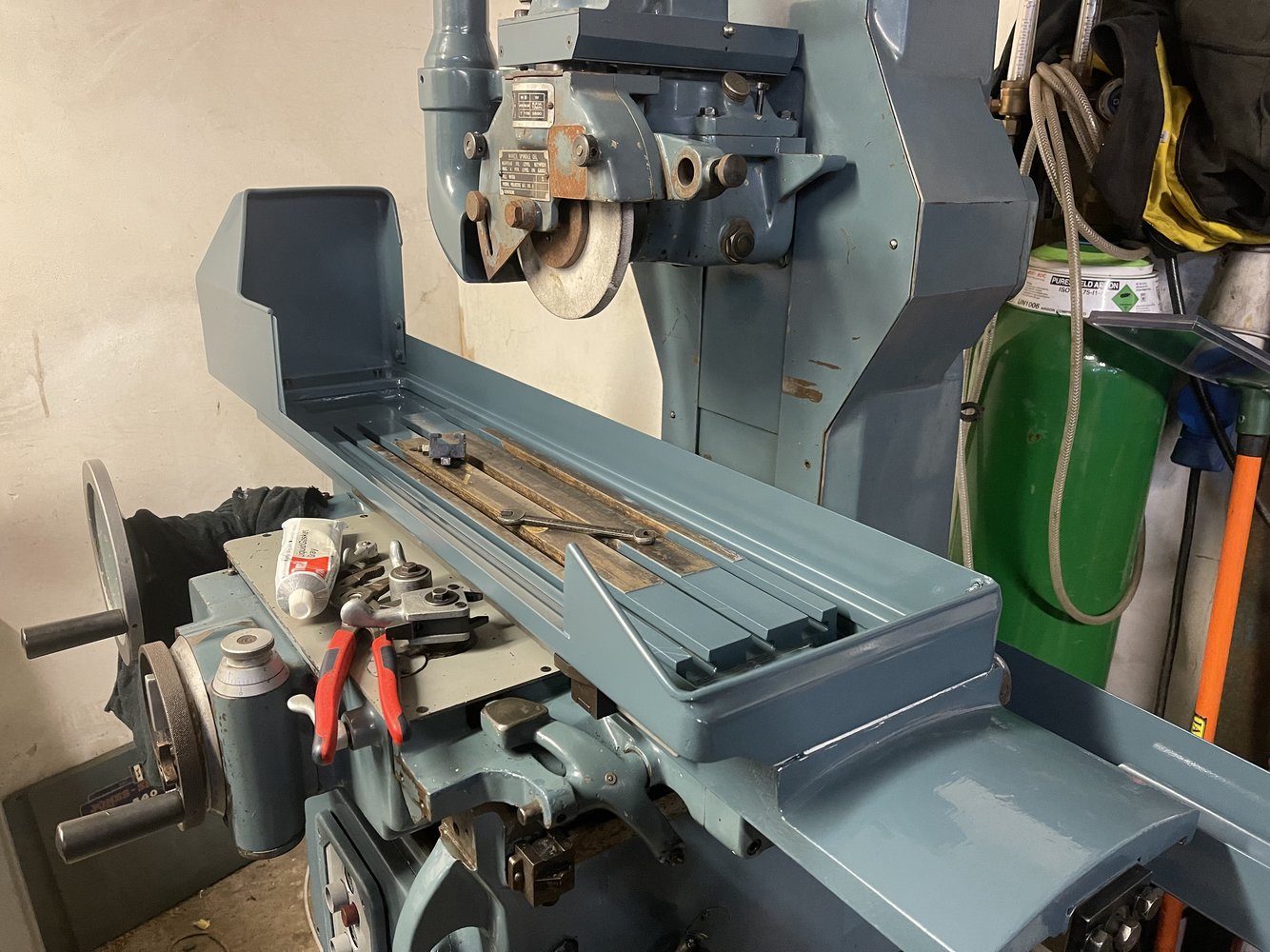

just done the table on the jones and shipman. not an exact colour match but is good enough for a 58 year old machine.
jones and shipman blueWhat colour was that you used
