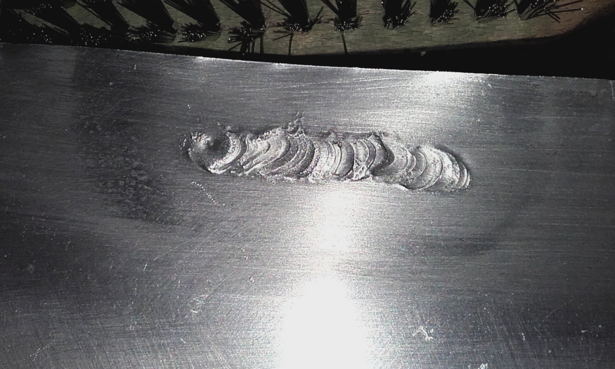

Hi - I've just gas welded some thin sheet aluminium for the first time ever! - deep joy!
I've tried in the past with no success. However recently discovered from this forum, that there are
GWF (gas welding flux) lenses, and GW (gas welding) lenses. I followed a link from here and purchased a Honeywell CV85/5w from Amazon £18.35 delivered (Note. Just the visor not the headpiece)
It totally eliminates the orange glare from the flux. I was so suprised, i tried my old gas lenses just to see the difference. You can also see the molten shiney aluminium. So happy i'm not going to buy a TIG.
