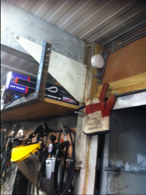

They are really C-section purlins. 200x65x1.8. Cut to width of garage. Length of 50x50x5 angle bolted vertically down the flat back of the C, most with a diagonal brace plate to stiffen them a bit. The lower end of the angle iron projects down the inside of the concrete panel a foot or so. Two galvanised coach bolts through suitable holes though the face of the panel. Basically scaled up version of the original angle iron rafters.
I used the 40 angle bolted along the tops of the concrete sections to stiffen the wall in-between the purlins - the purlins link the two sides. Wall plate not directly connected to the purlin supports. Before all the bolts are tight, both sides wobbles nicely together ;-) When tight, its all very stable. Used five purlins - one above the door bolted to a folded st.st. panel secured behind the front concrete panel (which was simply a full panel cut down slightly offset to center). Door tracks bolted to the folded section.

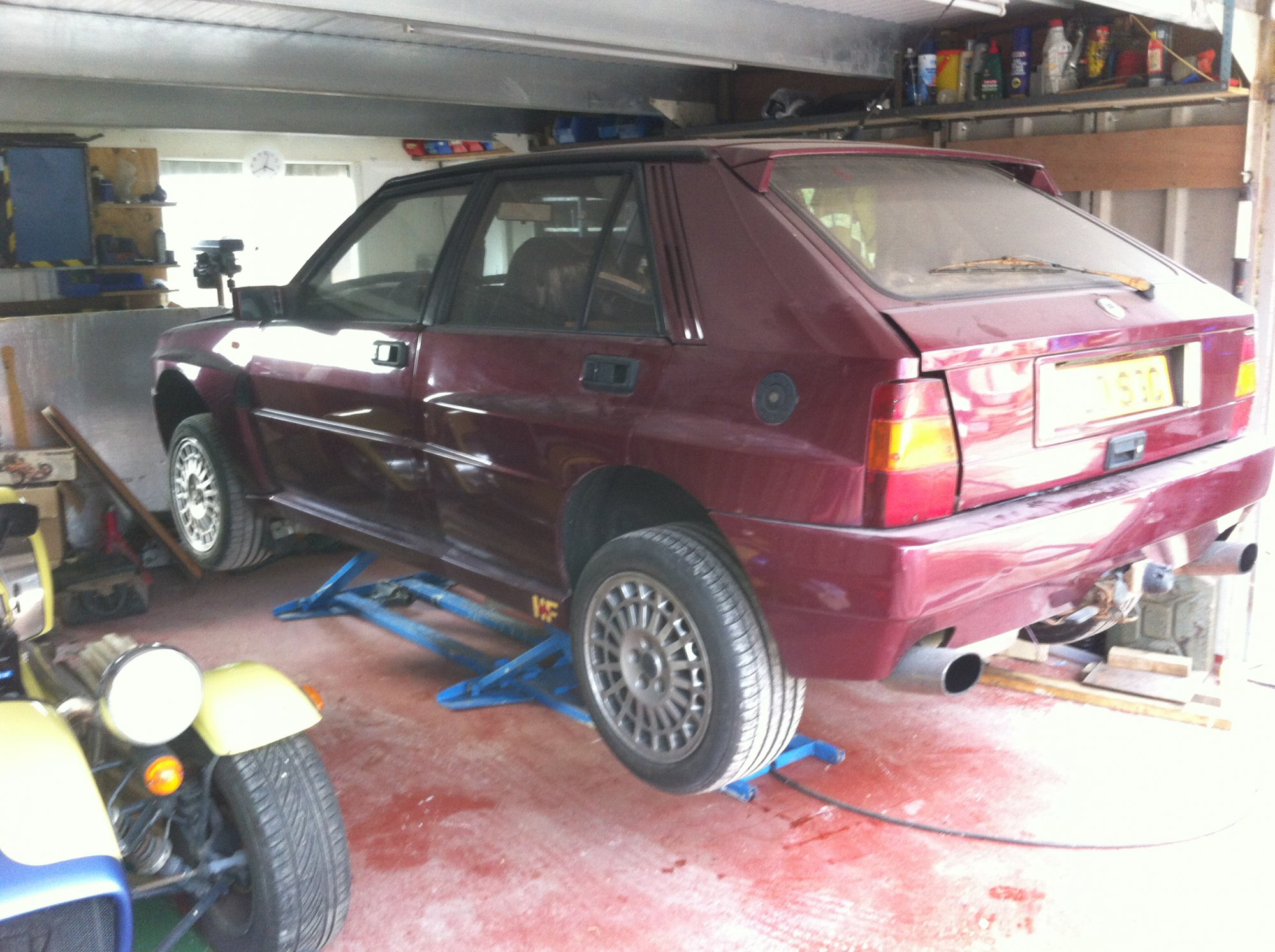

One side and the back of the garage were re-used from existing single garage and another one I took down close by. Final side were seconds sold by a different garage supplier - simply drilled new holes to line up with existing panels. Sides went up and roof on in one short winters day after removing the ice on the pad - those panels are heavy and slipping didn't bear thinking about!
