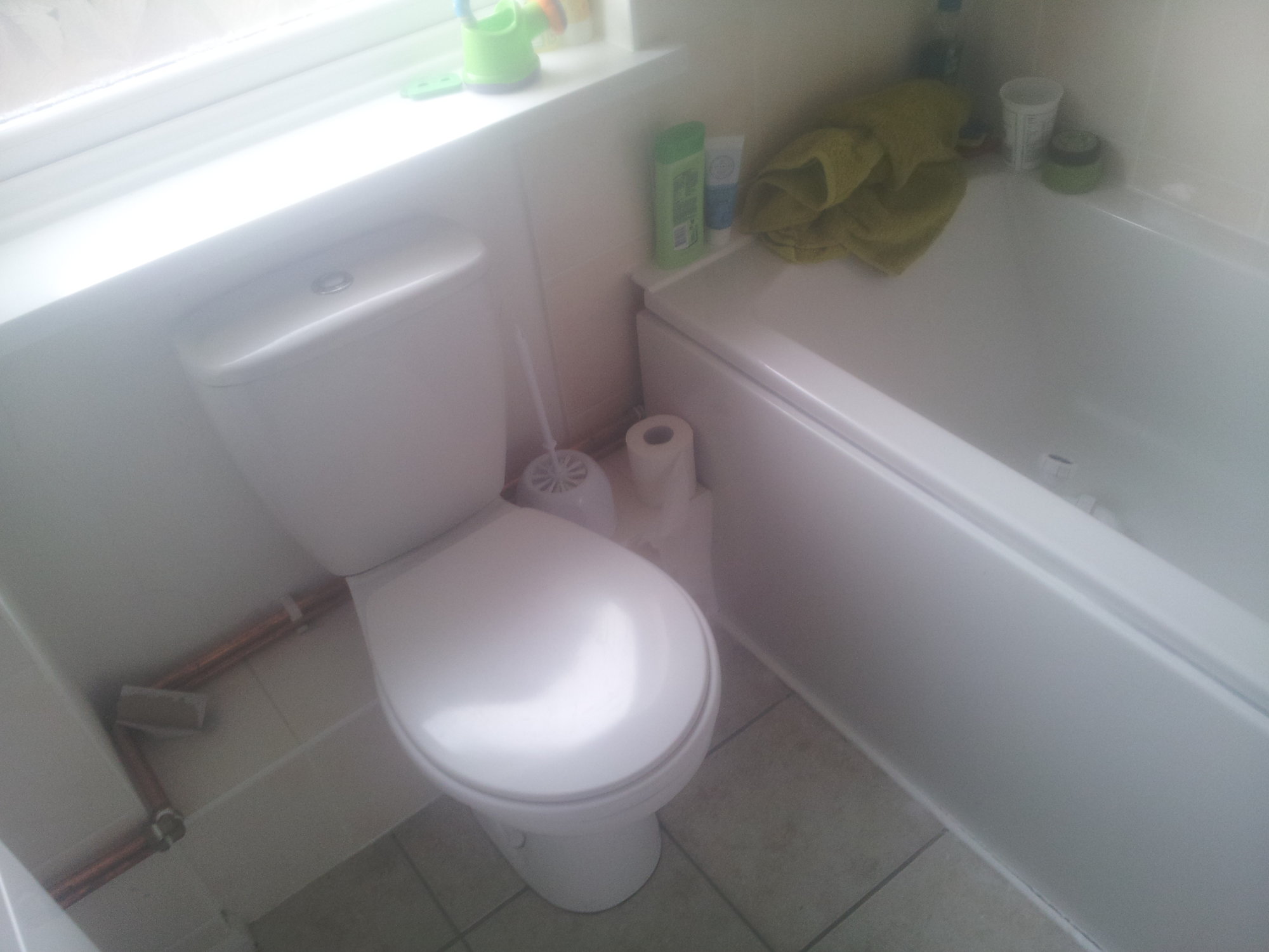

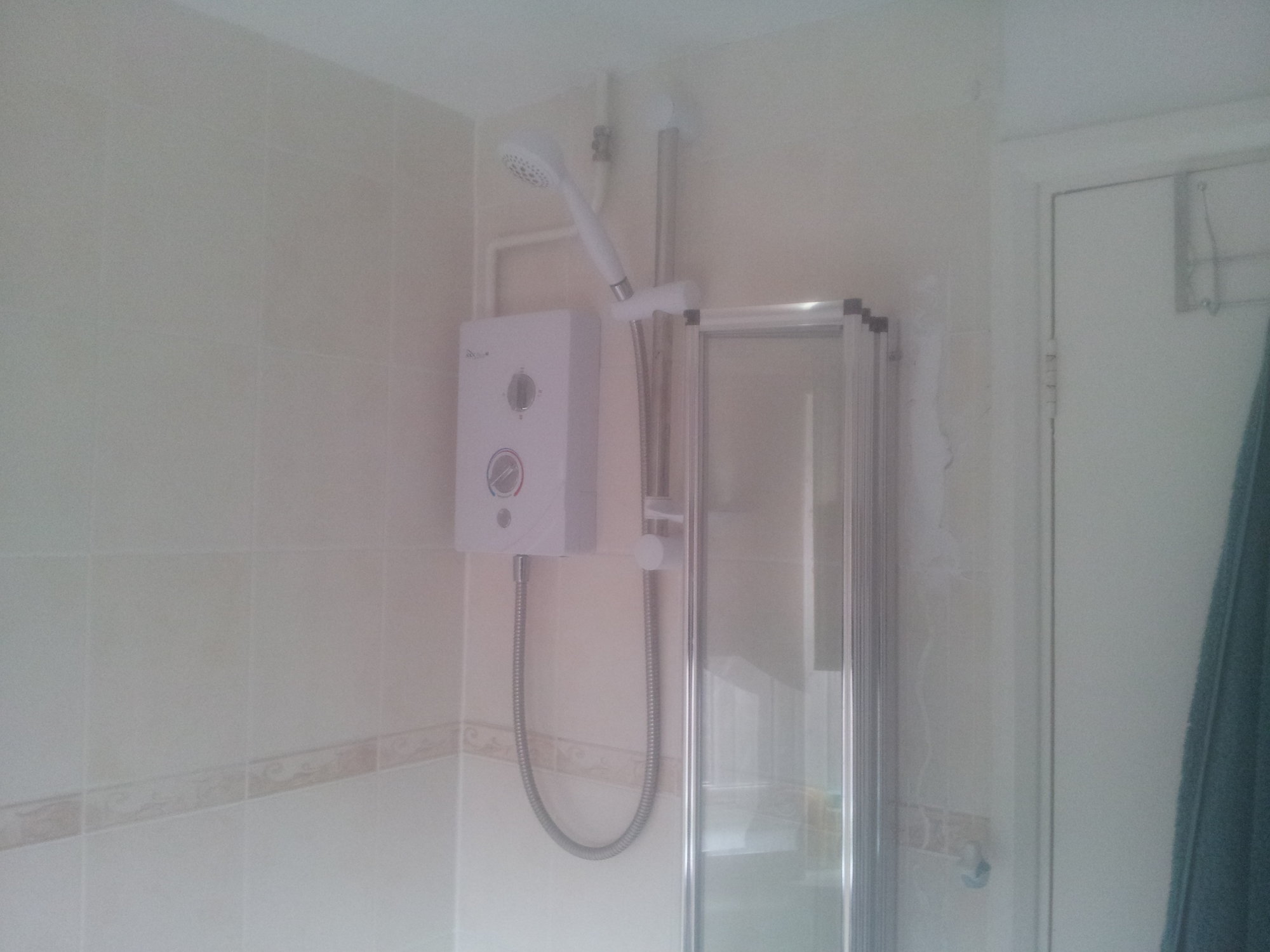

Remove shower and raised floor. replace tiled floor

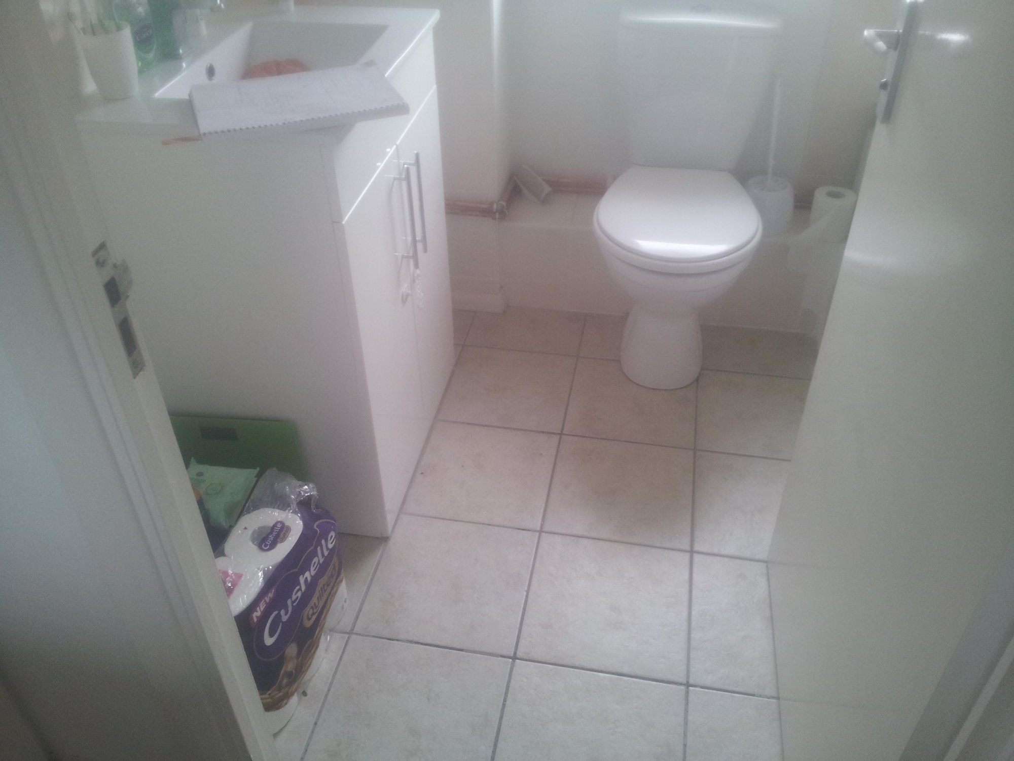

Remove boxing behind toilet and route new pipes for bath.
Cheap price but they knocked the tiling off. Then quibbled about the price of bath. Extra wide to overlap exsisting tiles. Got fed up and binned it.
Get a call November.
Can I fit there bath. Sorry booked till mid jan.
3 weeks pass and I recieve a very apologetic email asking if I could put this right.
Nice surface mounted pipes that blendbin well.
Turned up to look found sink leaking.

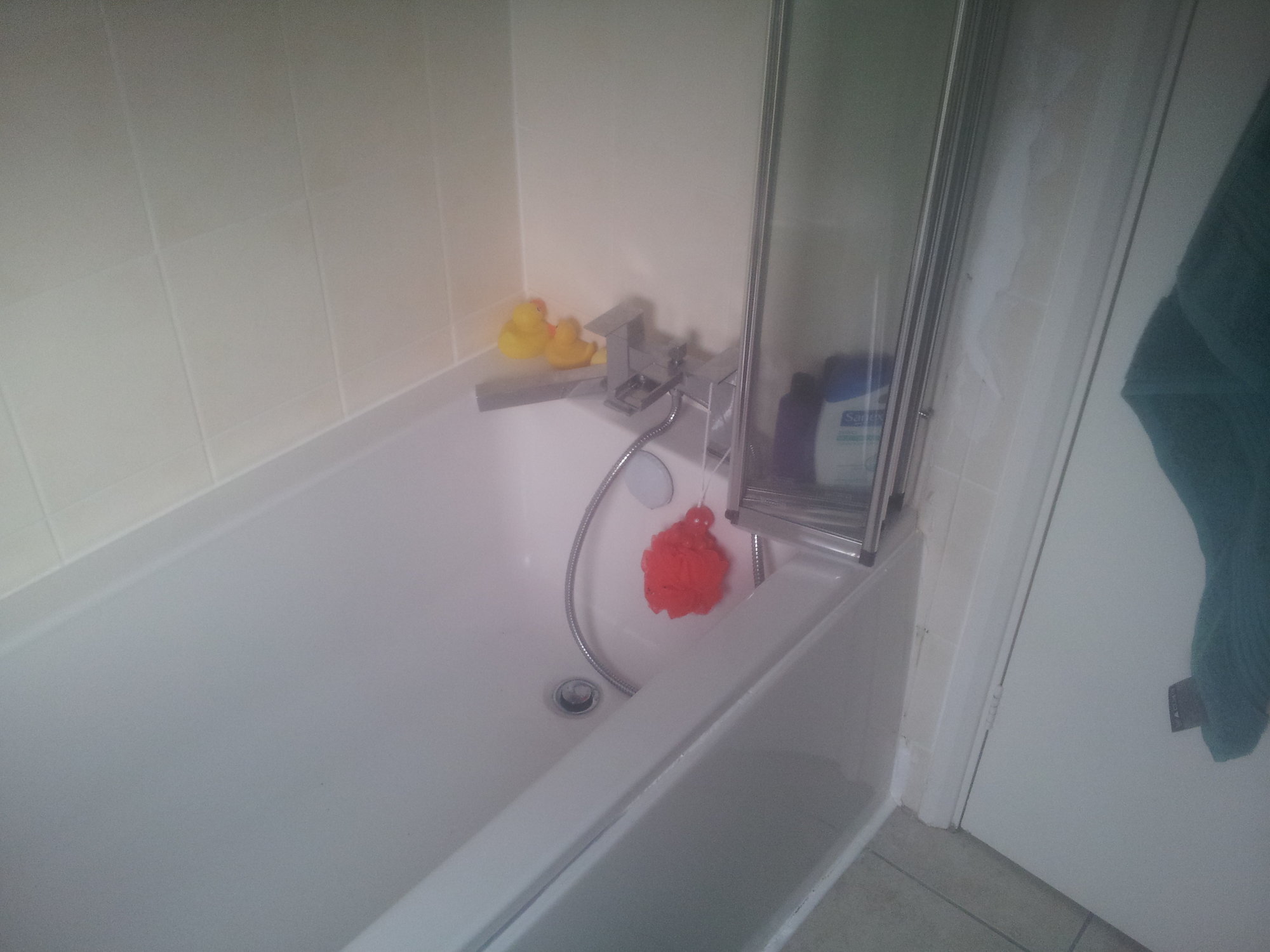

Where they pushed pipes through they were putting the waste under tension. Oh and the waste kit wasnt sealing.
Bath wasnt draining as had a back fall.
Badly sealed and leaking through the taps. Found today they had been drilled too big and rubber washers were doing nothing.
When the old shower screen was removed they ripped tiles off the wall too and filled with lightweight wall filler.
Also used light filler to patch in the 40mm gap between tiles on the floor and the bath panep. (Why my bath was oversized.)
Completely stripped today. Pluming tomorrow. (AAs expected old bath feeds were hiden under the toilet boxing so easy enough.
Then fully tiling it.

New comp fittings were installed with large amounts of plumbers mate and ptfe tape
Blocked shower nozzles as its restricting all the joints and breaking down.
