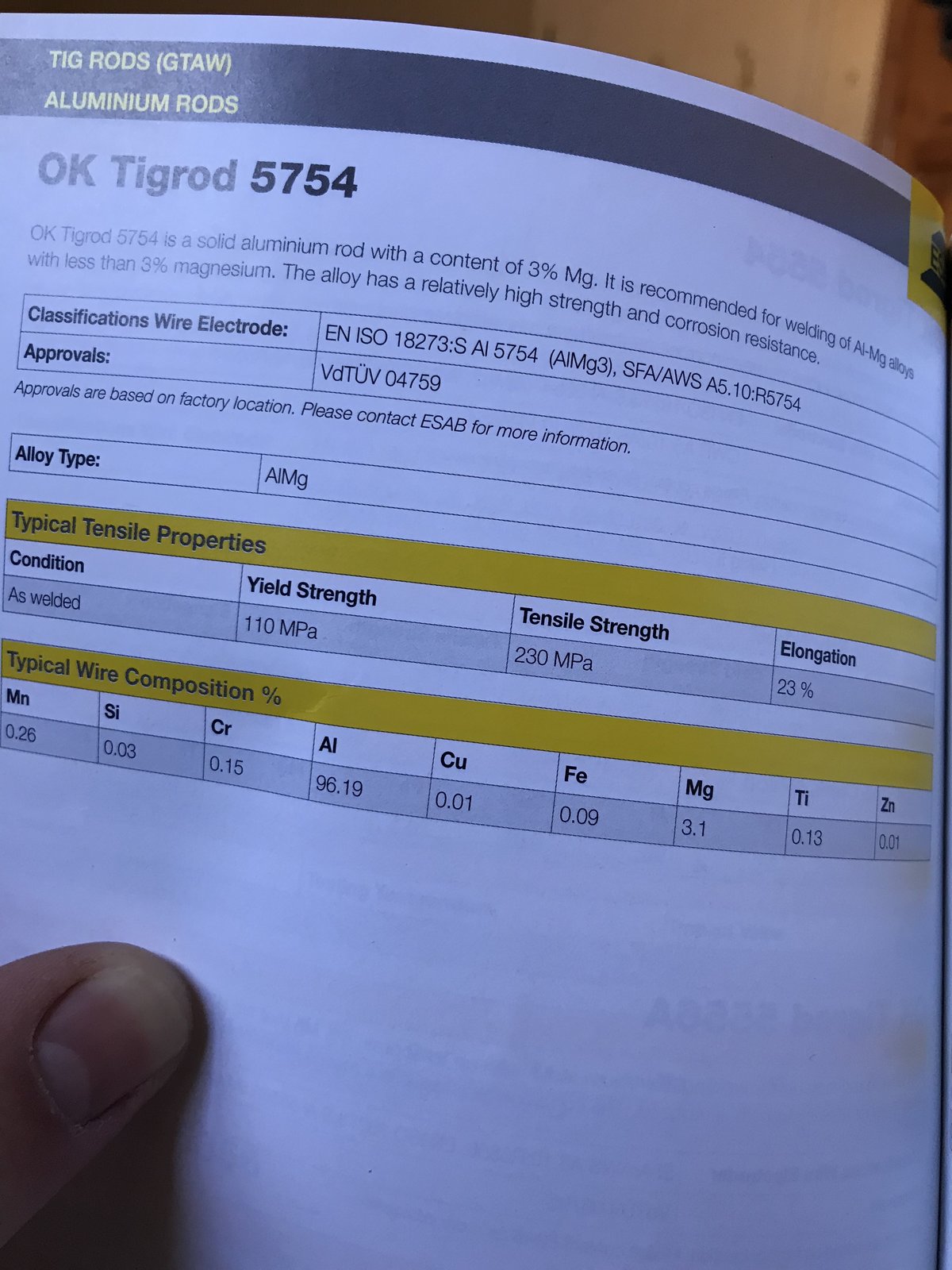

Can you recommend a online supplier for e 5754 tig rod I can't seem to find any one selling it5356 or 5754.
Esab make a like for like consumable ideal for welding 5754 to 5754.
For welding 5754 to a Al-MgSi alloy I would use 5356.
To an AlMg alloy I’d use 5554.
I was going to go to my local esab dealer to order them but it takes them weeks to get stuf inJust use 5356 it will work fine.

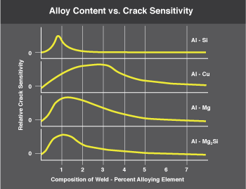

Wow mate. Spot on info thereThis is a very useful diagram here which originally came from ESAB iirc.
The reason there are so many filler alloys is there are hundreds of Aluminium alloys and getting it just a few % wrong can end up with the part cracking.
Your 5754 plate is a 5XXX series alloy. It will be highly crack sensitive in the region from 0.5-3% Magnesium. If you take the weld pool chemistry to 5% Mg, it's hardly crack sensitive at all.
So you may be thinking great why don't you just use 5356 for everything?
A number of side effects of 5% Mg occur.
- Excessive weld metal strength compared to parent material.
-Susceptible to stress corrosion cracking.
- Not suitable for high temperature service.
Hence we need alternatives.
Obviously 5754 there is a matching filler alloy with 3.1% Mg - just over the crack sensitive phase.
You could use 5556 as backpurge suggested - its a very high strength alloy and has about 5.0-5.5% Mg taking it well past the crack sensitive region. What I would err on the side of caution with is the amount of manganese though.
Best thing to do would be weld some coupons put them in a press and do some fillet breaks and some butt joint bends.
