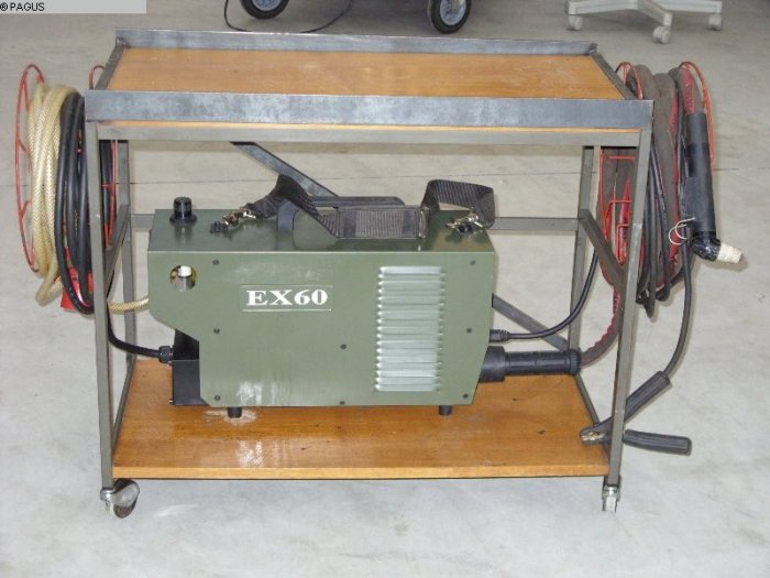

I have chance to buy plasma cutter named EX100 for low price. There is no any company logo on it. This one is in metal casing colored in green.
I suppose this one may be the same as yours. Can you or someone else to tell me experience with this plasma cutter? Is it worth to buy?
Also, please tell me, did you ever get circuit diagram for your plasma cutter?
This unit, which I've chance to buy are similar to this one on the attached photo. Only instead of EX60 it is named EX100. I found this photo on the internet.
When made by EWS in Italy these were, in my opinion, the best inverter plasma systems on the market. I sold them in the 90's, being their UK distributor after Hypertherm had stopped getting them badged under their name and marketed as the original Max series.
