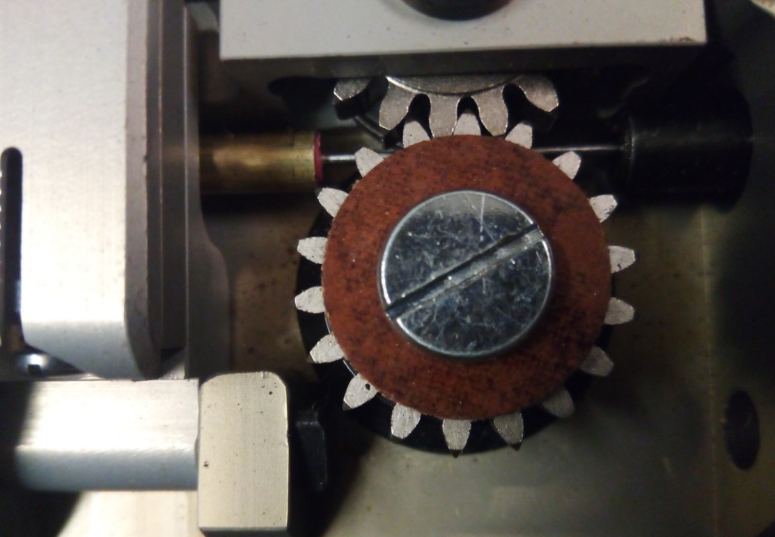

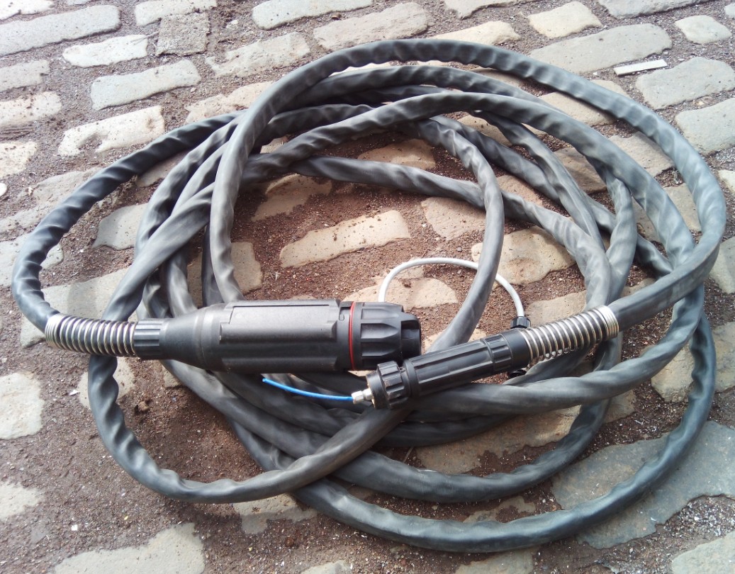

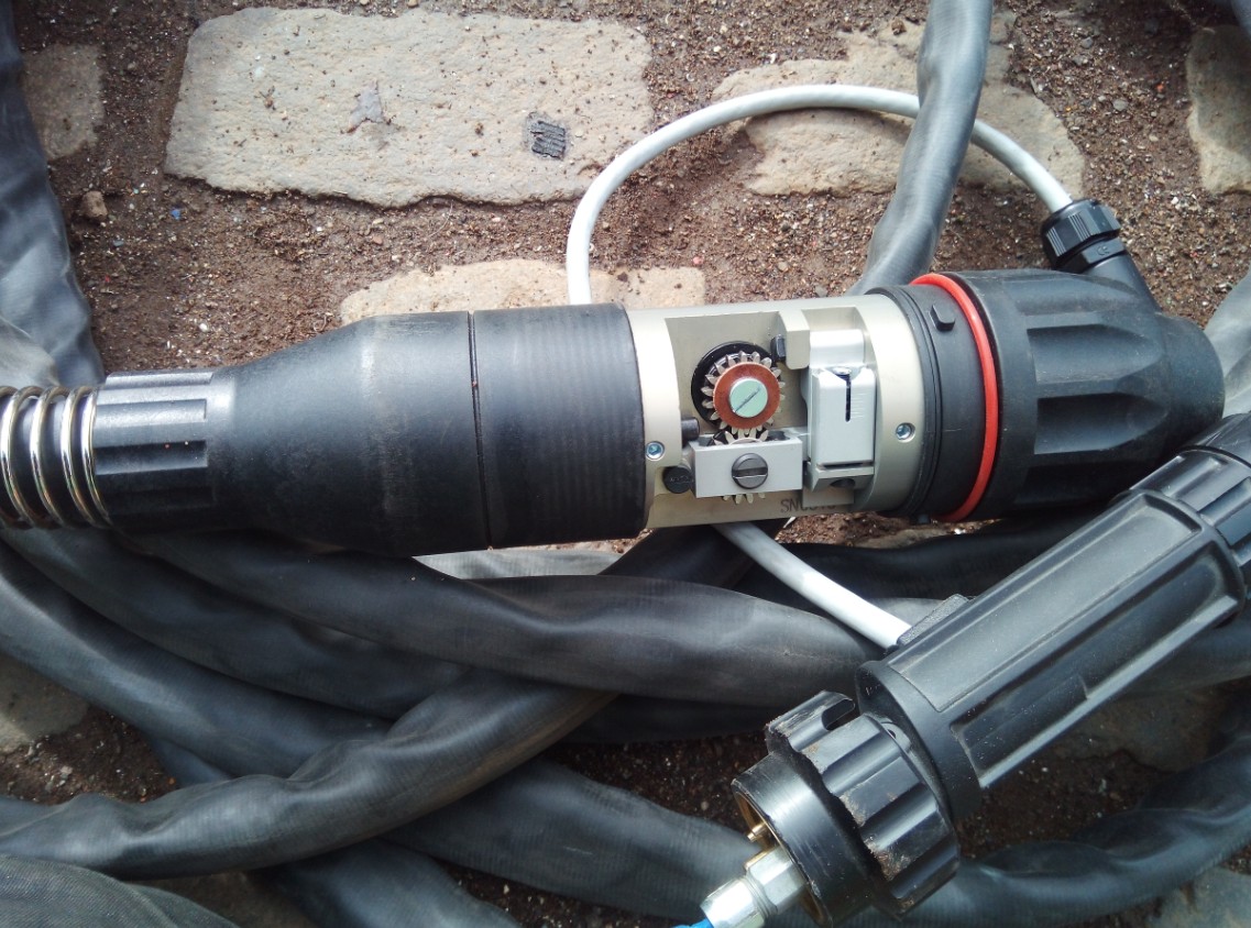

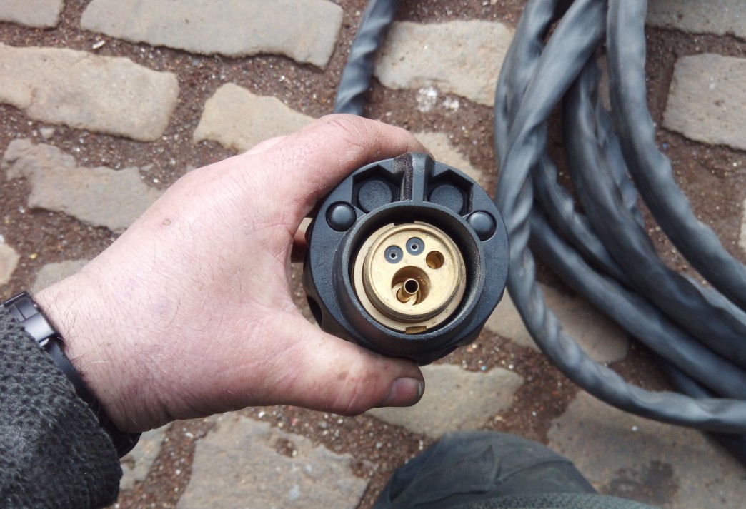

This project has been abandoned as I have just taken delivery of a very nice looking and very little used nano feeder
I need to fit a pot somehow to the end housing but there are 3 spare wires so not a big problem, just have to get a pot and some crimp terminals. I will also need to get an MB36 torch to fit this as I won't be able to use the push/pull on the end of it, or at least I don't think I will.

It is just an electric motor and some drive wheels and seems they are made by Mechafin, likely for lots of different welder manufacturers.Surprised lorch / EWM stuff is cross compatible.
Looks in good nick.
https://www.mechafin.co.uk/produkte/push-pull.html

LorchThats cool what make is it
Well it kind of does but according to the EWM manual, or at least my understanding of it, the motor current is monitored on both motors and the EWM alters the voltage fed to them accordingly and thus keeps them in sync.Does it not need to synchronize with the welder?
I still think you will need a 3rd party device for balancing the 2 motors but as I said before I am not a EWM expert, so perhaps Jim will be able to clarify.
I seen these used on a EWM machine before in Eire and they had a separate box (supplied by Mechanfin) to provide the syncronisation.
On the Lorch system the synrconisation is provided by a additional PCB and software, it wouldn’t work properly with our standard annolgue PCB for conventional push pulls. But again, perhaps it will be different with the EWM?

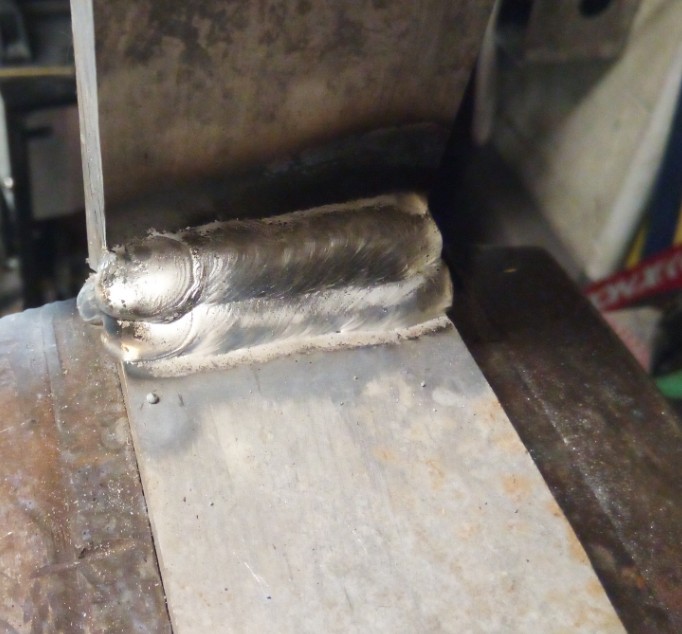

Sounds like the machine is struggling to maintain the arc length, which is a sign of mis syncronisation.
As a side issue, did you check the roller in the Nanofeeder? Is it marked with an A for Aluminium? Also, did you run the teflon liner straight to the rollers on the nanofeeder (which means you have to remove the brass caperilary tube) like on a normal eurofitting.
Also, next time you buy a new torch, dont get a MB 36, they are not great for Pulse welding as the neck gets too hot. Binzel do a Abimig 355 which is much better.
