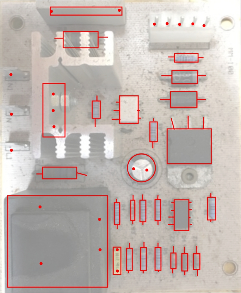

Tricky one that, Is there a relay on the circuit board? If so the valve will need to be connected so that it works with the relay, the easiest way would be to connect the valve across the relay coil, but that would depend on what voltage they operate at.
Any chance of a decent photo of both sides the PCB?

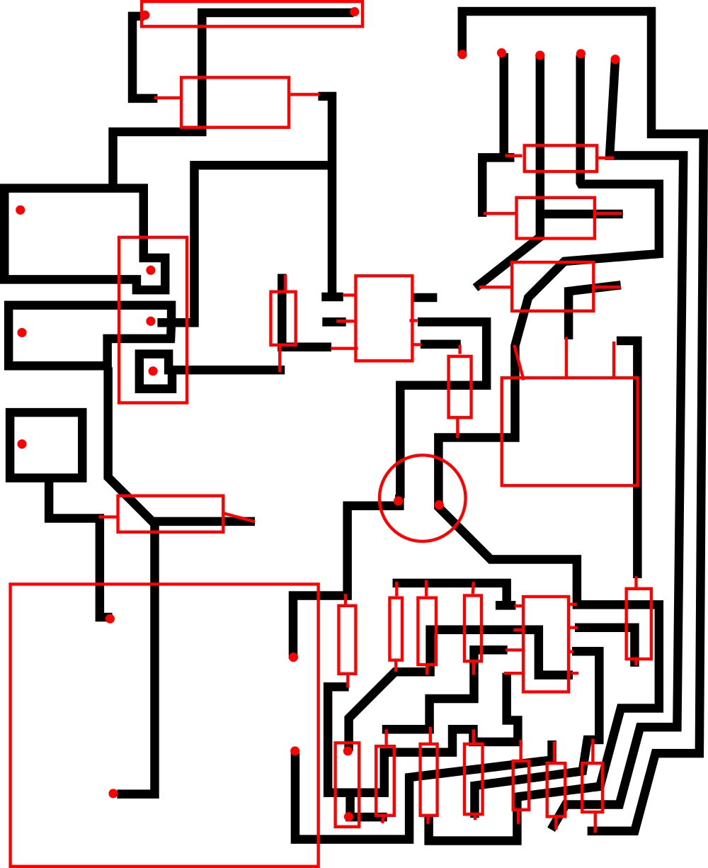

If it were mine I'd draw the circuit by reverse-engineering the PCB. If you could remove it (mark the wires) and take photos of both sides I might be able to do something.
Just been out and got some photos of the pcb, I can't hear any clicking but on the pcb the black block looks like a solid state relay but I don't know for sure. Both views of the pcb below are the same the 3 spade terminals on the left are the 6 pins on the left in the second picture
