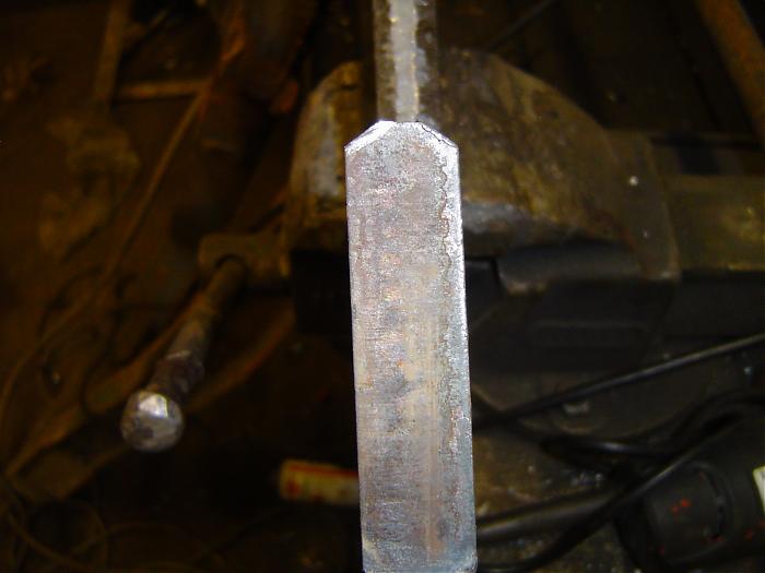

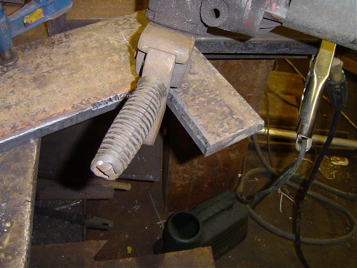

just thought id post a couple of pics up of the way i save time on prep, A shapper saves a mountain of time and gives you perfect 30 degree root preps every time, i have a couple both came from auction for under a tenner,

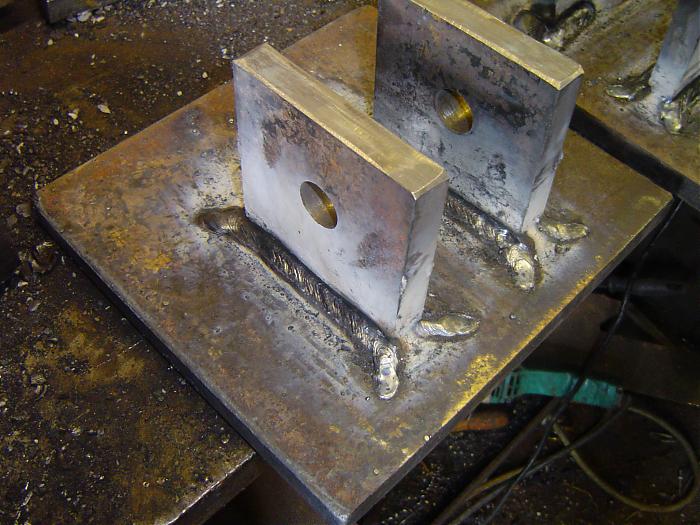

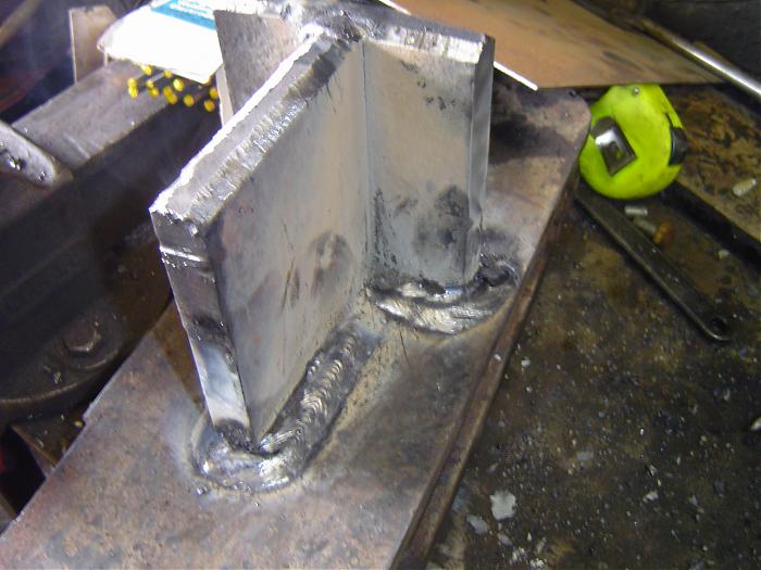

Also interested to know why, in the bottom photo, you take your welds away at 45 degrees, rather than turning the weld.

The 45 degree trick was taught to me by an old school welder, when your capping it stops you geting blow or slag entrapment in the corner as you know very easy to do when changeing direction I cap the ends first then fill over them carrying on down onto the work piece to get a perfect slag free T joint.
Yep MMA job, proberbly what you call a plate beveller, the guys at the auction called it a weld prep tool, and the box of dies has shaper on it? so dont know what the real name is, basicly si its just an oversized nibler with a 1500watt motor you bolt the correct packer in it for the size of meterial your useing the nibbler jaw ismounted at 30 degrees so as you push it along it just chews the edge of the plate off 1 pass job done. it will work about as quick as you can push it so compared with grinding its a godsend.
We used to use plate bevellers for prep, think it was a Trumpf make if i remember correctly, but the thing just bounced about and made a bit of a mess, making fit up of the weldments difficult. Just use 9 inch grinders now - You don't find a grinder easier?

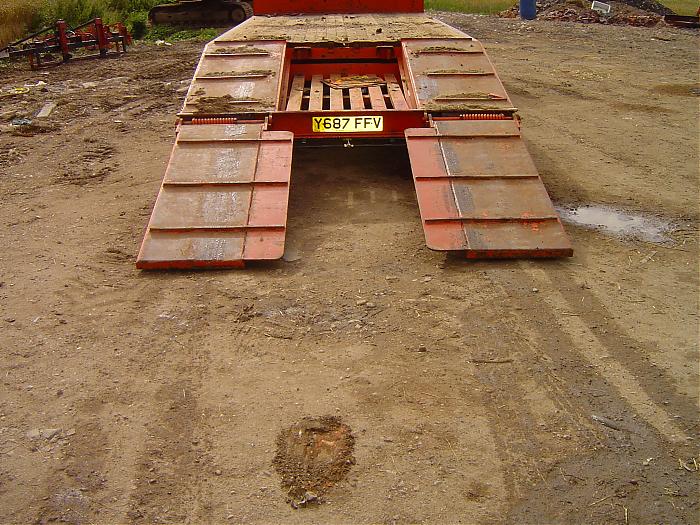

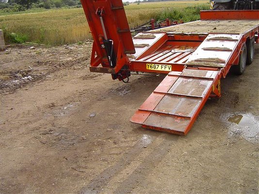

Iv got a lowloader in at the moment with sprung counter balance ramps which they want made hydraulic those lumps are the top clevis points, when I get em finished and working il tag the picture on the post, on anything good at the mo paul.

just thought id post up the finished job, It turned into a pig as i always find with hydralics, loads of protential clash points, but ramps go up and down and the cheques in my hand so all ends well.
Yes yes id trust you, mr drains, or weldequip to spot a mistake, the fairys came and slackend the jic adapter into the rod ends, It must of been them because i would have tightened it wouldnt I
cheers paul aww arr, yes its plumbed to plug into the aux spool valves, I wanted to put a spool block someware on the trailer so the traccccttttooorrrrr aww arr could be put into pump then the ramps could only be controled outside, but they didnt want to pay the money so f**k your luck if your standing near those ramps when they decide to drop em.
