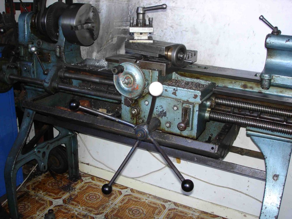

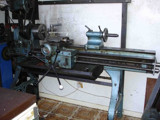

Thought I might as well start a thread on this now. A good portion of parts have either been cleaned up, oiled and stored away else cleaned up and painted, so there's at least the odd bit or two which is visible now. This is how she was when I got her:
Finally made a start on her almost two and a half years after getting her due to the fact that I could do with her up and running to sort a few bits for the large Rapidor, (progress on that has stopped until I can get this lathe up and running), which would be a push to do on any of the other lathes. Plus, she will take up less room, (something I'm seriously short of), when reassembled.

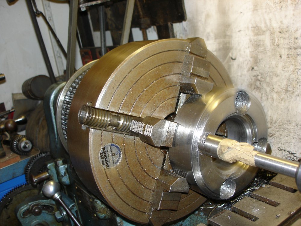

Had a devil of a time getting the chuck backplate off the headstock spindle, as it was rusted on solid and had a bit of swarf in the threads too for good measure, so ended up using a method which was suggested by a member on the Drummond list.
Could apply a bit of grunt to it that way without risking damage.
