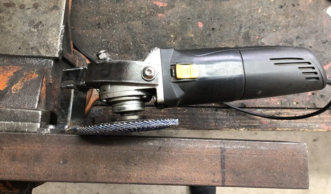

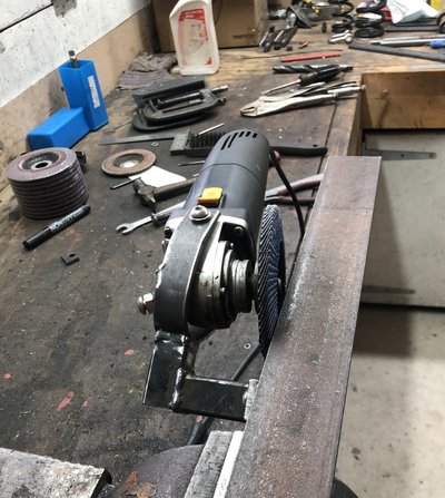

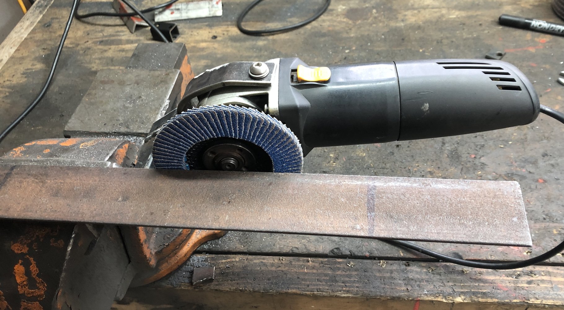

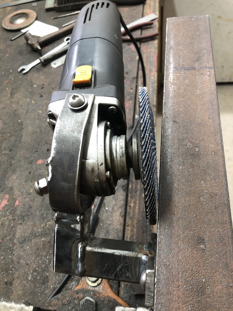

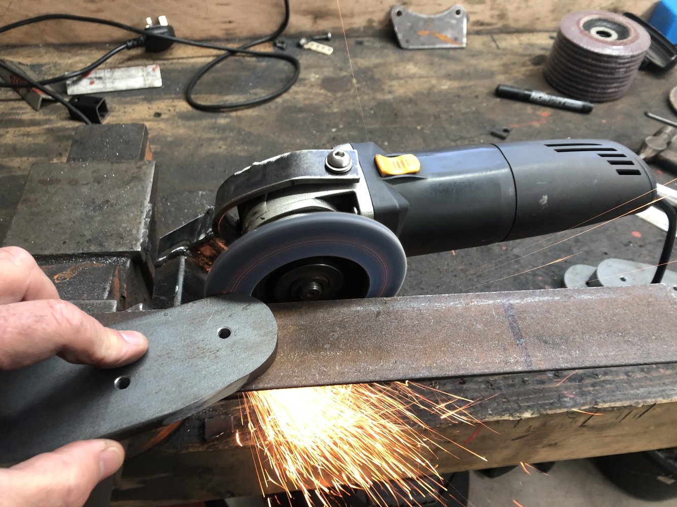

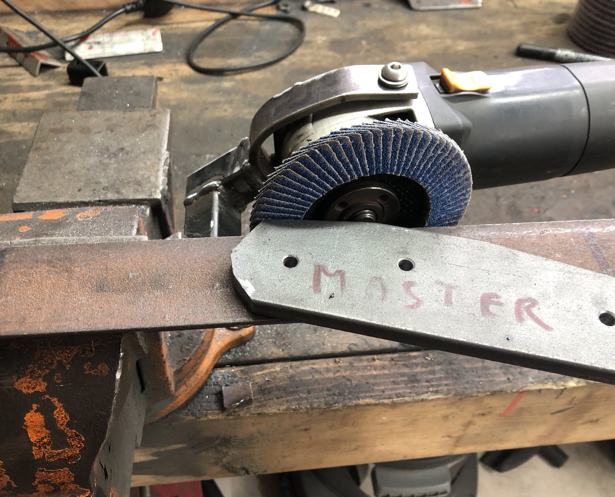

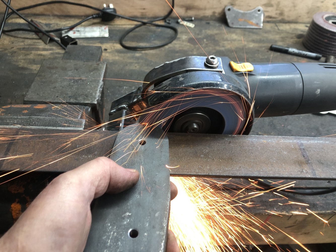

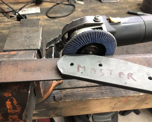

I’ve always wanted a linishing machine, the vertical belt type, just to make finishing small bits of metal easier.
So, yesterday I had a thought, and created a little gadget for basically smoothing and shaping little brackets etc.
It bolts to the angle bar, which doubles up as my welding table. So it can be removed, adjusted, spaced out etc.
Small screw fitted behind the gear head to make sure it doesn’t move. I shall put the guard back on and maybe even give it a shot of rattle can colour.
