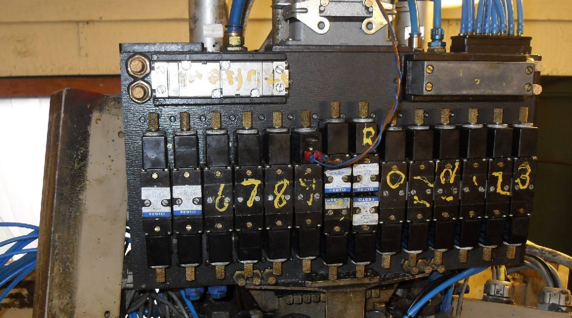

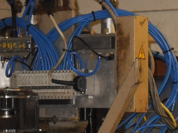

That is actually slowed down from the speed it comes from Chiron, the previous owner had damped the cylinders and I just kept it the same as I am in no hurryWow that tool changer is fast, compared to a carousel changer. Never seen one in use before. Looks an interesting build.

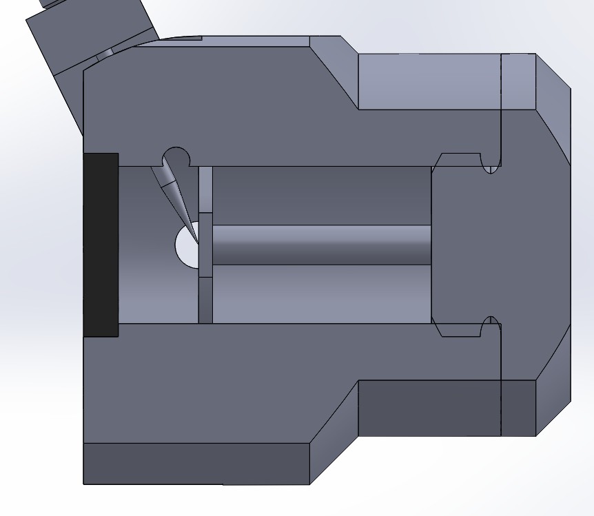

That looks like an interesting design, you can adjust the angle of the tungsten?

I am wondering if this could produce the two stage angles Richard uses. I know hudmut version was single cut but it looks like this one could grind the shallow angle first but then adjusted to grind the more acute tip angle?That's a lovely design for a grinder there, very inventive. Infinite adjustment on the angles.
I have a hudmut one which is a similar design but fixed to the 4 or 5 different angles
Nice to see a new idea Iv got something similar to your over head arm all done in soildworks all so Iv added a detent in there for a bit of repeatability. One thing I did learn from my grinder is the dust in threads is a killer and the finer the worse it gets for gargling that's why I did a slid fit on the to half's over a thread. Im not picking faults just helping with what I learnt as for drilling the bolts for guides on to fit all sizes tungsten's there is a lot to take in to account if you start making these for resale.

What's a hand held pendant?I am unlikely to sell them as I have plenty of other work and often turn down production work as it numbs my head
Thought about the dust, it is a 2mm pitch so hopefully course enough. I was thinking about adding detents but will wait until I have used it to see, fisrtly whether it is any use and secondly which positions I use.

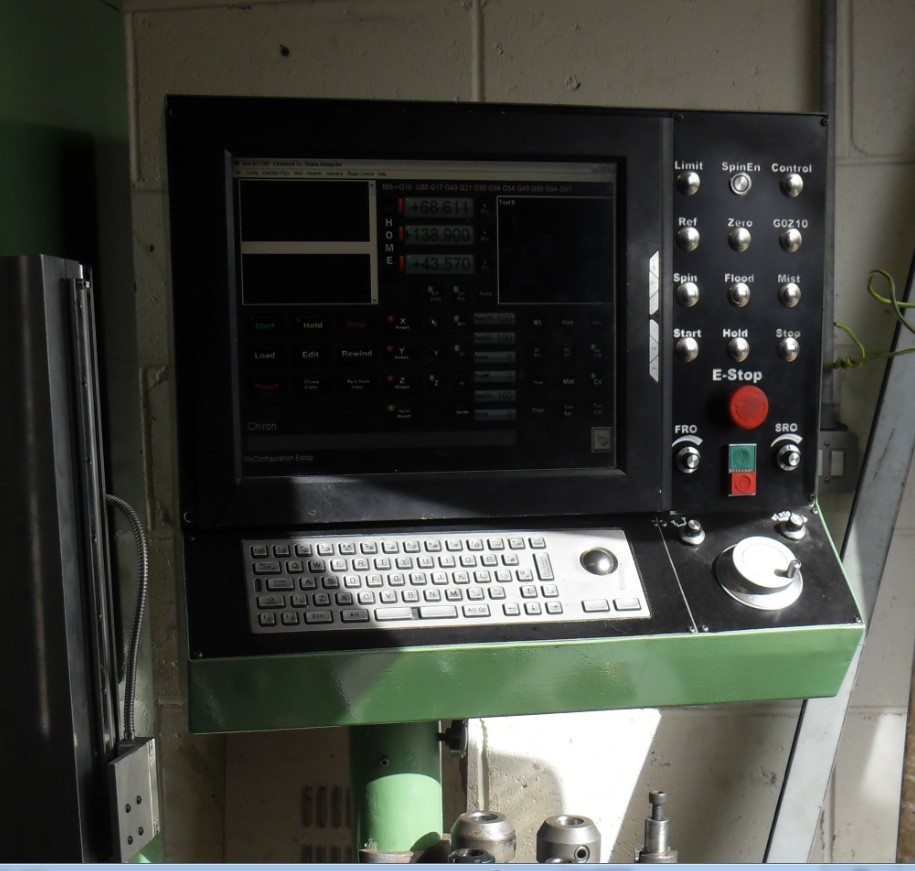

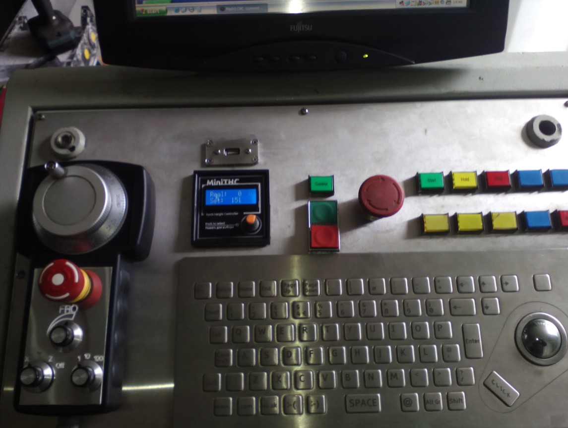

I have used the CSMIO's for years, best controllers I have used with Mach. On the Chiron and the wee lathe I just had the MPG and switches on the panel itself so no handheld required. On the plasma I made my own hand held pendant.
Pics below.
Chiron panel

Finally Plasma panel with hand held pendant.
