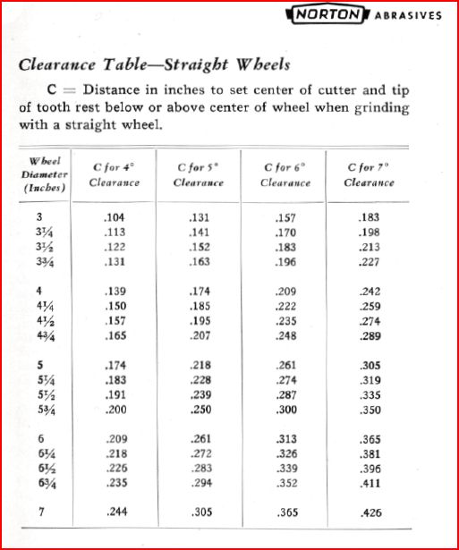

I spotted the stop after I posted. Lol but I was blinded by the fact he is grinding on a round wheel. But it's trying to get a flat on the end of the mill.It is adjusting the stopper, that limits the depth being removed from the cutter being ground.
OMG looks like paying someone to sharpen a few for me lolHe's not trying to get a flat on the end of the cutter - he's grinding a concave facet.
There are tables giving all of the 'heights above centre' for different sized wheels - here is one from the Norton hanbook.
Having watched this I am at a loss to see what is being adjusted by the Allen key.
