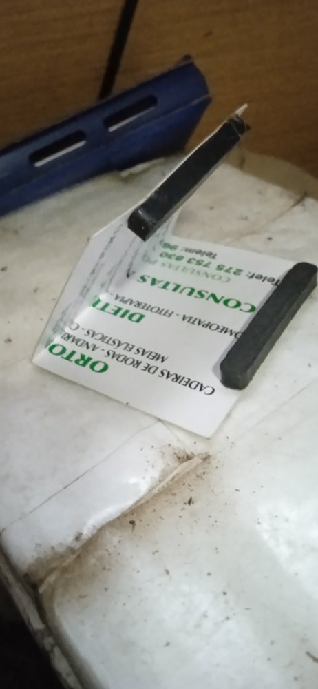

Oh, and yes also regarding the distance the magnets move but I was quite impressed by how far they do move apart even using the cheap little magnets I used in my investigation.
Here is a pic of my initial test:
I attached two small magnets from a fly screen to a folded business card. You can see that the field holds them at a respectable distance.
