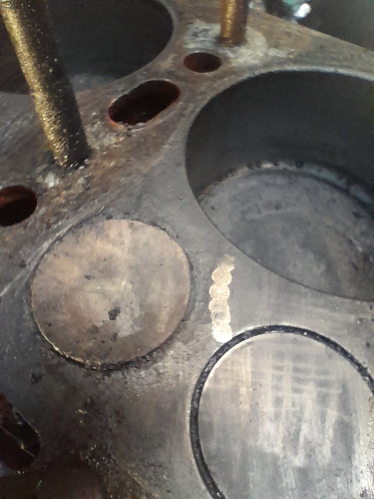

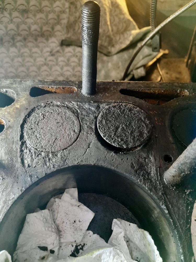

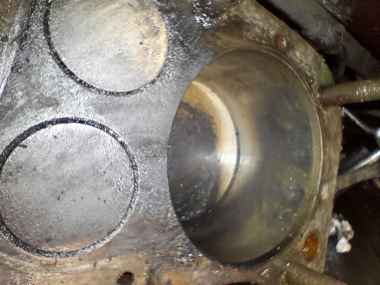

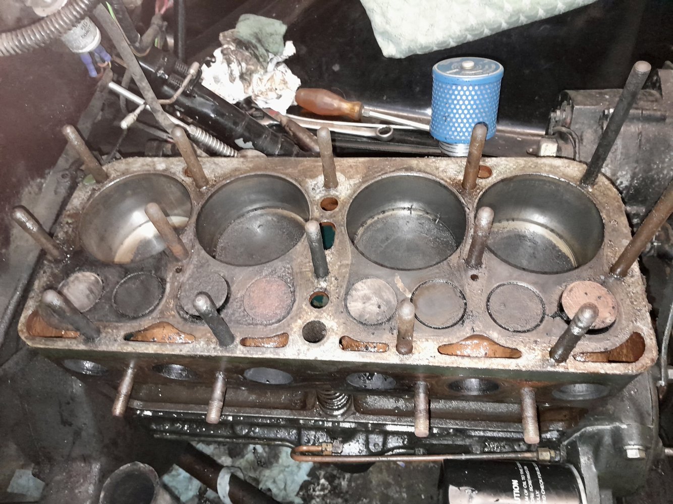

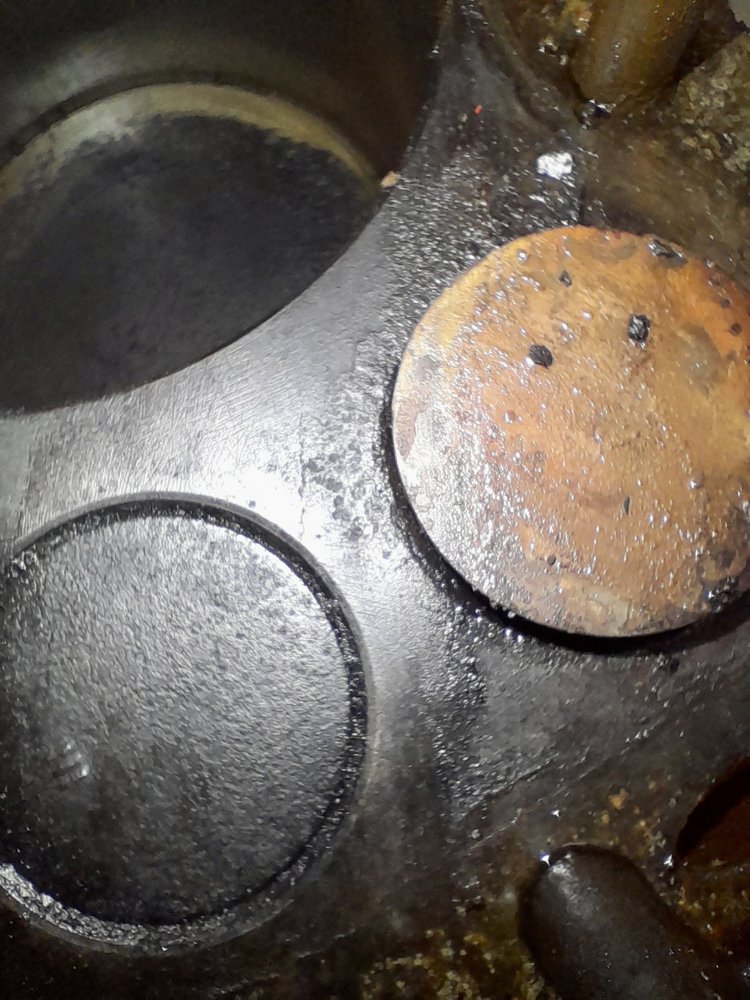

I'm having a go as there's nothing to loose, it's a rebuilt 1930s engine that then developed cracks and has been left standing for long periods, only ran occasionally. It ran ok but compressions were down so I took the head off, then almost wish I hadn't!
Rusty ring marks in the bores but a hone and new rings should do the job ok, there's no ring ridges at all.

Is anything leaking at the cracks?
That's a fairly low compression side valve block, if the cracks aren't active or growing then it might run like that for ages, presuming you aren't commuting daily in it.
What is the block from ?
I see the suspect cracks and the repair
but I would want to clean that up properly before I ventured an opinion.
Yes, if it's leaking at the crack, it needs a repair. Welding.
