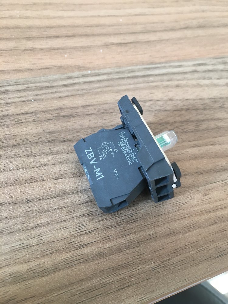

Amazing okay, and yeah 240v is what I’m after thanksKim before you buy an led block let me have a look here I think I have some spare - is it 240v you need?
I must admit I’m just as confused.
No probs, pm me your address and I’ll post it outAmazing okay, and yeah 240v is what I’m after
