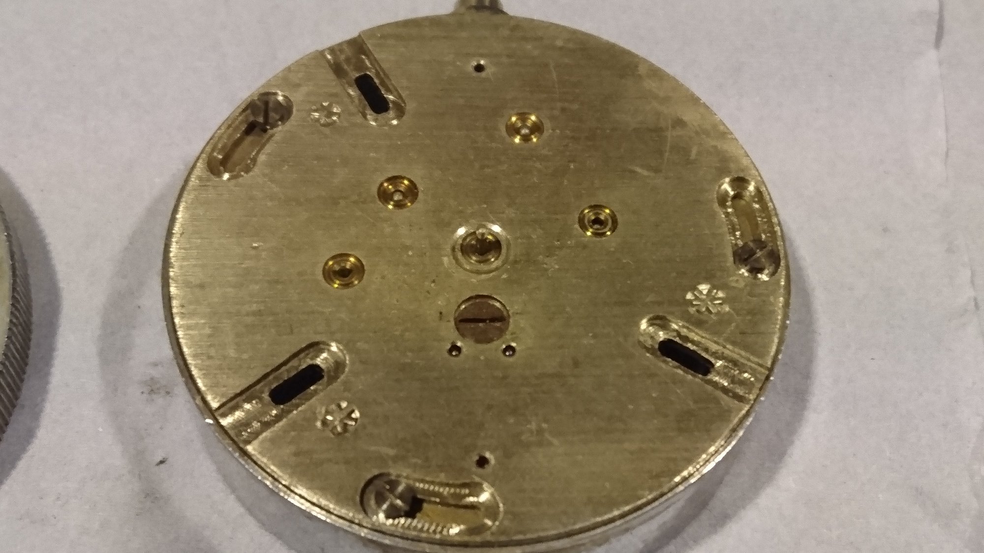

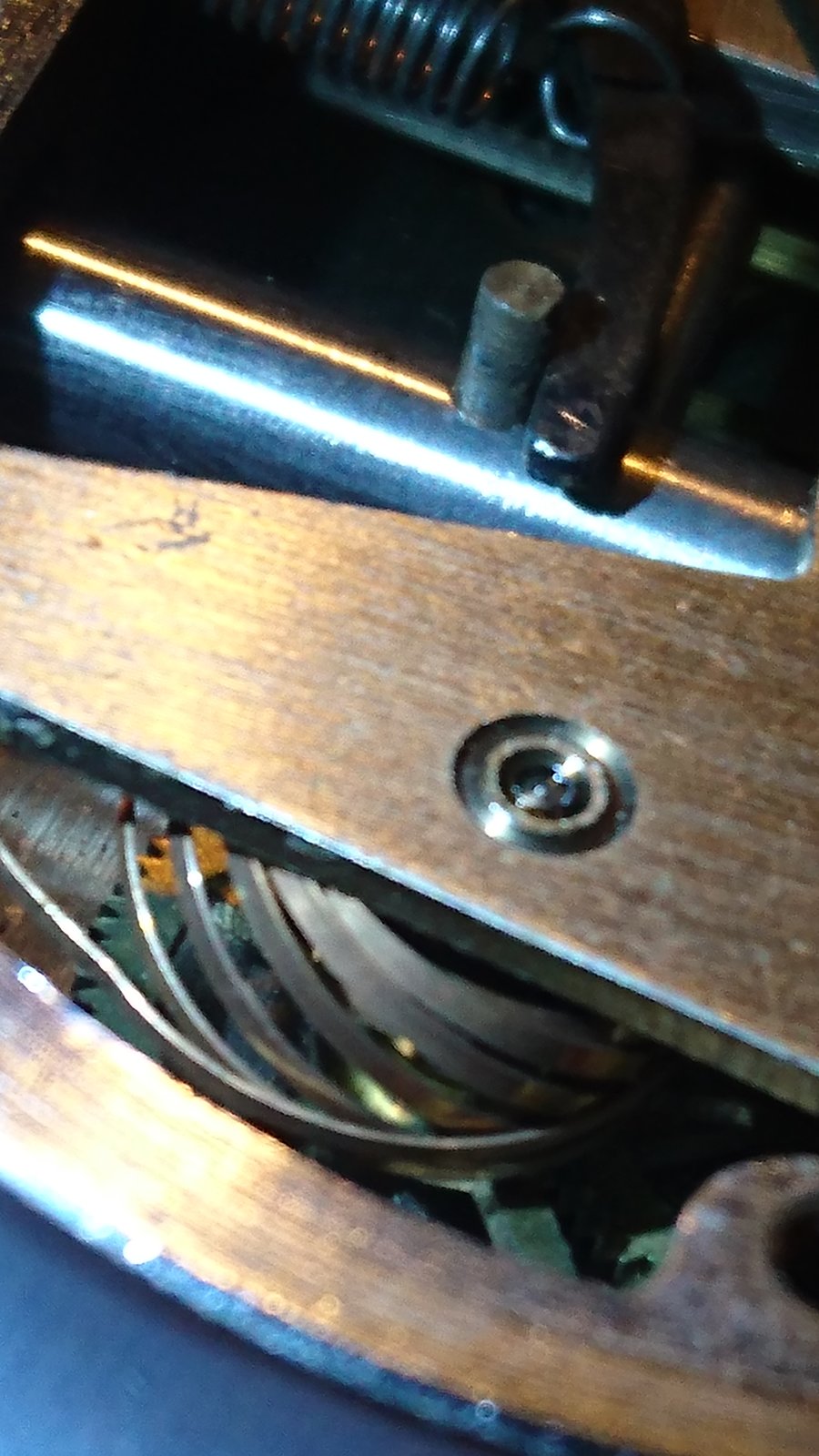

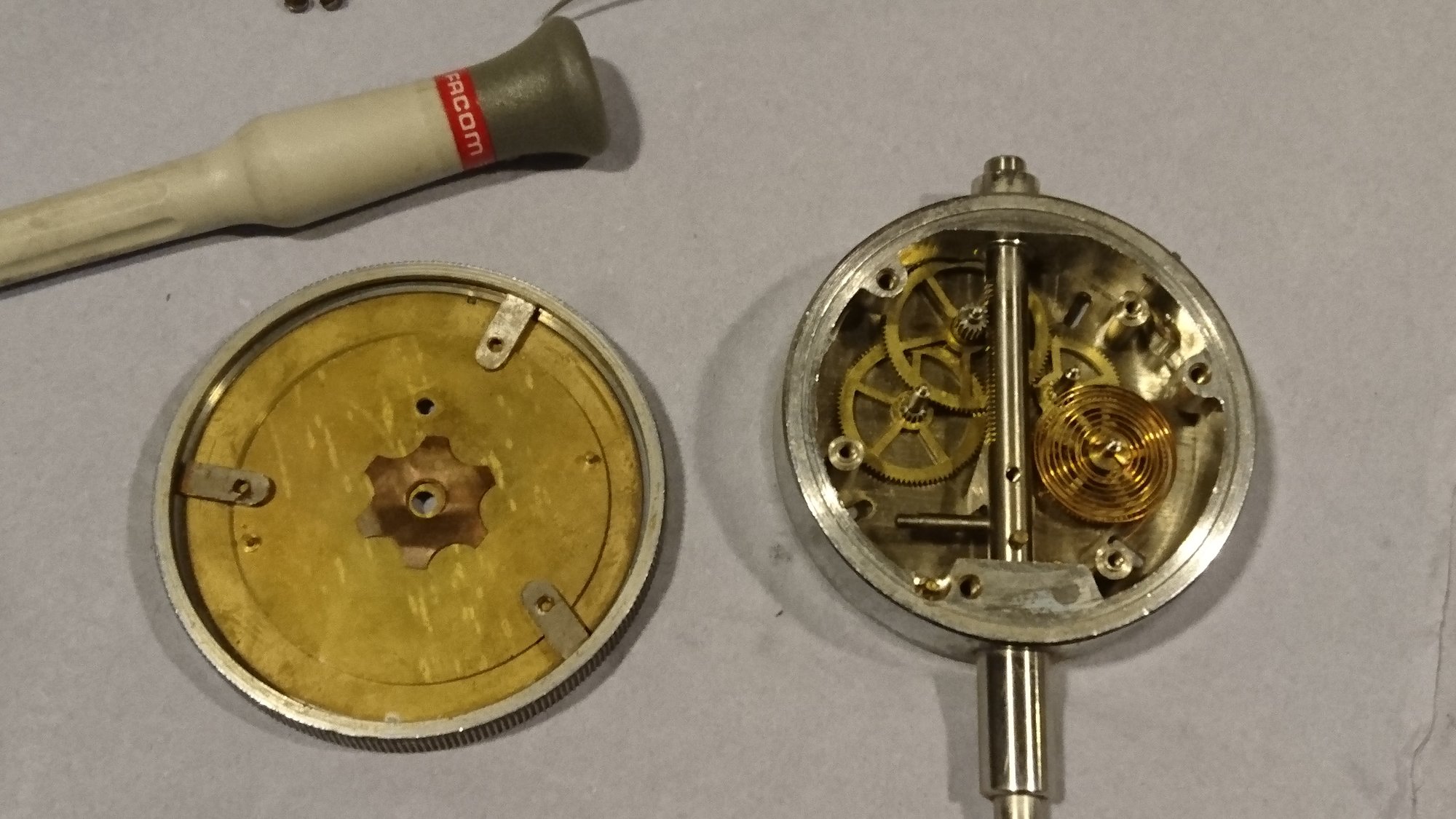

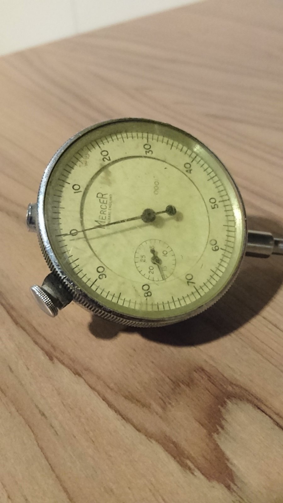

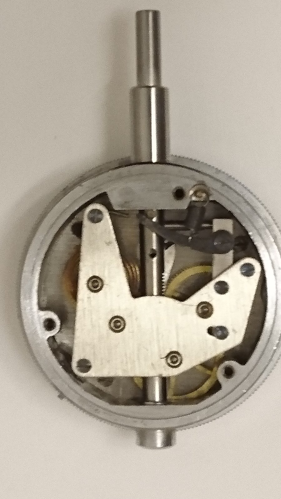

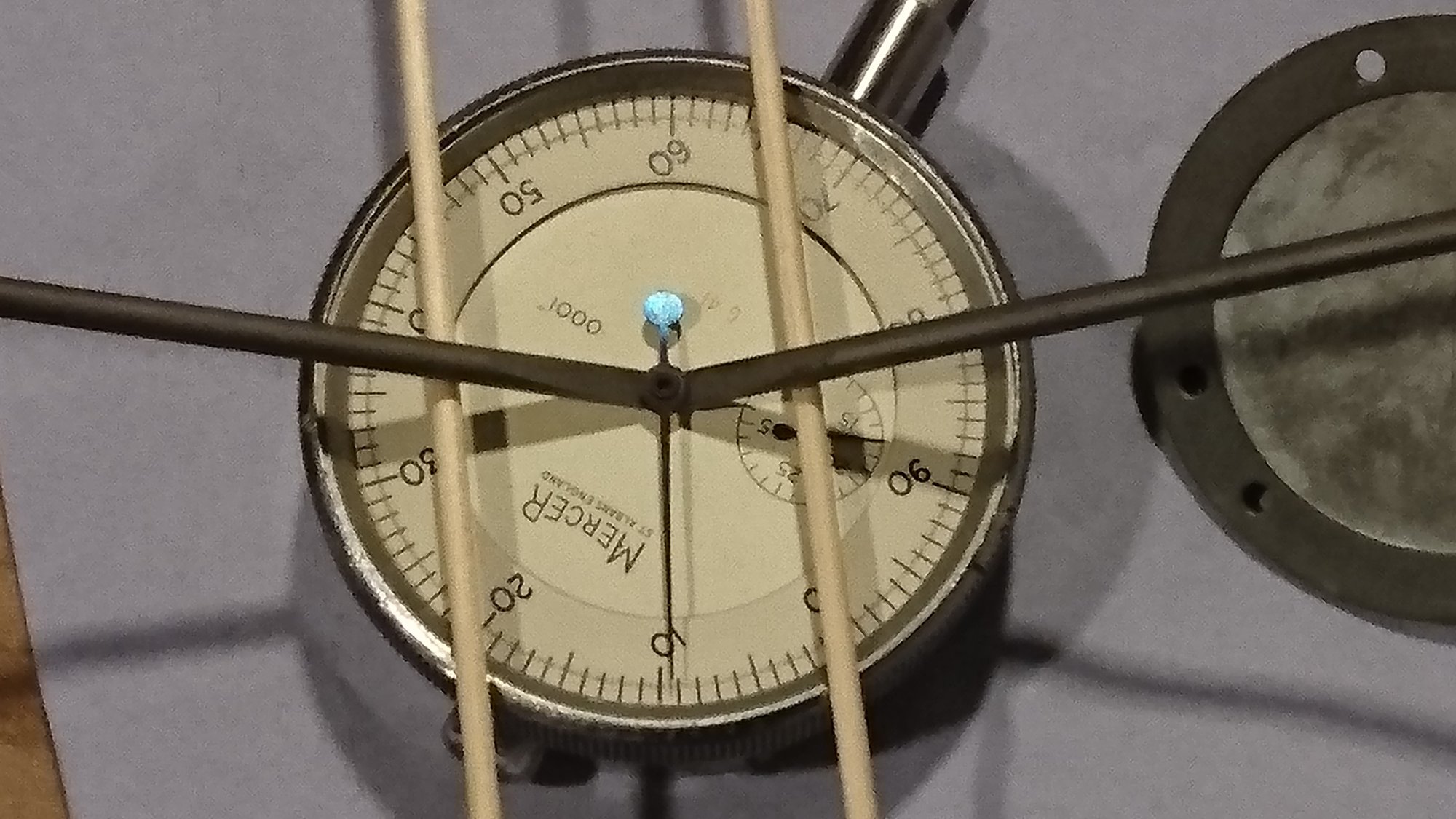

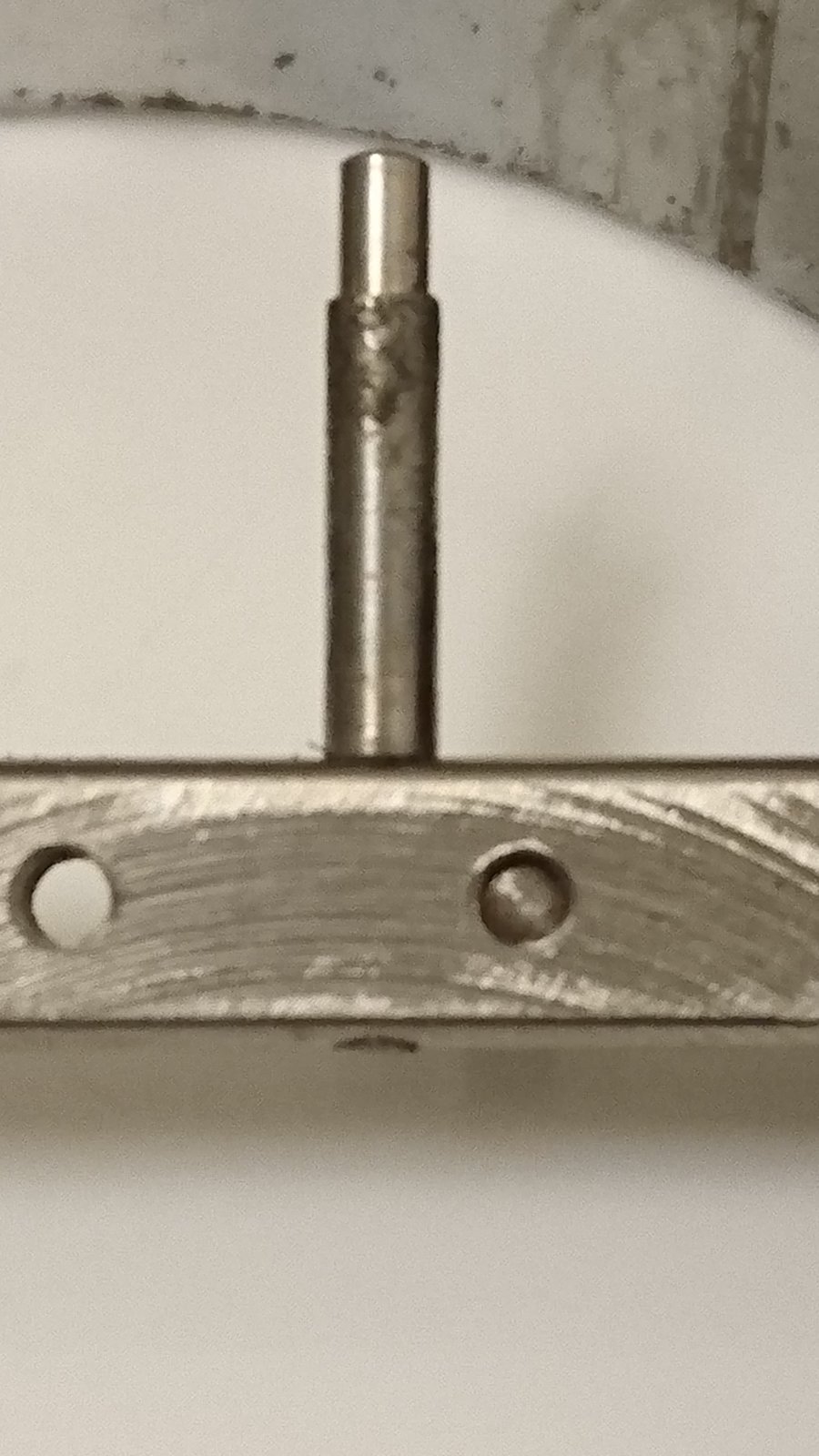

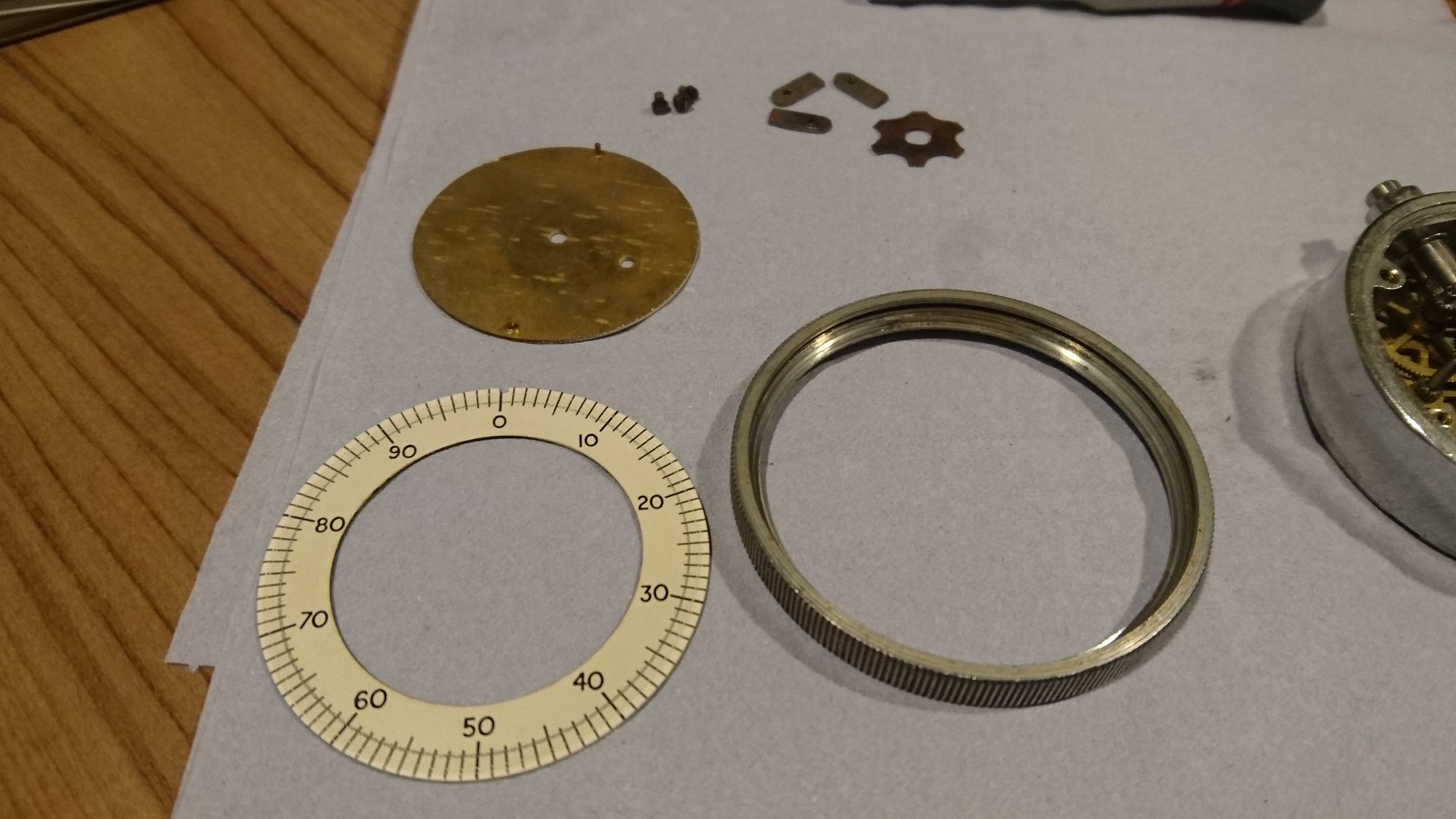

Hello all. I'm back at work again. Six weeks aboard ship doing 12 hour shifts. I have 12 hours off each day and I like to spend an hour of this pottering - sometimes reading or working something out for a project I have in mind.
I've decided to take my old 10ths indicator away with me this time:-
I bought this from eBay some time back but just haven't really had time to devote to refurbishing it. Of course I have watched all of Doubleboost's friend Bob's videos on the subject, and I'll be studying them closely throughout.

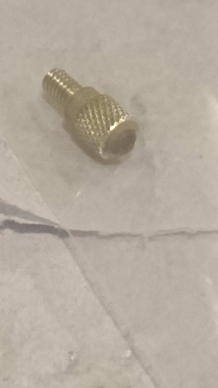

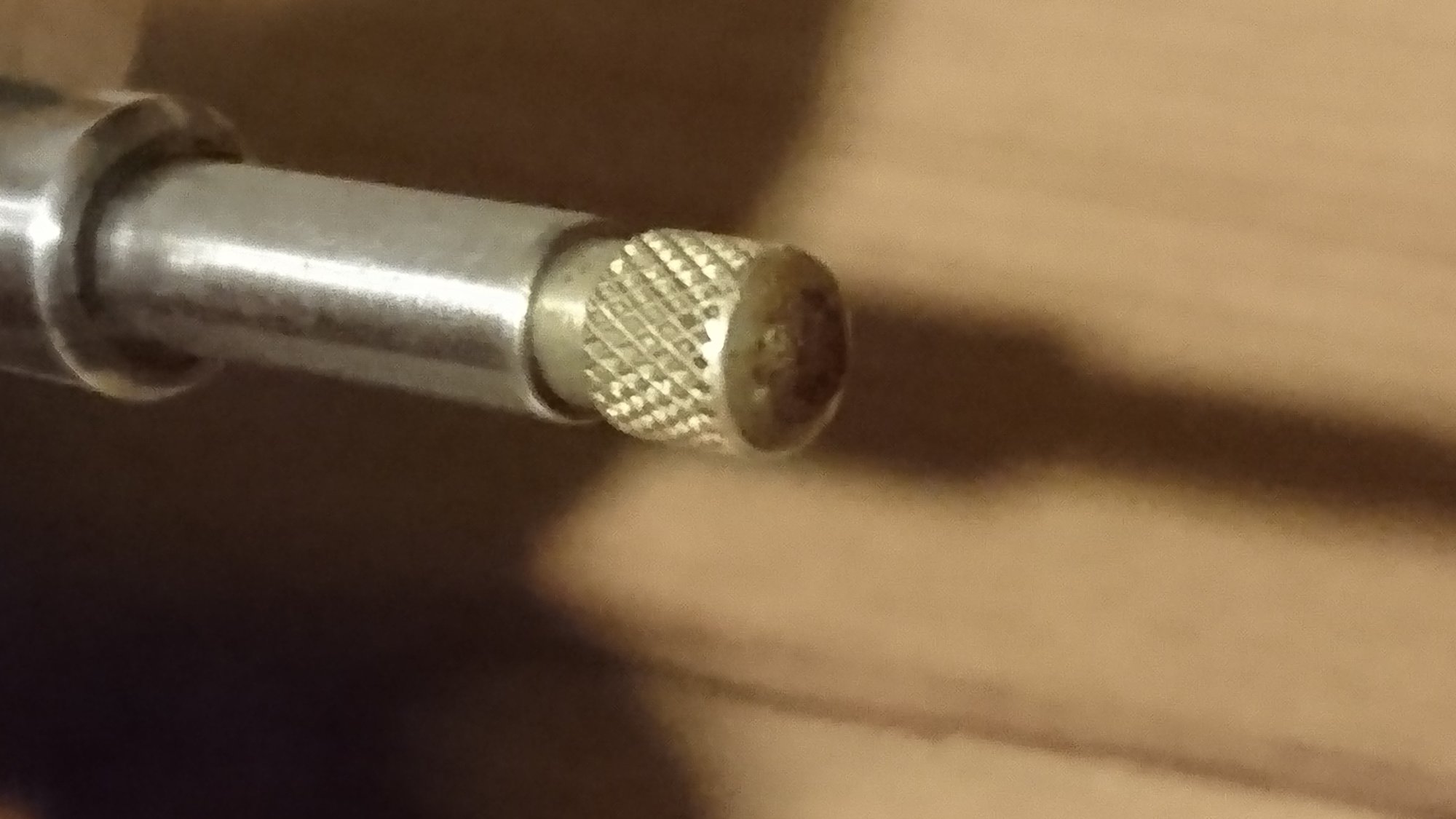

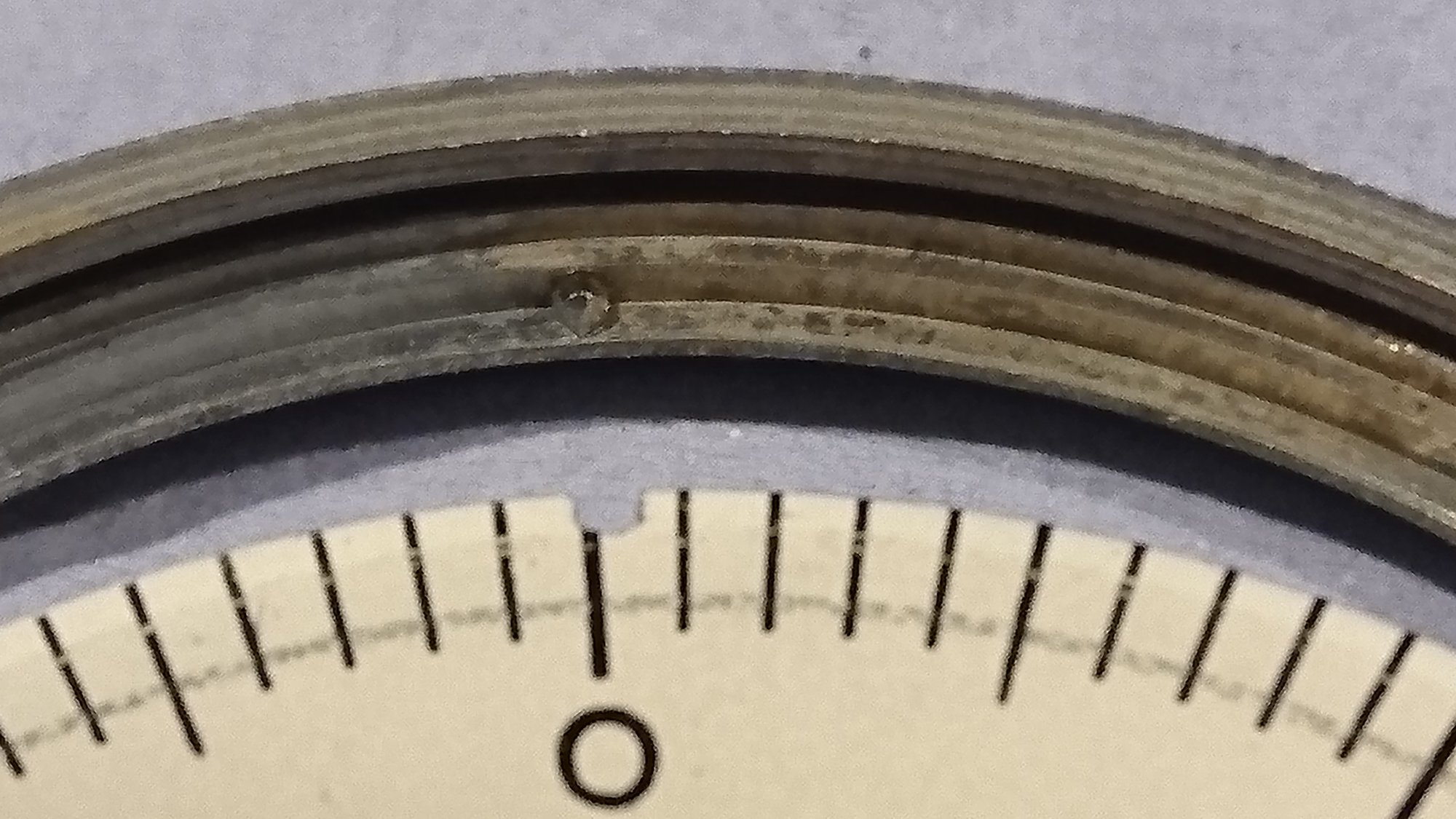

You can see from the above and following pictures that it does require some TLC. I think it has been thrown at the bottom of an old toolbox for years. There is some minor corrosion on the body and the plunger. Also the lens is scuffed,which I think might polish out. The contact point is also corroded and the ball end is seized. I think most of the exterior rust will come good with very fine scotchbrite and light oil or possibly a fine glass fibre brush.

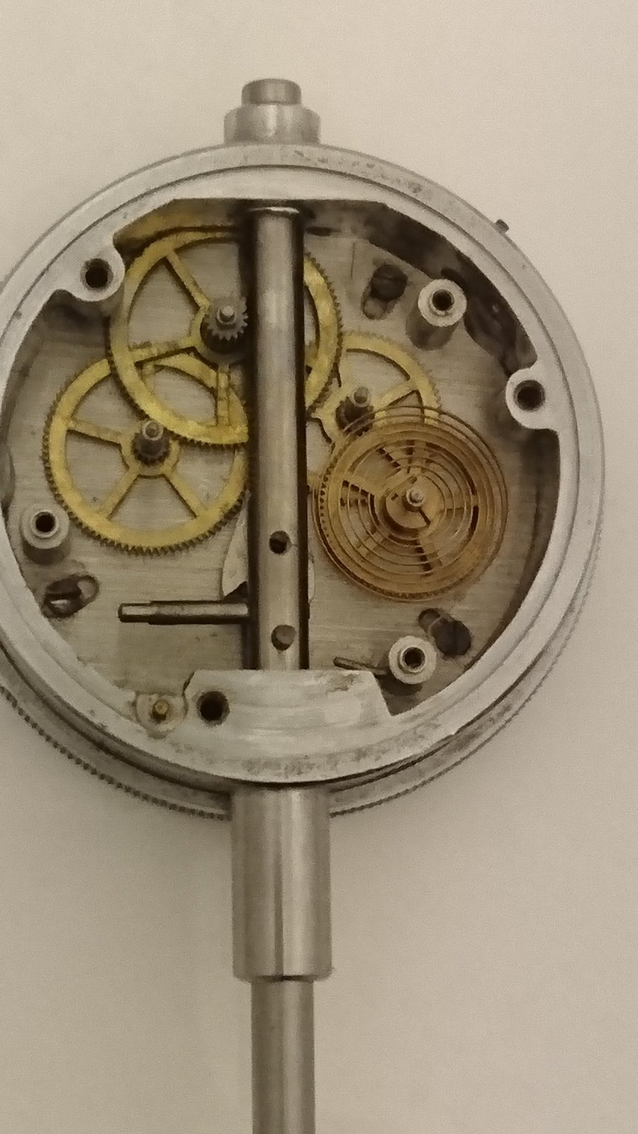

The clock seems to work well and both hands return fairly smartly. That said there is just the slightest suggestion of stickiness. I think that may be due to lack of lubrication and/or dust and dirt in the mechanism alloyed with the remnants of what lubricant there was.
Here are some more pictures.
In these pictures you can see the seized ball end and the missing keeper screw on the plunger. The bezel locking clamp and thumbscrew are present so no dirt has got in by that route. Hopefully.
As I say I'll be following Bob's knowledgeable videos with care as I proceed. Sorry about the bad shadow in the photos. I will try to get some better images when I start taking the unit apart.
