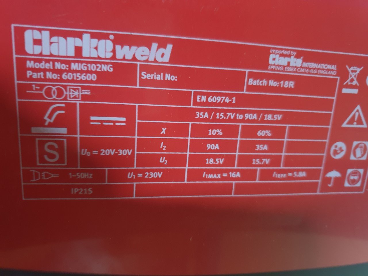

That's the data plate, it tells you the min/max currents and voltages, duty cycle, input requirements etc., there are no "settings" on it.
What is it you want to know about it as it will be a very basic machine with limited power settings, probably just 4.
