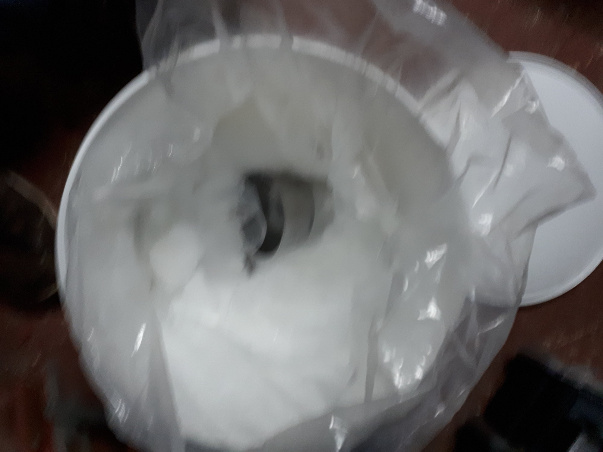

Ok I dont know how many of you have tried this but I thought i would post my experiences of doing it as I have found it to be very effective on even quite rusty items
so heres what you start with just comes in a bag think i buy 5kg from ebay is about £16

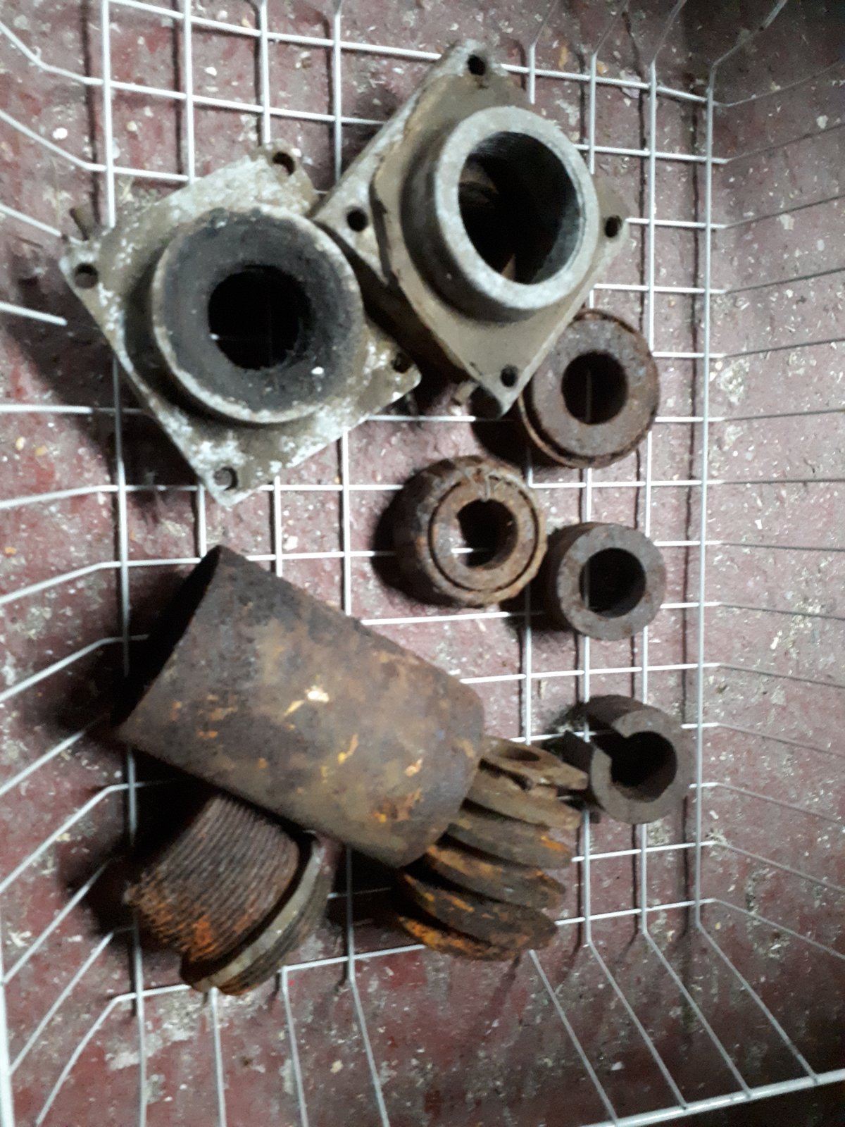

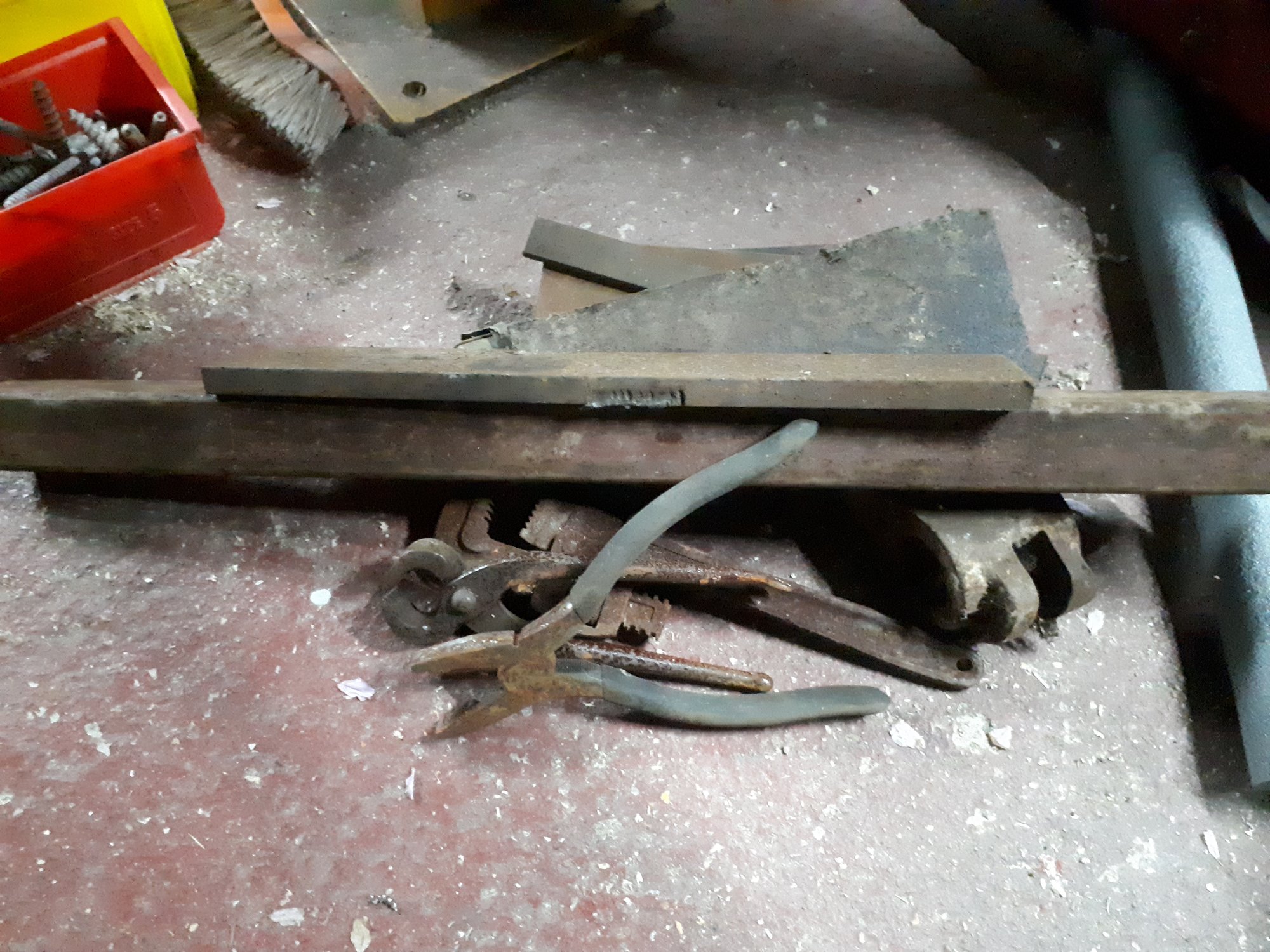

some rusty bits and bobs
yeah some ally but it seems to clean it too but i dont leave it in too long

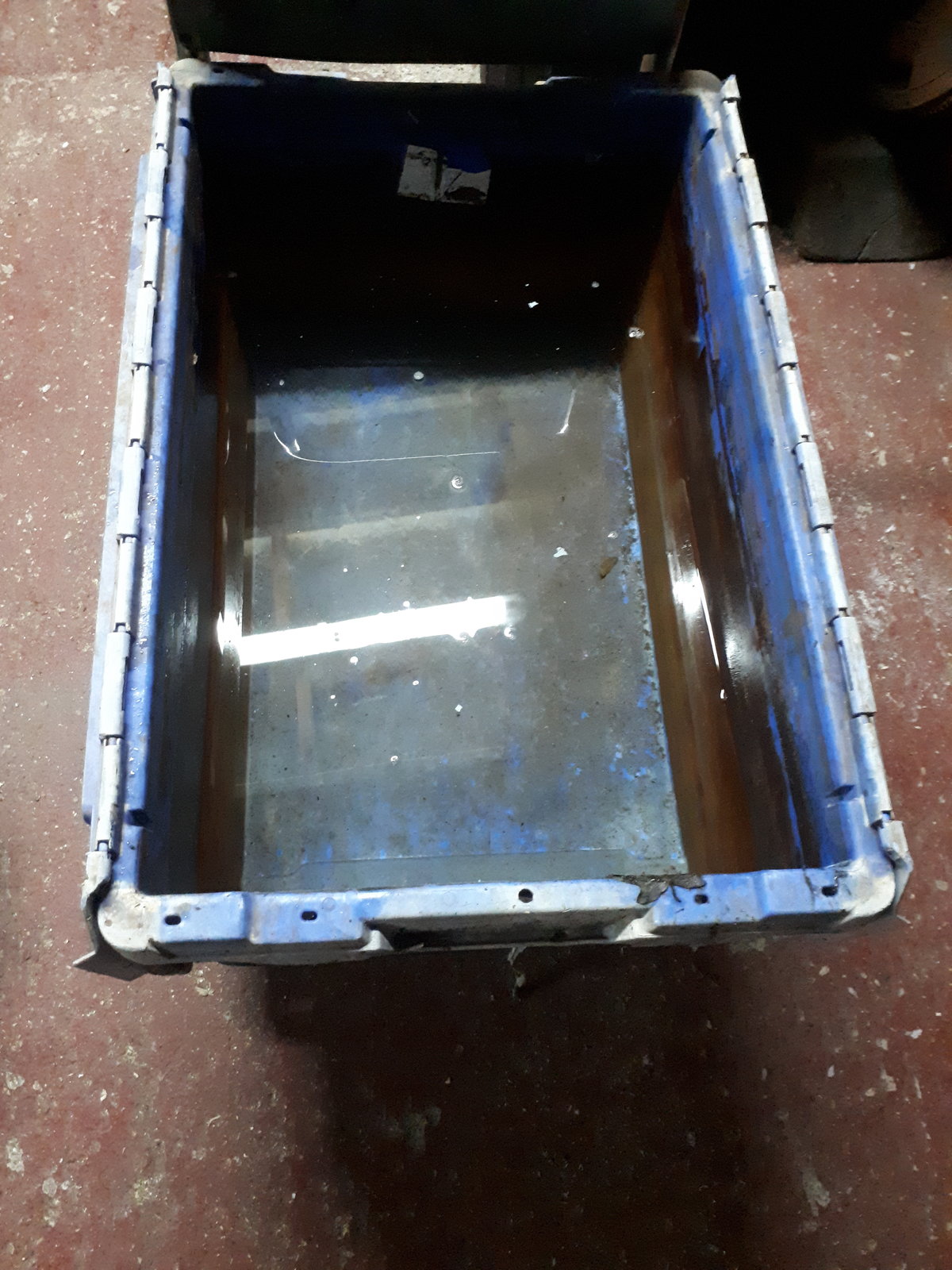

about a cup full goes in here chuck metal in and leave

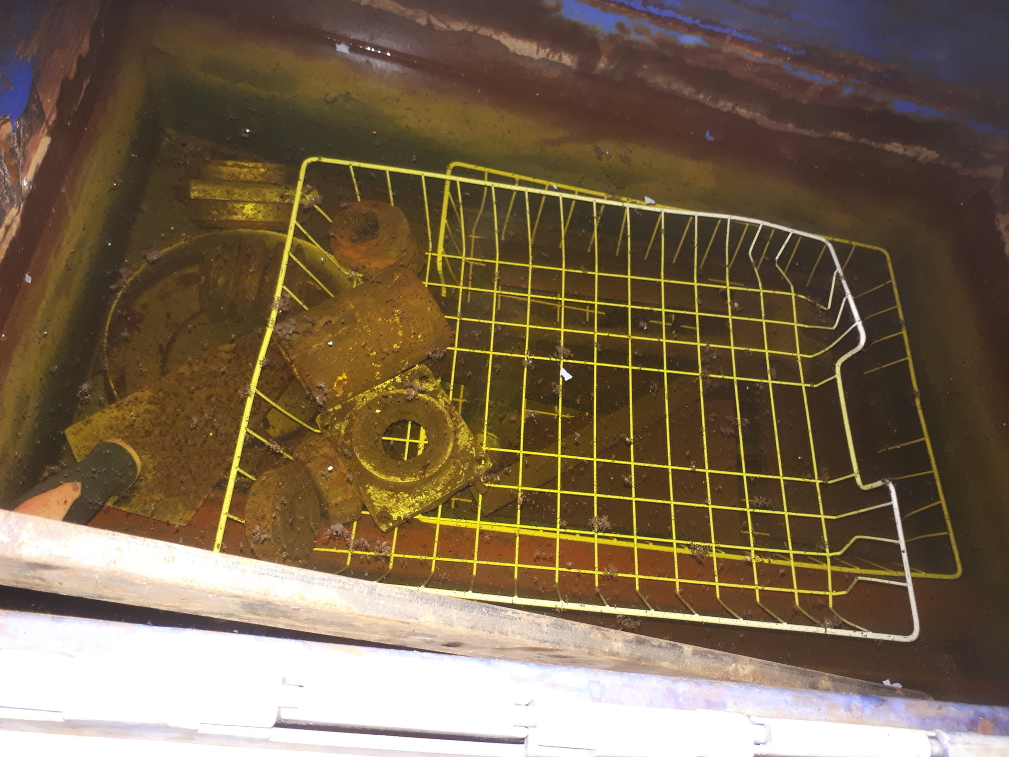

heres what it looks like after a day
water has already started to turn a rusty colour and you cant see in picture but there are bubbles rising from all the bits
gonna leave it a bit longer and report back
