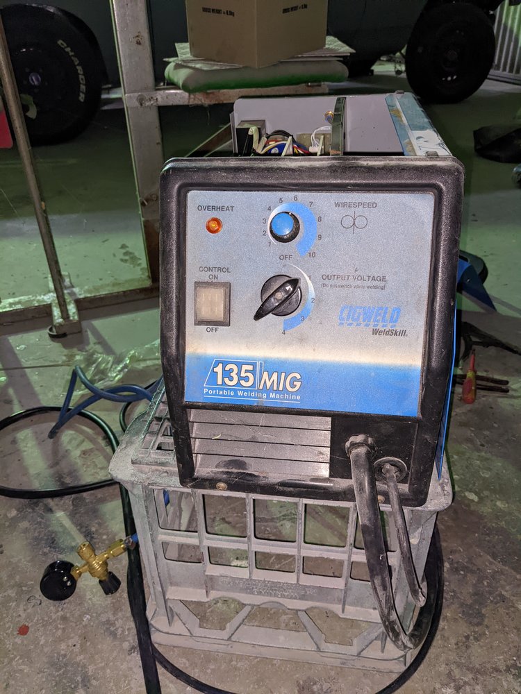

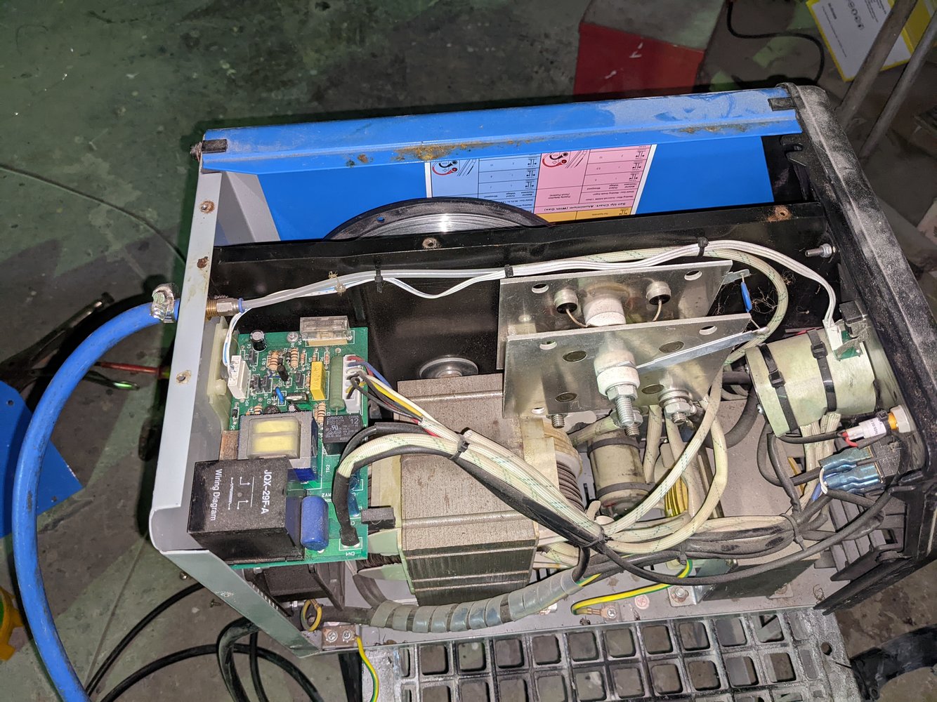

T turbo1600 New Member Messages 1 Location australia May 14, 2022 #1 bought a cigweld 135 weldskill mig , noticed that there is still gas coming out of hand peice without my finger on the trigger ,. took the cover off and i couldnt seem to find the gas solenoid. any one help ?

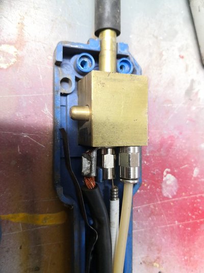

R Richiew Forum Supporter Messages 2,801 Location Teesside, England May 14, 2022 #2 If it is like the Clarke welders there is a brass valve inside the torch. They can stick open quite easily. Just dismantle the torch and have a look.

R Richiew Forum Supporter Messages 2,801 Location Teesside, England May 14, 2022 #3 Image nicked from another thread. Little bit of lube may stop it sticking.
